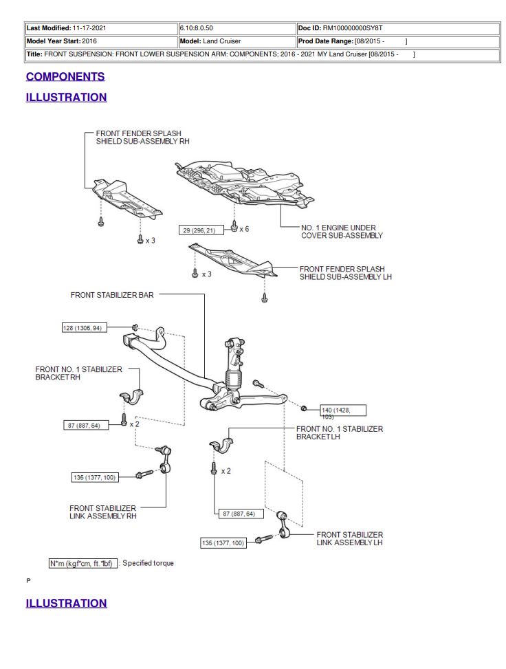

Can someone tell me the torque requirements for the steering stabilizer end links? Thanks
48820-60082 Stabilizer link
48810-60060 Stabilizer link
Thanks, I need to get me a FSM lol
it's for a 2016+ but most of the chassis stuff is the same.Thanks, I need to get me a FSM lol
