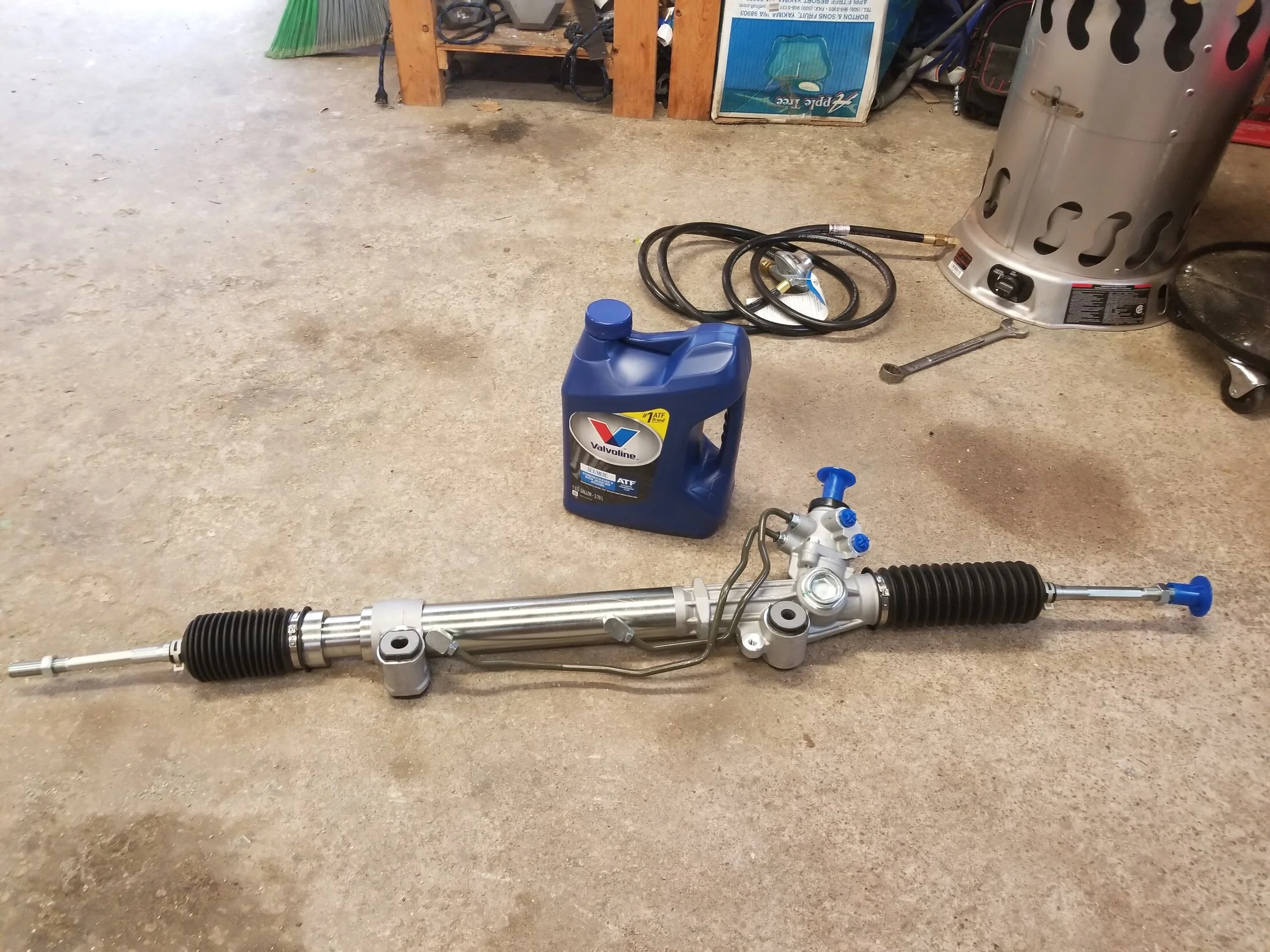

I put a Cardone reman rack in my GX470. It was less than $300 on RockAuto. OEM Toyota core, but cleaned up with new seals, bushings, bellows, and new tie rod ends. Looks like they are out of stock for a GX460 right now. It's been fine for the past 3 years. If you can wait I'd consider getting a reman rack when it's back in stock.
