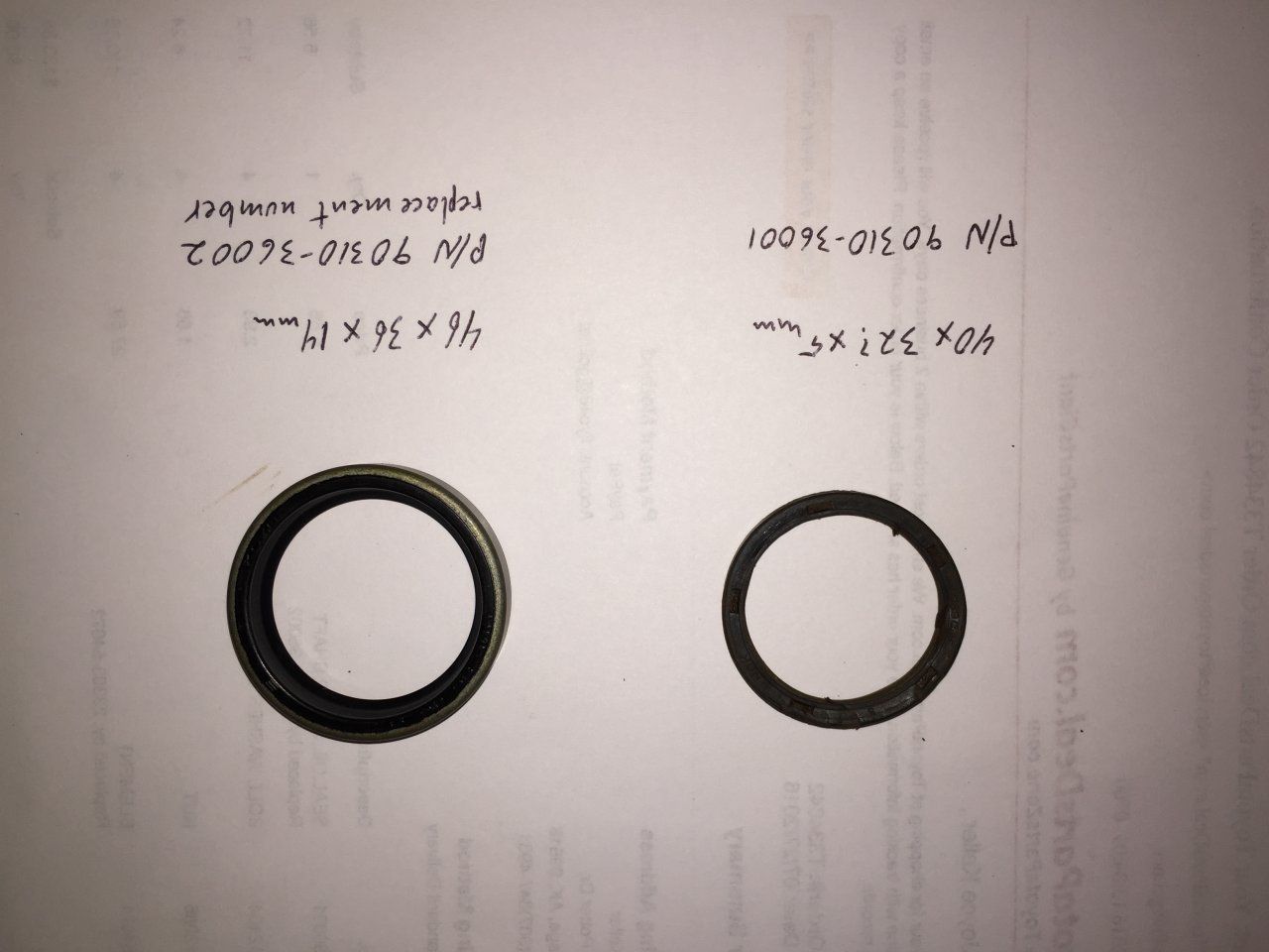

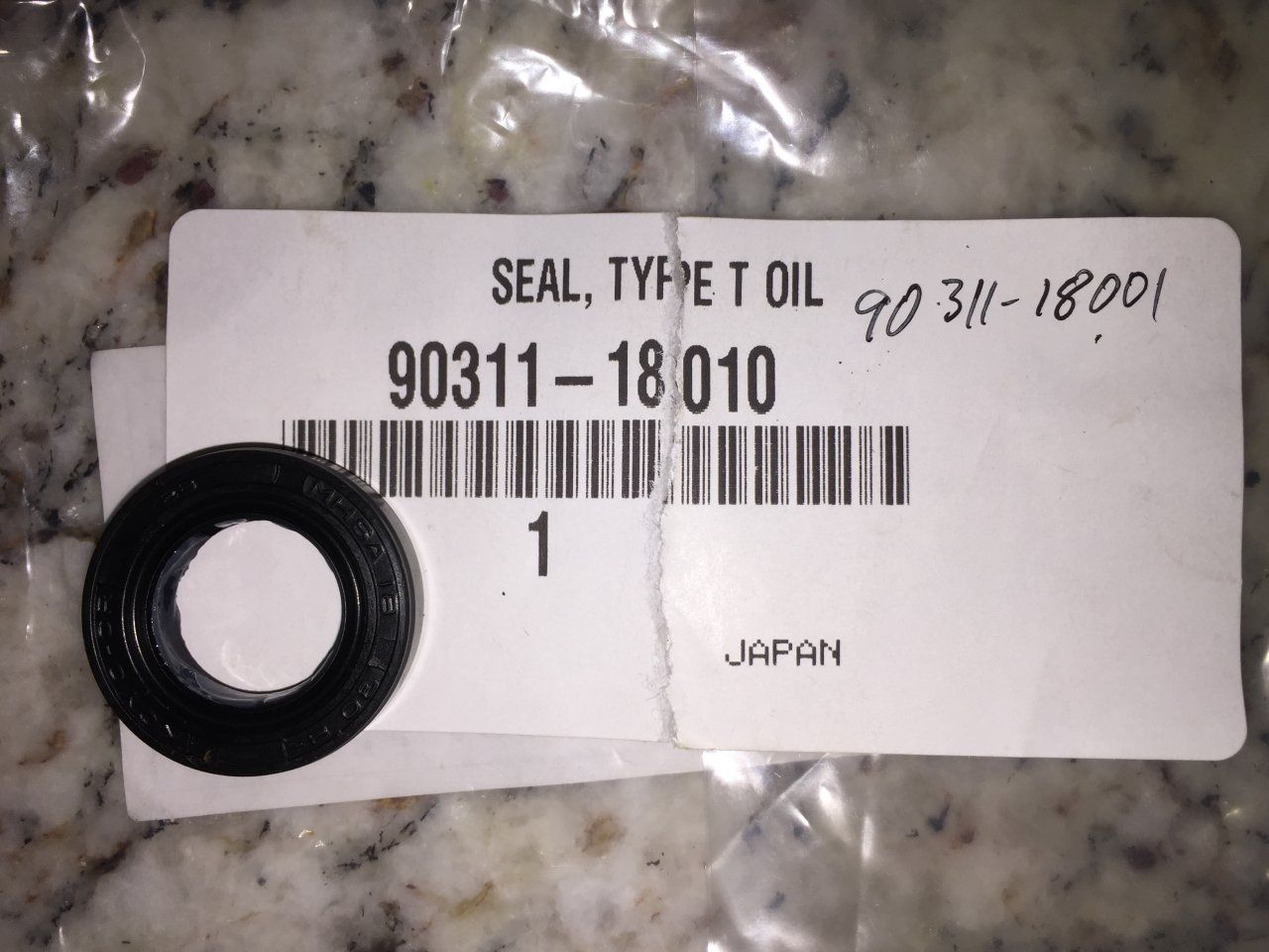

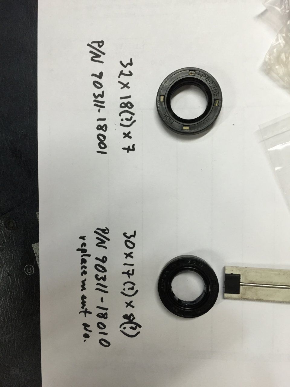

So, I ordered new seals using p/n from toyodiy.
As you can see by the first picture you can see the difference.
Just take the original seals down to a local bearing and seal supplier and they can match them up.... And also if possible the steering box so they can measure the shafts to confirm.... No need to get Toyota repackaged seals in this case.
