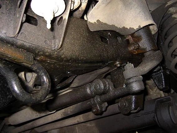

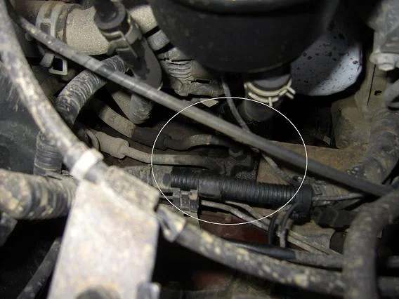

got some pics
attachment.php
attachment.php

I suggest that you go the car wash and blast the hell out of that area to clean it up. I would then monitor it carefully to acertain the origin of the leak, before tossing a bunch of cash at it.
But, I'm just a parts geek so consider the source.....:D
Oh,
Yer tow hook is on backwards................:rolleyes:
100 points for cruiserdan. When I was attaching it I said to myself "I wonder how long it's going to take these guys to tell me that my tow hook is on backwards." An hour and a half is pretty good. I'm going to clean it up tomorrow, I may not toss any money at it currently. It still works, and the truck is in far from pristine condition. I figure if there's anything that I can push my luck with, it's a LC.

it looks to me like your power steering hose is leaking from the top of the hose just like mine did. If it is not a trick of the light/camera, try releasing the clamp and repositioning the hose a little then tightening again. I agree with Dan about blasting that area out and seeing where it is coming from.
