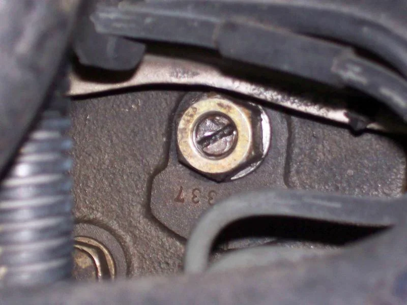

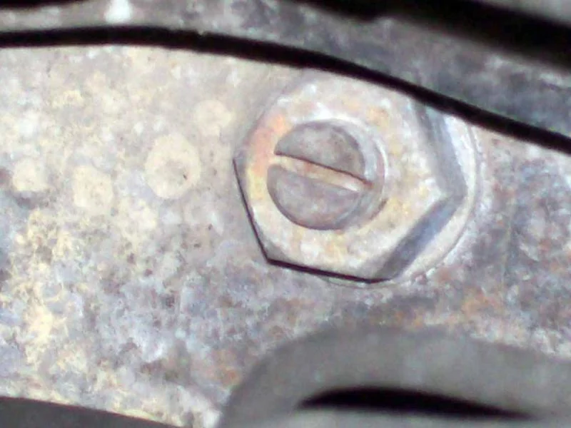

Does this screw controls how much the steering goes left or right (other than the steering stops)? This is the screw on top of the steering box. I'm having problems with one of my 80's; is the one with the screw adjusted flush with the nut (bottom picture).:bang:

Not sure exactly about this box but i know in the past on other trucks that screw set the backlash of the gears in the box, not the max steer
That adjusts the amount of end-play or "slop" in the steering or how much movement of the steering wheel without movement of the wheels left to right. I would leave this adjustment to someone that knows what they are doing. To tight and the steering box can be trashed. The 80 series is not a race car so live with some play,

The problem is not steering play, is that turns more to the right than to the left, 2.5 turns to the right, 1.5 turns to the left.:confused:

Yeah, I was also going to comment that that lower picture seems like the box has been replaced and the screw has been messed with using improper tools, etc.
