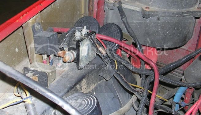

I'm in the process of putting a new harness in my resto/mod and hope someone can shed some light on this. The vehicle is a 76 40 that I have put a rebuilt SBC in . The PO had a SBC in it as well. Before the tear down and old SBC removal I took lots of pictures and notes. When I was wiring up the motor group this week I ran the IGN (purple wire) and BAT (red wire) to the 2 different small post on the starter and the battery cables to the applicable post on the starter and ALT bracket. To me seems straight forward. When I hooked the battery up the engine stated turning over....Keep in mind I have done nothing with the ignition group yet. So I went back and started looking and remembered that the PO had used a second solenoid mounted to the fender with the battery cables and BAT, IGN wiring. Looks similiar to a Ford set up... Below is a picture of the old set up. Does anybody know why this would be necessary on a SBC set up??? I'm also running EFI Edelbrock and a HEI distributor on the new setup. Thanks for any ideas:cheers:.

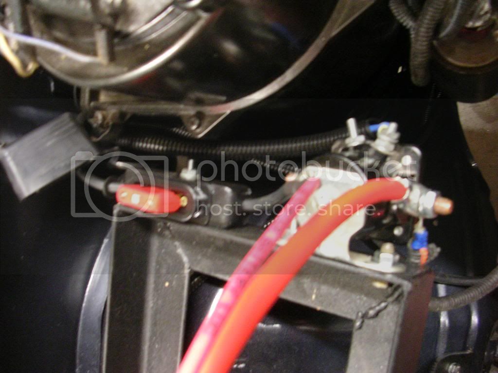

Thanks to all for the great input on this. Tonight I got the ignition hooked up and the solenoid issue resolved. I turned the key and the engine turned over for the 1st time in this vehicle. That was a good feeling since I have been working on this restomod for 2 years. After doing some research and going on what some of you said about heat I decided to go with the twin solenoids. Here is the final setup with the maxi fuse mounted next to the remote solenoid.

Did this mod yesterday and had the same issue with continuous turnover:mad: read this post re-wired and works like a champ.
