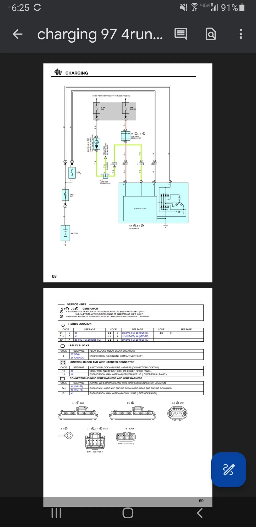

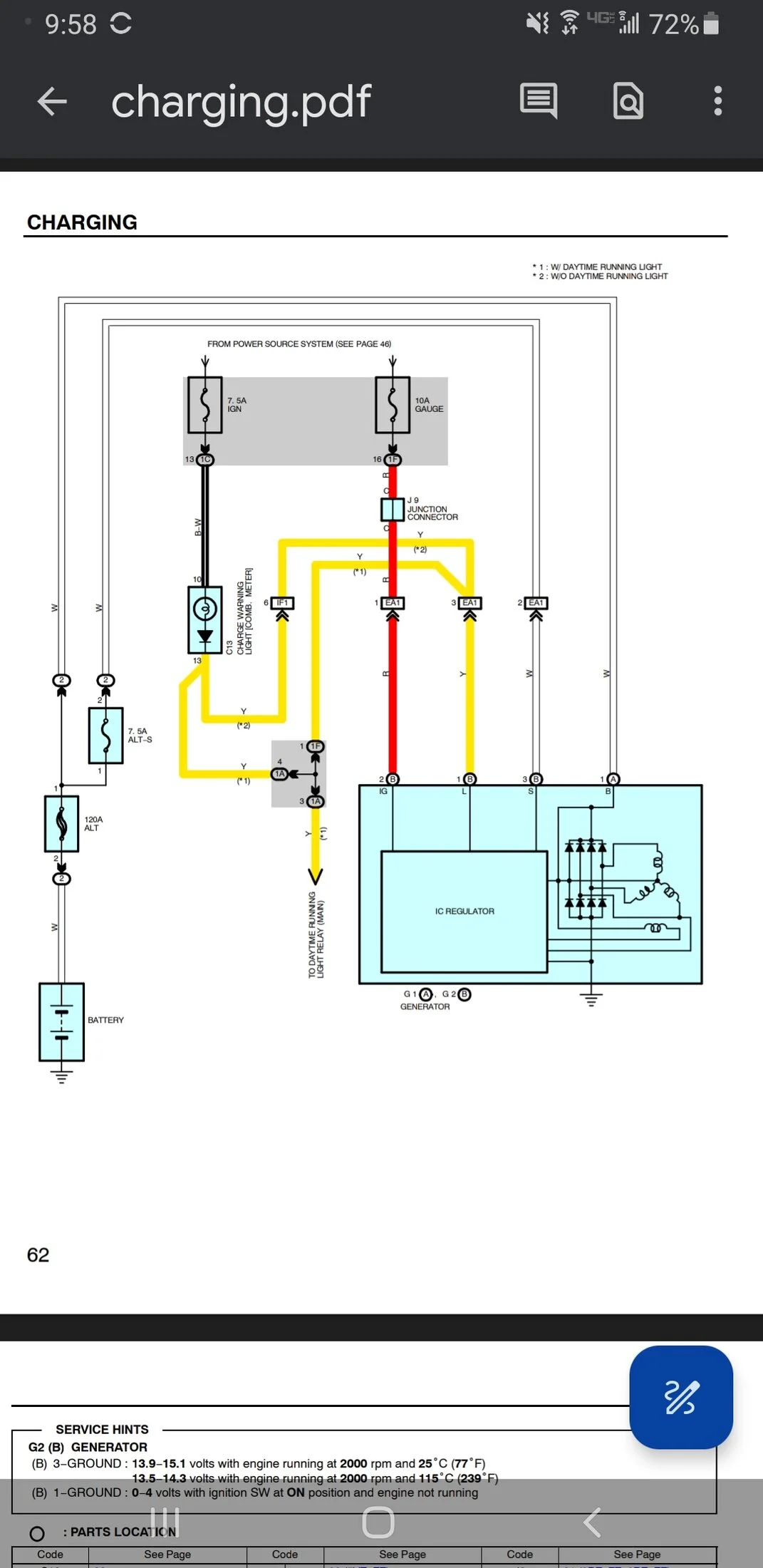

I just upgraded to the Big 7 and of course the starter has now gone out after 10 months. I decided to eliminate all possibilities of what could cause the issue. I have upgraded the alternator to the HO and am working on rewiring the whole harness for the alternator and starter. I was a big idiot and did not take photos of the wire from the alternator to the base of the fuse block plug before disassembly. Would someone be willing to either look to see what color the wires are and attach a photo or find the wiring diagram on which wire goes to which port? It is for a 99 with the 3.4L. Thank you for all the help!!!
this is taco, but the main wire should still be white. it should have been in tbe four wire plug attached to the fuse box.
