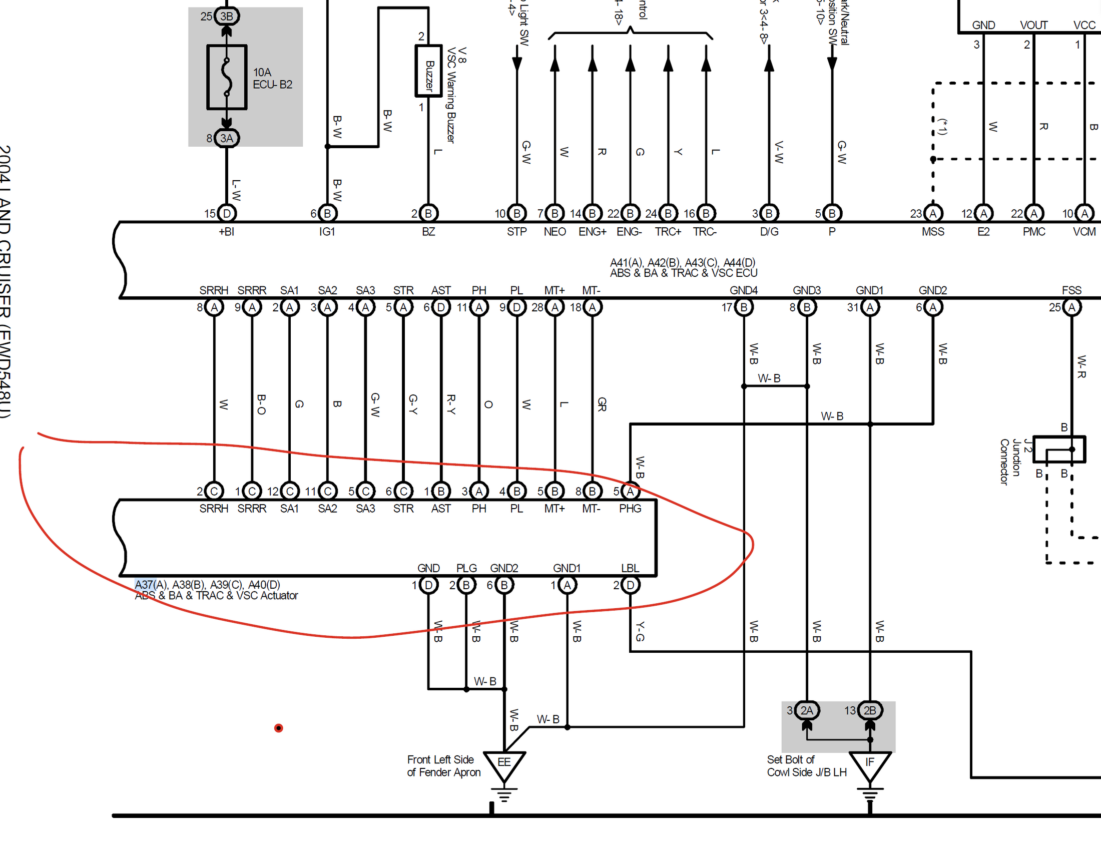

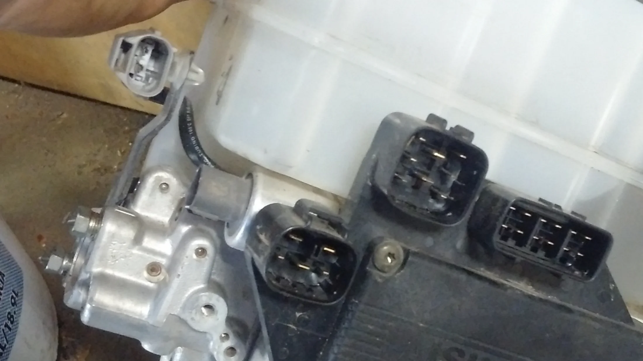

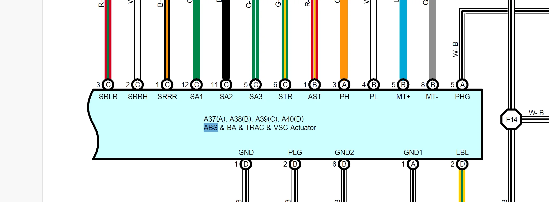

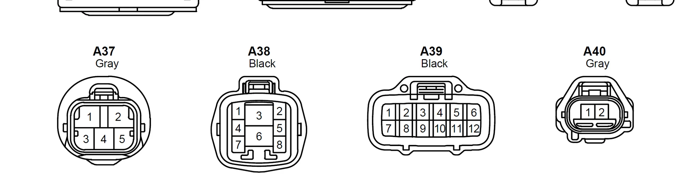

Hey everyone, a squirrel decided to make a nest in my 2005 LX470, and in the process, it chewed through a bunch of my wiring. I’ve managed to fix most of it, with the exception of the ABS wiring. Some of that wiring has been chewed so close to the plugs that I can’t match the wire color anymore.
I was wondering if anyone could take some detailed photos of the three connectors that plug into the ABS module that sits alongside the brake fluid reservoir on a 2003-2007. Or, even better, if someone has these plugs off a parts vehicle they’d be willing to sell, that would be amazing!

3 black and one grey connector?
Another member recently went through this. Here's the thread with a bunch of info/ pics of the connectors,
Thanks for the info guys! I will go through it as it looks very helpful. jerryb, the two top connectors on my ABS module are black and all the rest are grey.
