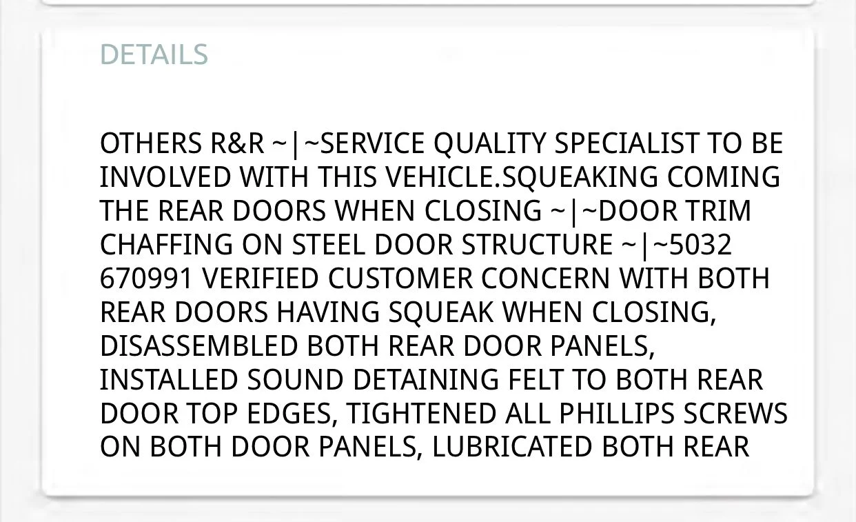

2019 LC. I have a high pitch squeaky noise when shutting close the rear door. It happens about every other time that the door is closed pretty hard.
It has been at the dealer 3 times and they have concluded that the door trim is chaffing on the steel door structure. They tighten screws and applied a lot of felt. The issue keeps coming back after 3k-4K miles.
Is the felt a workaround or a good solution?
I am assuming that there is a part in there that is not correct. I am not familiar with the door/trim structure
I have checked the doors of other LCs and there was no issues.
