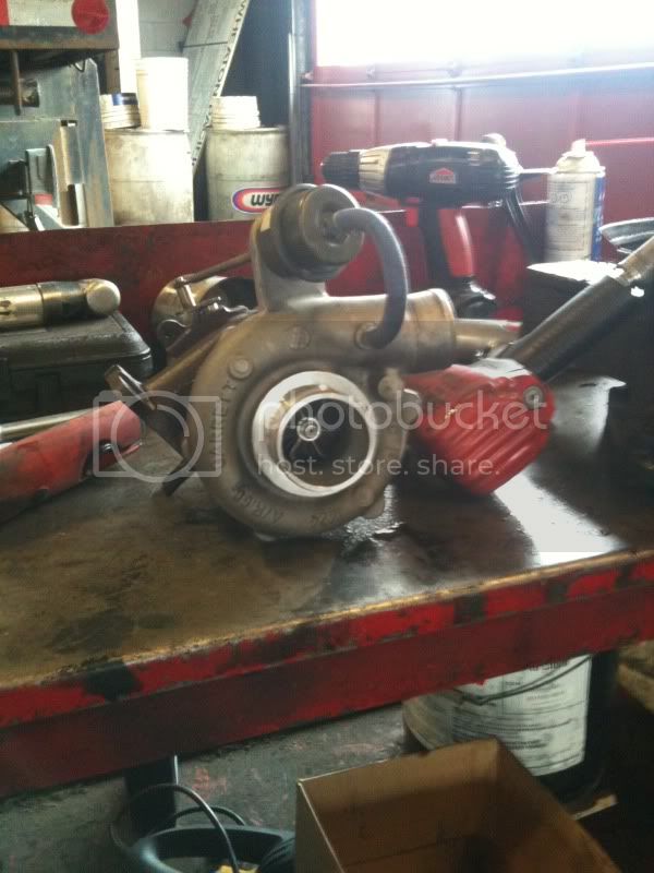

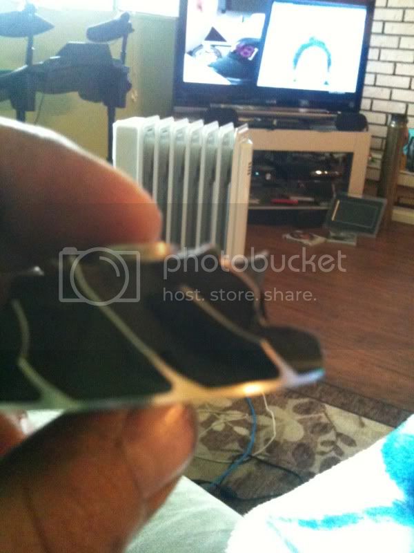

Showed up to work today to find a present on my bench. Looks like the saturday guy did a turbo no core on it so its all mine! low km's needs a intake side impeller it swallowed something it couldn't pass. Turbos still good truck was making boost when it came in. no bent shaft minimal side play no end play housings happy just needs a compressor wheel any ideas where i can get one? Turbo is off a 05 GMC W4500 (5.2L Isuzu 4cyl) I think this will fit nicely on my 3B
pics to come of the impeller

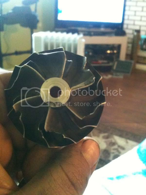

anyways heres my issue. called a turbo parts distributor got a wheel comin for 115 bucks not terrible at all
was only minor damage but i thundered it tryin to get it off

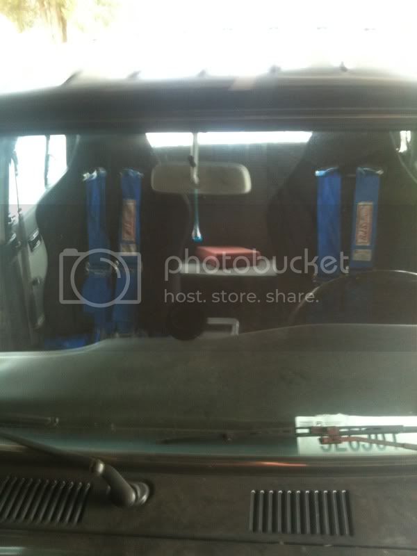

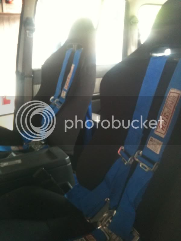

Whew been a while since a update, well life's been busy the last little while so not much has gotten done except parts gathering. But due to my recent lay off i seem to have alot more time on my hands and i need this thing done for may long. Today i fixed my broken pair of seats given to me by one of the inlaws from there civic. was scratching my head on how i was going to bolt these things in then noticed the tracks bolted to the seat basically the same so swapped over the tracks and good to go.
Freebie
I dont think i will be needing the harnesses initially the cruisers not gonna be that hard to the core but they were also a freebie and i thought i would throw them in for camera whoring

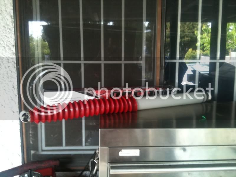

14" travel rancho 5000's hopefully not too long

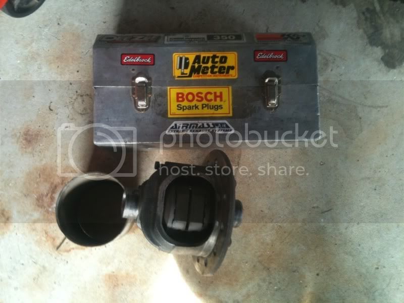

PowerTrax Lunchbox locker and errr lunchbox
