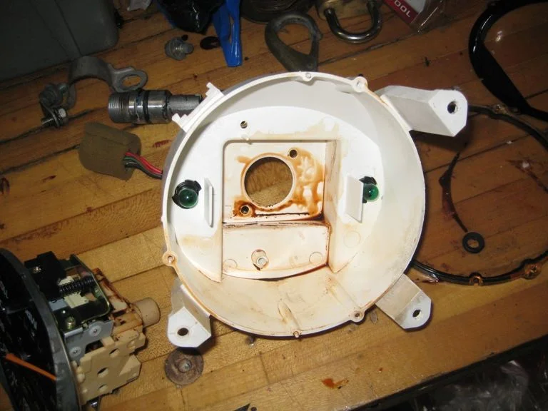

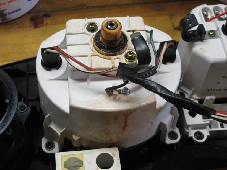

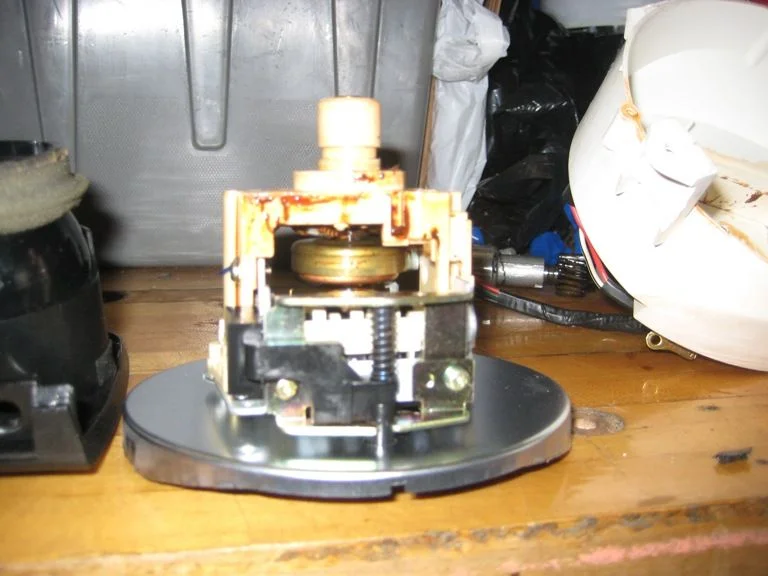

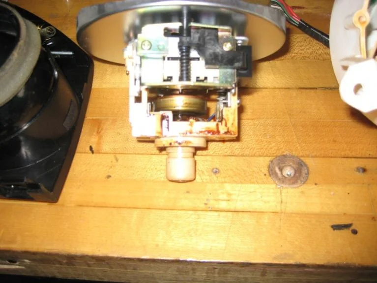

This seems odd to me, this reddish fluid in the speedometer cable and speedo casing, what is it and does it belong here? :confused:
I checked the other end of the cable, where it goes into the transfer case and it seems fine, no red fluid on the cable or in the transfer case.
Would this affect the speed sensor at all?
The good news is your speedo is well lubed. The bad new is either you are leaking ATF into the t-case or someone filled up you t-case with ATF. The speedo drive is pumping oil up the cable. Pull the fill plug on t-case to check for over full condition. If oil pours out you have a seal problem.
