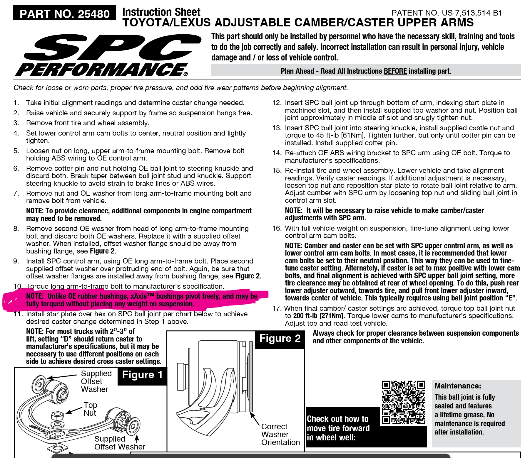

Didn't know they did that. That applies to those and something I would never run then. Not being familiar with that particular brand, that's a feature that scares me. That also goes back to what I originally said about differences in compound then.
That brand did something diffrent and if they don't hold up then its another failed suspension design to add onto that many poorly engineered ones. What's unfortunate is how many "Off-Road" suspensions are actually more "street" suspensions.
Agree with all that. What really struck me was that I talked to them on the phone every time and described my install and symptoms and sent the damaged bushings back to them each time, but they seemed or claimed to not have any idea what could have happened and suggested that "I must have gotten a bad batch". For one customer to get bushings from a bad batch 3 separate times made me lose confidence in the engineering. Thanks for chiming in and adding to the discussion. I was really curious to see if I would find other people who have had the same issue, but have not heard much on that front.
