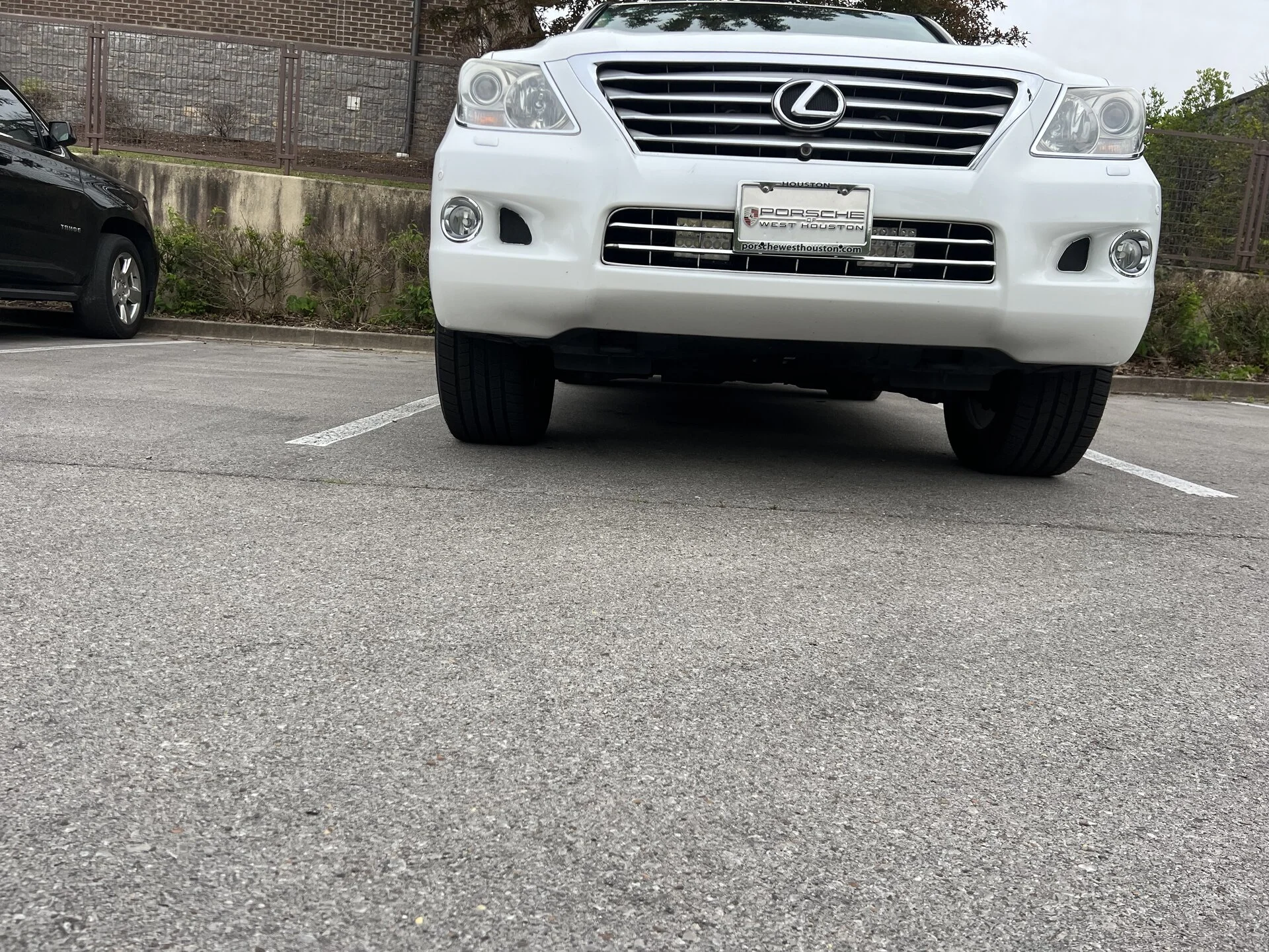

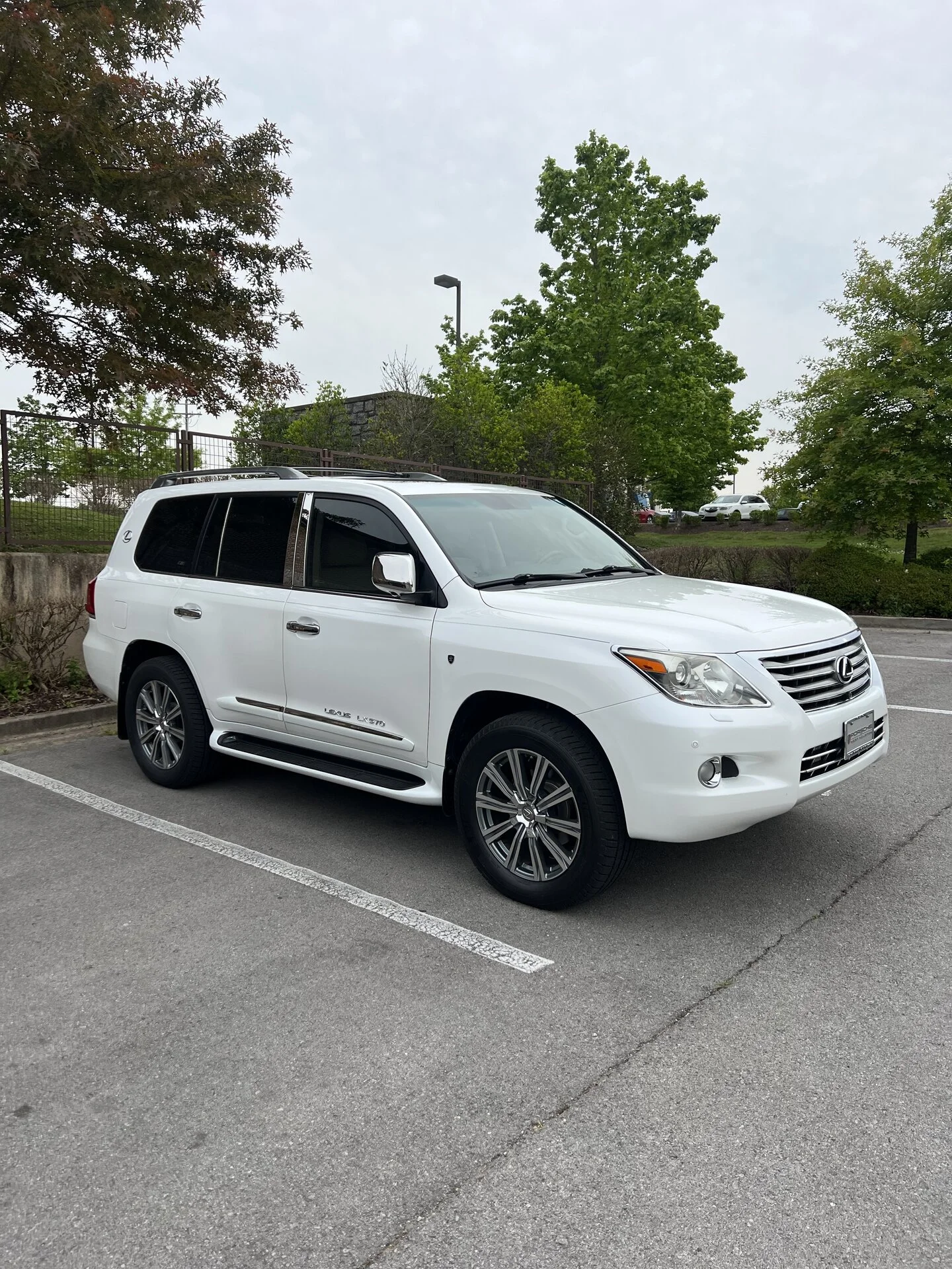

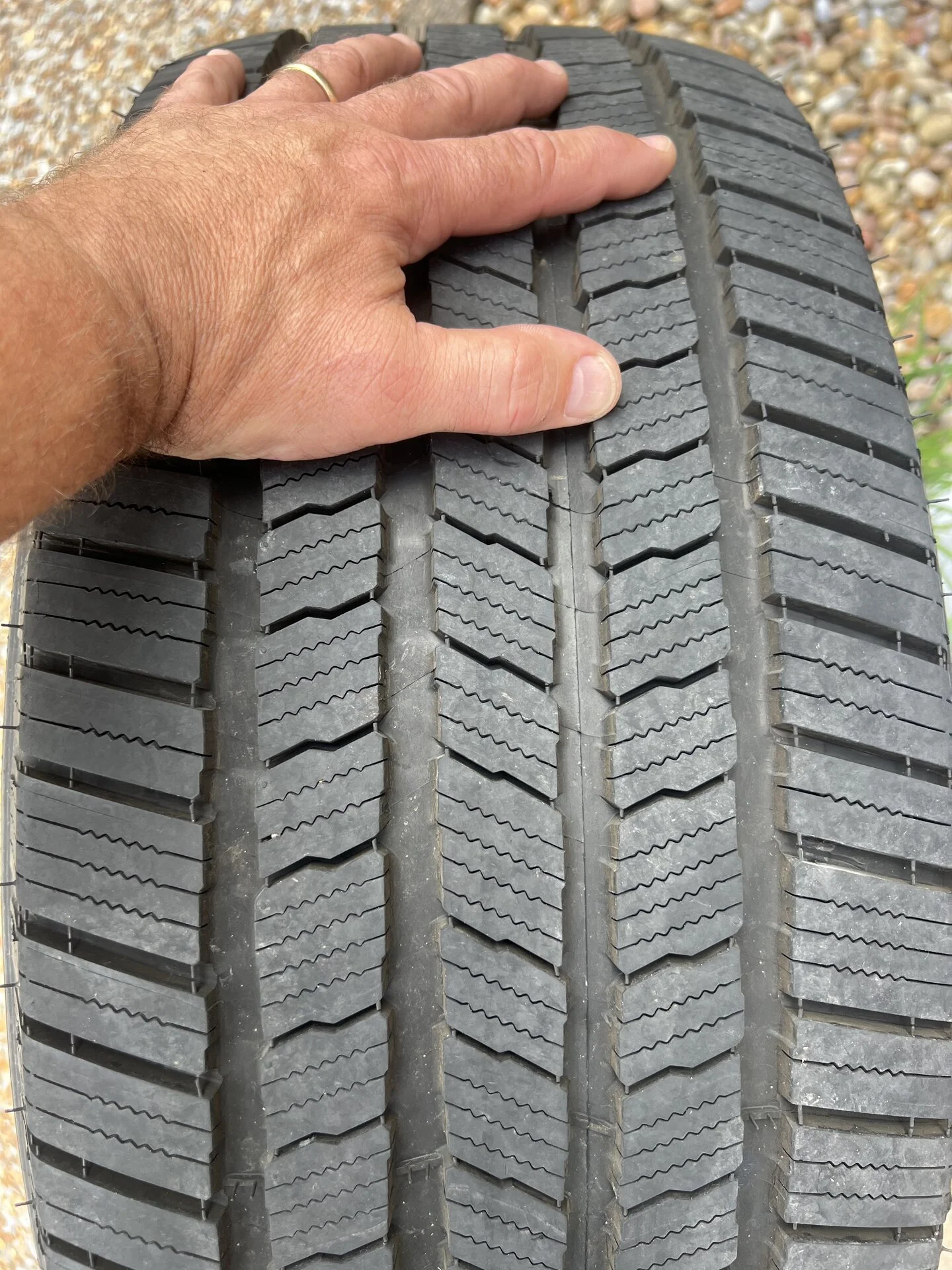

Sorry to resurrect an old thread but I got another year of life out of my “old” tires.
I recently did in fact purchase a new set of Michelin Defenders in 305/50R20 size and I Love Them! They provide a very nice ride quality and performance and I love the way they look.
I know my ride is more of a mall cruiser but these tires give it just a hint of capable off-road prowess.
I added .75” Bora wheel spacers as well.
I think the overall look is clean but at the same time purposeful.
Thanks for letting me share.
Blessings, Brian

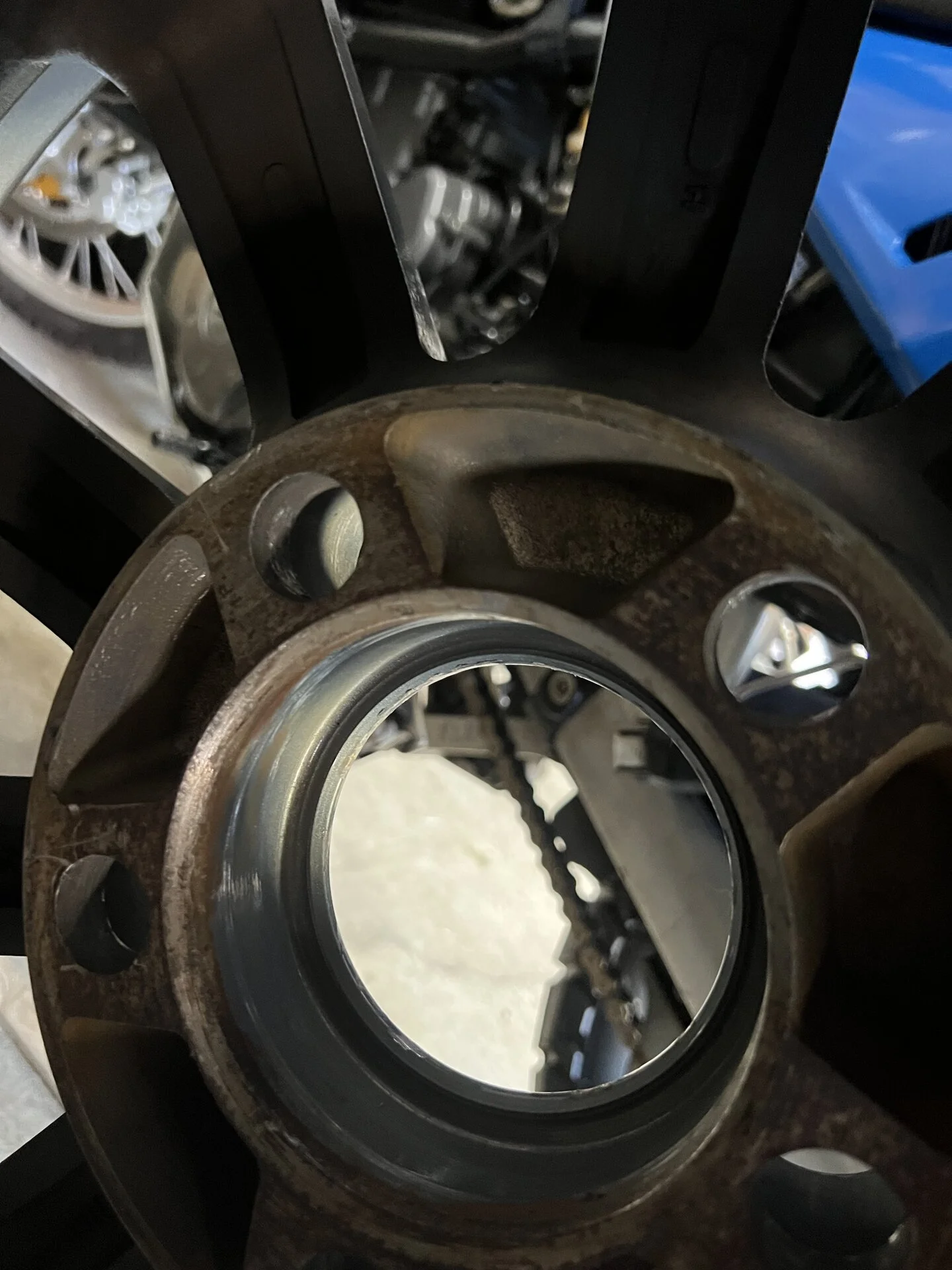

You may want to pull a tire and check if the modification was made…if a pocket wasn’t drilled or the studs weren’t trimmed, then the wheel likely isn’t “flush” against the spacer and, instead, is merely torqued up against the exposed studs…which may, over time, “Waller” out and become loose, potentially leading to the same type of catastrophic wheel from car separation that can occur when people improperly install non hubcentric spacers.
Great Advice. Thank You.
I knew I didn’t have the studs resting against the inside of the wheel because I’m the type of guy that checks, rechecks and checks again to make sure a diy type project is performed properly.

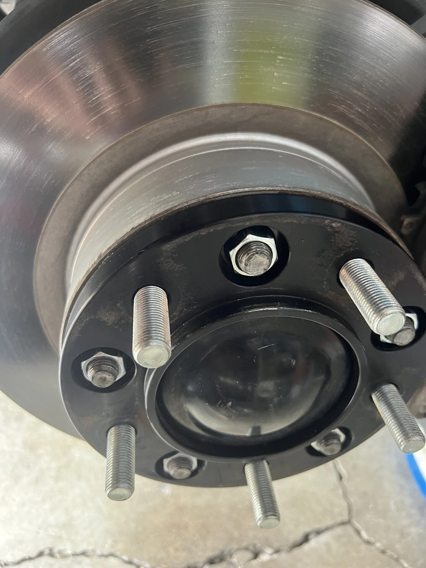

I embarrassed myself by not remembering exactly what I did so
after church today, I took off two of my wheels (both on the driver’s side).
As you can see by the pics, my wheels have more than enough clearance to accommodate the wheel studs. Looking at the studs themselves, I cannot remember if I replaced all of them with shorter studs or if these are the OEM studs that came on the vehicle. I do however remember being very methodical on attaching the hubs.
I torque spec everything that I can when working on anything but especially on vehicles due to the possible safety issues that can arise from tightening something “good enough” vs OEM torque spec.
When I installed the spacers, I do remember triple checking their fastener torque spec, installing my wheels, driving it several miles (50 miles?) and then taking off my wheels and torquing them to spec yet again. I did this procedure at least once and maybe up to three times (again, I didn’t document my procedure so I’m going off memory).
