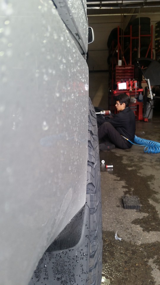

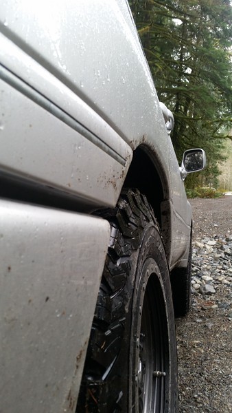

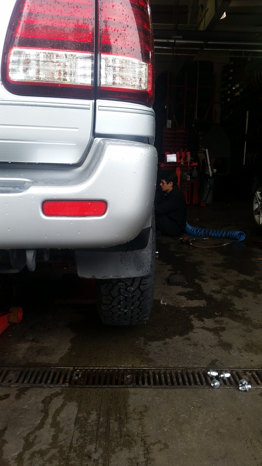

This is a picture of +20 offset with a 275/70/18. Should be close to the same look.
Not the best angles but I would call the fitment flush. If you are looking to poke out further you will need to run an aftermarket wheel in the offset +25 or lower to get that look. On stock height under full compression with more aggressive than you suggested you will likely have issues.
