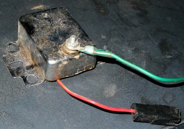

Wow, what a flashback, that is my post from years ago. After switching to the regulator I mentioned, I never had another problem. I pulled it out just a week or so ago when I started my V8 conversion. I just checked the date of the post, it ran for 7 years without a problem.
Also, let me apologize for the 404 errors from a couple years. :-) I have changed a lot of things on my website.
Here is a picture of the regulator from my post. This is the same one I installed when I wrote the post, and just pulled last week.

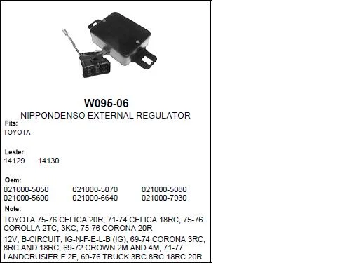

Anyone have any information on what regulator would work for a BJ-45 (3b, 12v)? I looked through the wagner catalog but they only had for the F models.
If it is a 6-wire regulator with a rectangular connector (as opposed to a "round" connector) then use either of the following:
Transpo IN551 (available in the USA)
or
OEX RGX2032 (available from Repco in Australia or NZ)
Both of these are solid-state and "simple plug-and-play replacements".
I am not aware of any of the old-school electro-mechanical units being sold nowadays for this application.
:beer:
It's not one of the ones in http://www.wagneralt.com/catalog/books/W2008-09.pdf, on page 23/46? There are a couple there with 6-wire rectangular connectors.
Thankyou Chris.
I've never looked at Wagner products before but you are right!
The Wagner W095-06 is also suitable for Jaymundy's application I believe.
:beer:
Edit: Interestingly - The transpos IN551 crossreferences to the Wagner W095-02 and not the W095-06! (But I still think the 06 is the safer bet.)
However I suspect that Transpo IN558 and Wagner W095-02 are alternatives that would do the job! In fact I've wasted so much tome this morning looking at stuff that I could give you hundreds of crossreferenced alternatives ...(including NAPA numbers that seem to be favoured in the states ie NAPA VR528 and NAPA VR529).

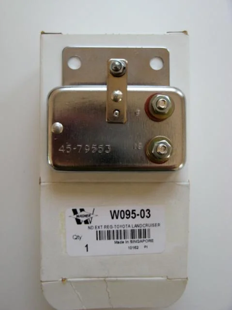

I sent a note to Wagner, asking for details about the W095-04, thinking that I would be able to mount it up where my mechanical unit is and change out the connector.
The president (!) sent me a reply, and informed me that the photo of the W095-03 is wrong - they are now shipping a solid-state version! So I ordered one up. It will be a few weeks before I can get to my FJ40 to do the install, but I'll give you a photo now. I'm quite excited ;)
