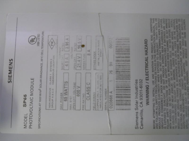

George, thanks for the reply. Yes, I plan on a parallel system.Here is a picture of the back of the panel.
I plan on using these for off grid camping occasionally and only running a couple to 4-60 watt lights, a cell phone charger, and possibly a small fridge. Camping trips lasting maybe two--three nights max.
Ok, so a siemens panel, some info here http://abcsolar.com/pdf/sp65.pdf
Note that the Vmpp and Impp mean Voltage at maximum power and Current at maximum power.
So, that 65W happens at Vmpp which is 16.5V, i.e. you'll get less power at the 12 - 14.4V range of a typical lead acid. Not horribly worse, but certainly less than 65W. That 65W is also with nominal 1000W/m^2 or a somewhat "ideal" sun. Depending on latitude/haze in the air etc etc, you'll get less again.
