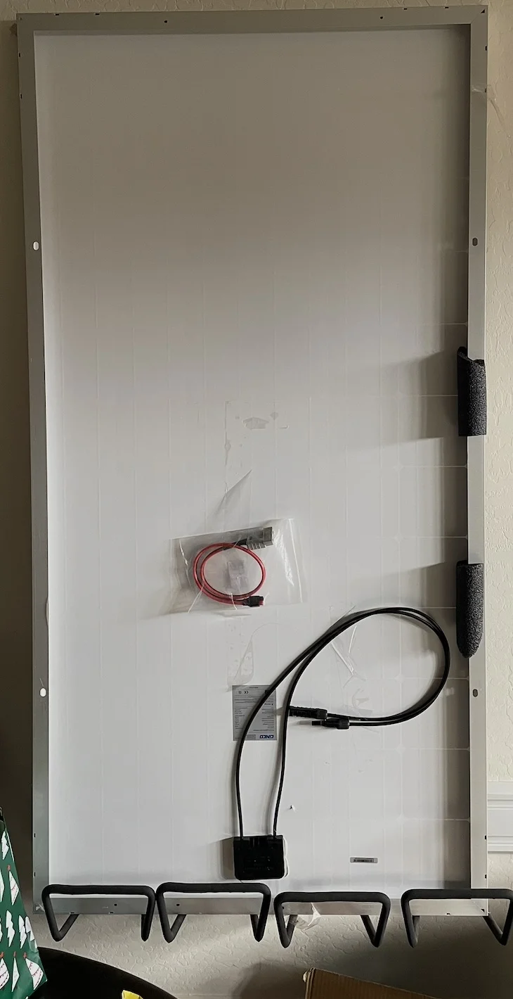

I have a briefcase style RedArc 190W, its great, but Im not forking out over a grand for another one. I bought a rigid solar panel with the trailer when I purchased it. They didnt mount it and of course it doesnt fit in it. So I was thinking of mounting on the roof of the trailer, but like others I dont want to drill holes.

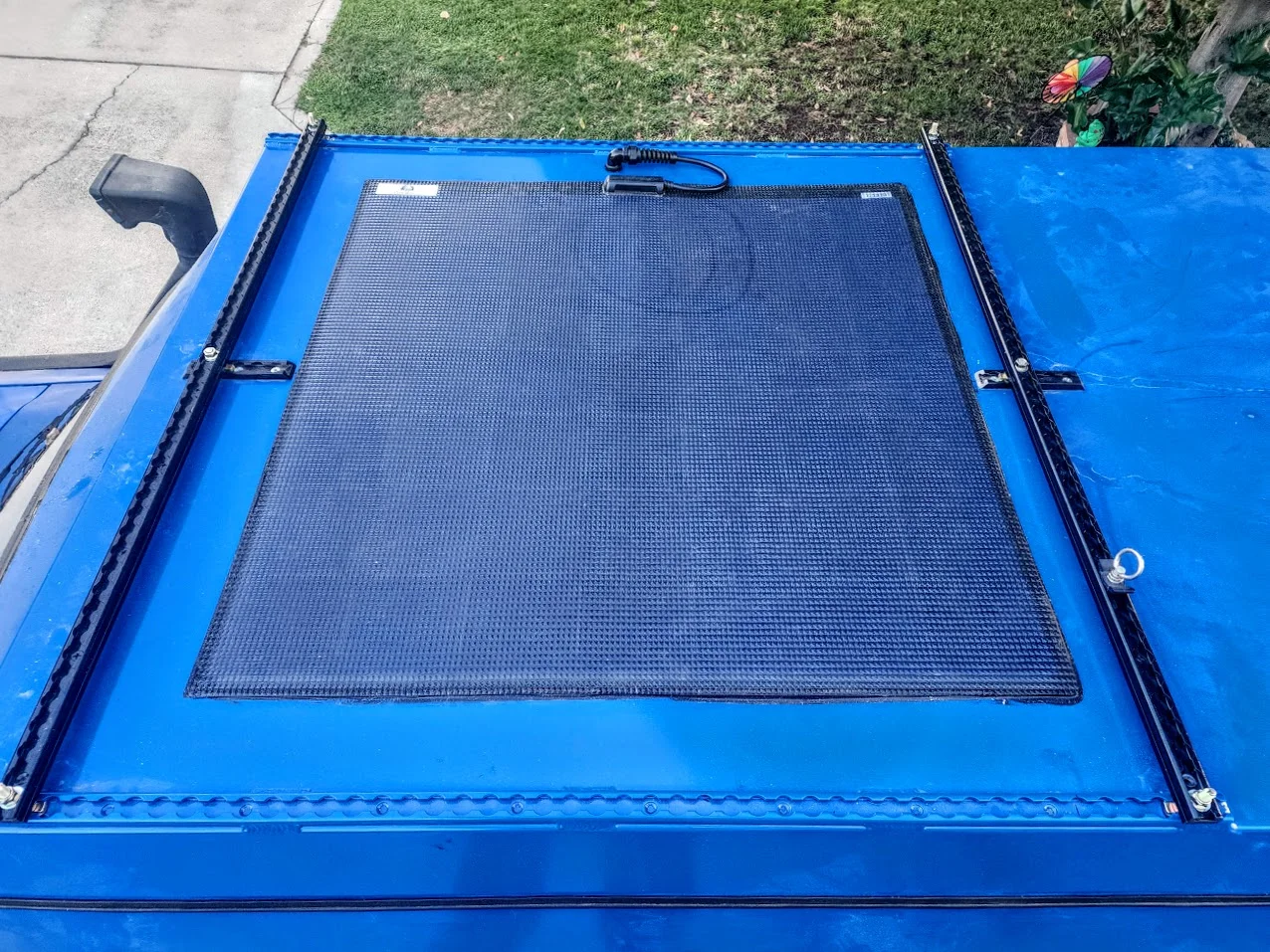

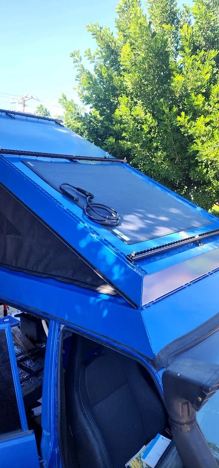

I had the rigid panels and thought they were too heavy. I since went to more of a mat style. I used a 1/2 aluminum channel and secured the mat to that in the front and back. Those were secured to the roof of my truck with magnetic pucks with bolts that protrude up. If mounting to fiberglass I would fiberglass some mounting point on the corners and then use some sort of adhesive tape. I think the high end tapes will secure it fine as well as some of the adhesive/sealants but a mechanical connection is also good piece of mind.

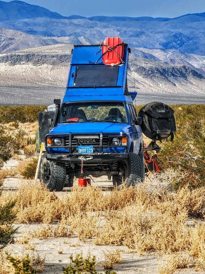

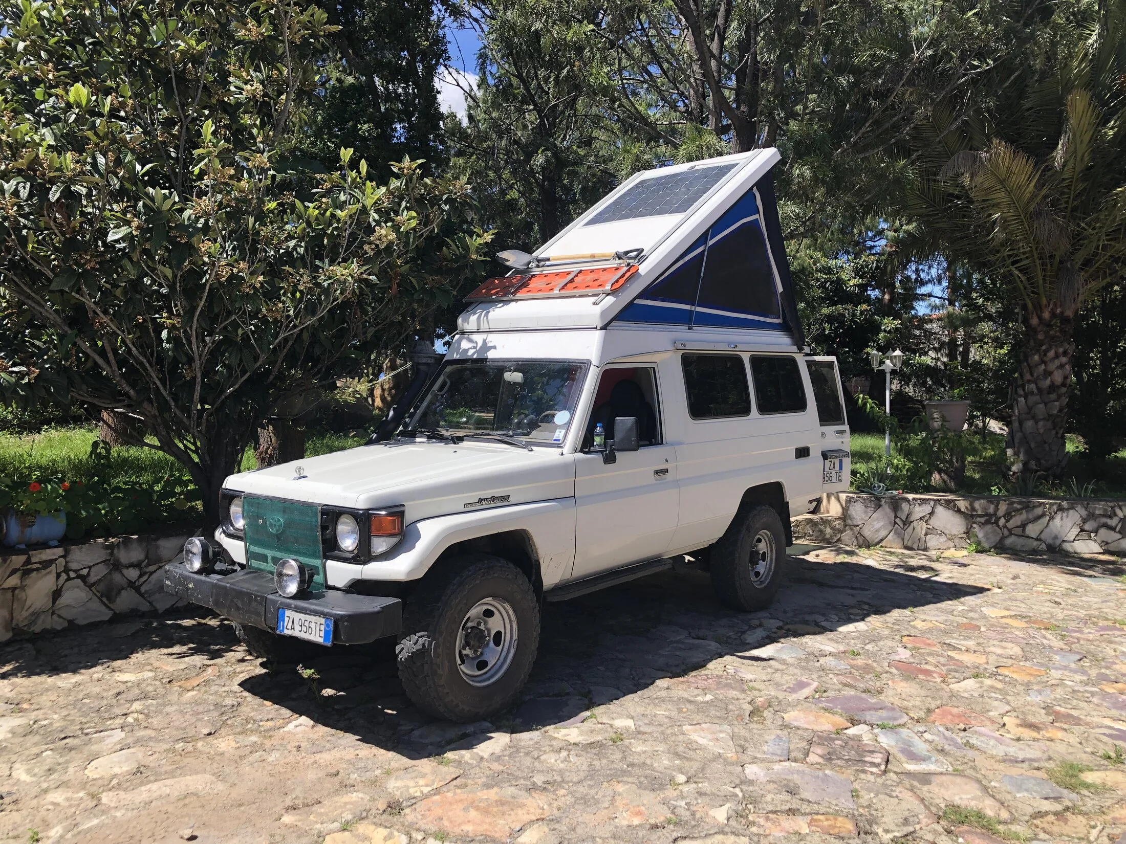

On our Yukon XL we went with a Cascadia 4x4 hood panel that has been great for the last few years with no issue and is only attached via 3M VHB.
Going with something like this would be a bit cleaner and better for the application 100 Watt Universal Solar Panel | RTT, RV, Camper | Cascadia 4x4 - https://www.cascadia4x4.com/collections/rv-roof-rack-rtt-vss-system-top-tent-solar-panels/products/100-watt-universal-solar-panel-vss-system-rtt-camper-rv
Just my .02

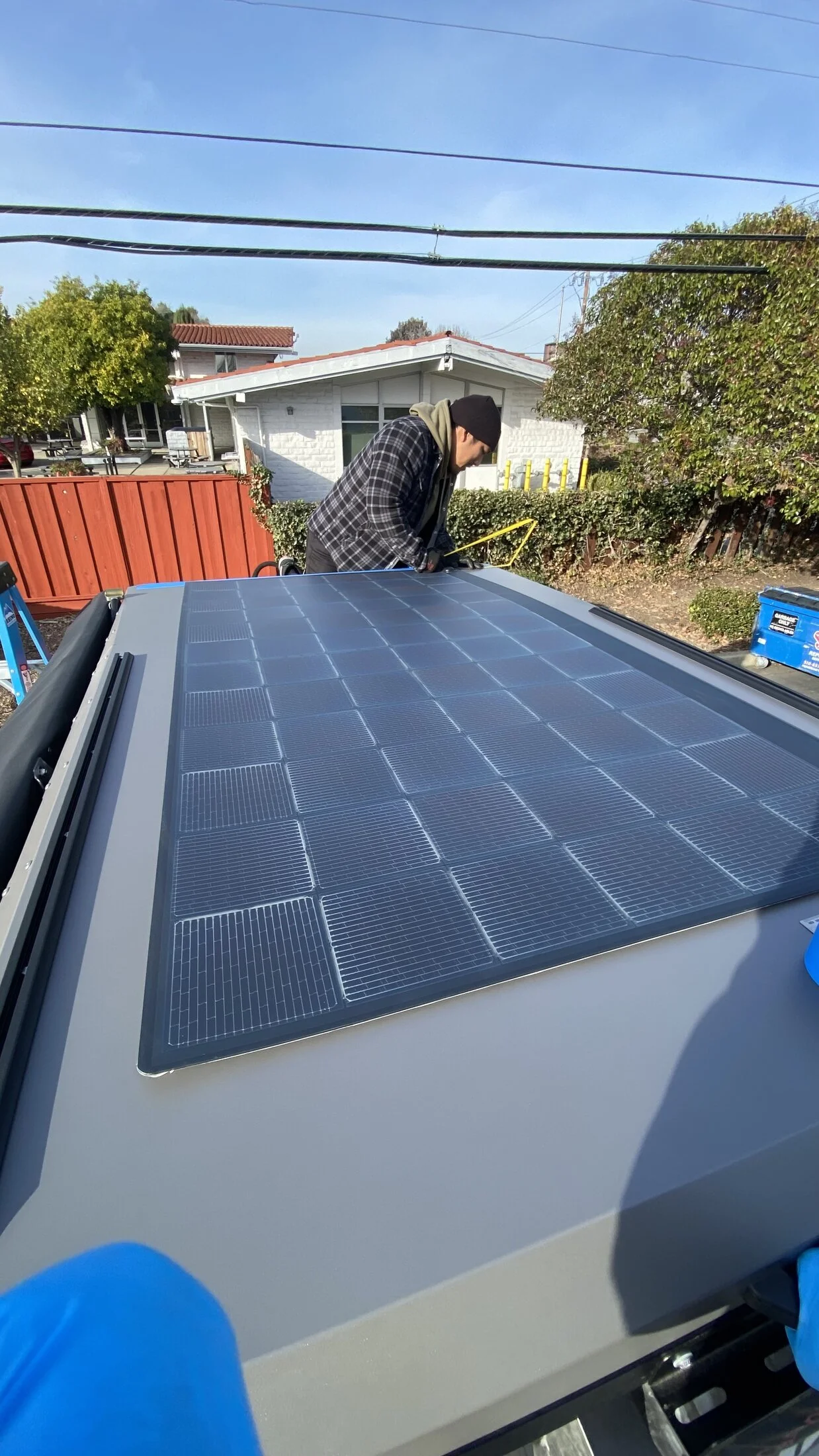

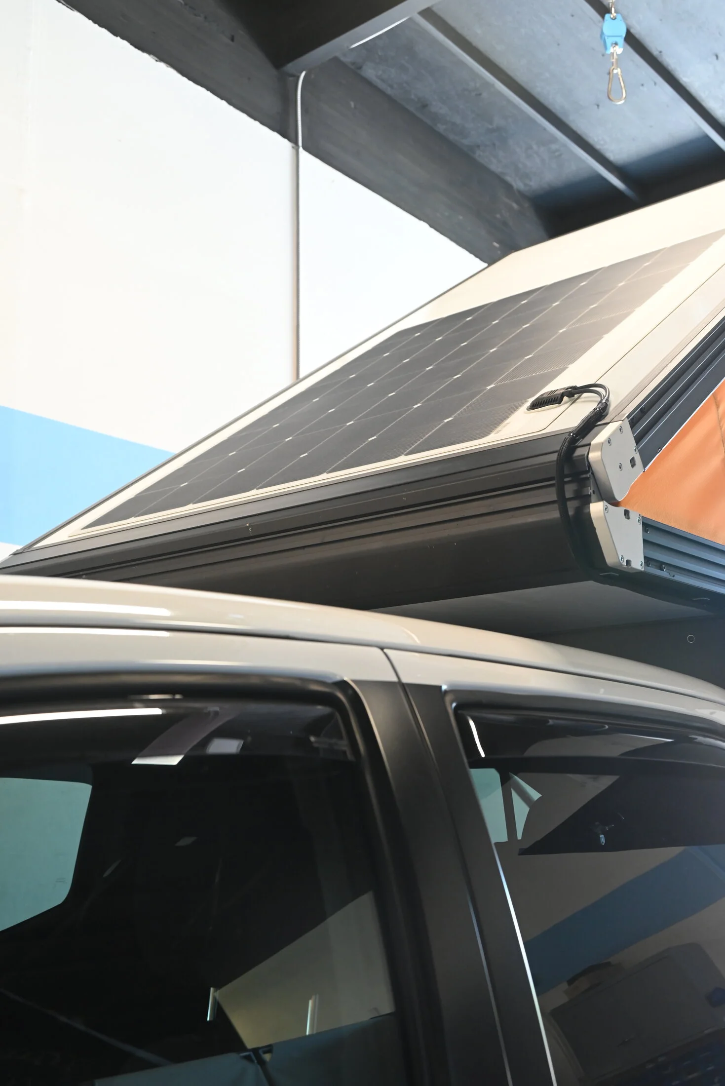

The shop I work for sells and installs various flexible solar panels that utilize adhesive backing to secure to various surfaces. Let me know if you want any specs and pricing. I have various sizes in stock.

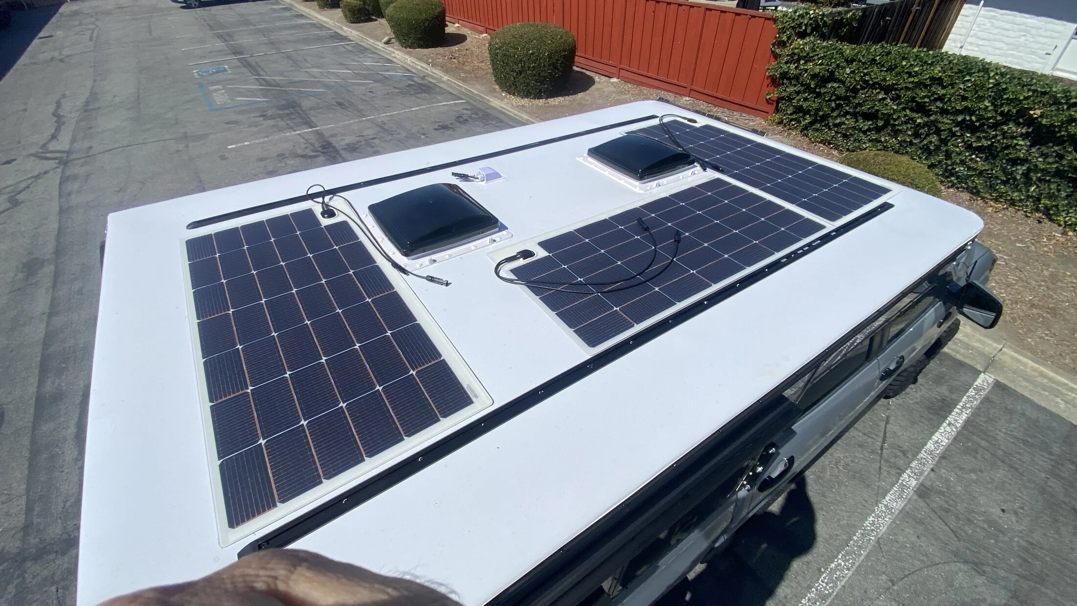

I have a flexible SP glued on top of my roof .
They used a sheet of 3M VHB biadesive , that covers all the SP .
Impossible that it gets detached from the roof .
100%safe,
If I ever meant to take it off , I most likely will destroy the SP .
