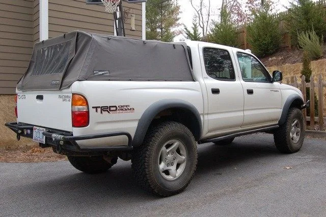

Found this photo (not my truck) which pretty well answers my question as to where. What happens with that outside flap is still a mystery though.
TJK
OK, done. Velcro is on front and rear, front flap is outside the truck. I have a bed liner so I may need to use the snaps in the front eventually but figured I'd give the Velcro a shot. Seems fine so far. Drove out to Hickory Nut Gap Farm to pick my daughter up at the barn. And back. Short of the visibility isn't what it used to be, I couldn't tell it was there. Pretty slick. I like it.

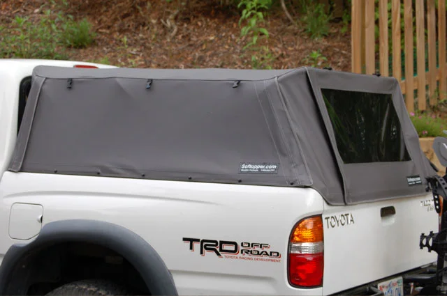

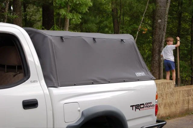

Serves the same purposes as a hard shell camper for me. Keeps my gear dry, contained and somewhat concealed. It's lightweight, installs easily, folds forward to be out of the way and can be removed easily and stored in the bag provided.Hard shell offers better security and is probably more weather proof (although mine withstood monsoon rains last weekend, some at highway speed, and did not leak).
YMMV.
TJK
I had it folded down a lot last summer, hauling mulch and the like. Super easy and I had no problems with the poles getting bent or anything.

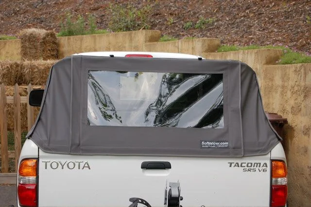

I'm still very sold on it. I did replace the Velcro with some heavy duty Velcro. The stuff that came with it was pretty cruddy. Canvas is in great shape, zippers working very well, windows staying clear. It's a little harder to keep the flap open/out of your way when it's really cold because the canvas gets hard but it's not much of a problem.
I think the only thing I don't like about it is the same thing I wouldn't like about a hard shell camper -- reduces visibility to the rear pretty significantly. That said, if I want a clearer line of sight, I can fold it down.
Here it is 18 months later. I don't garage the truck.
