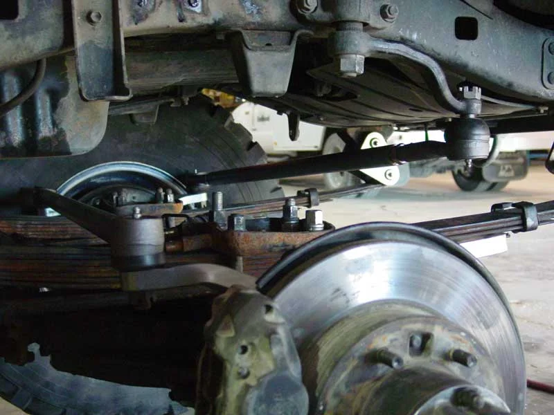

Not really but it places it way back there. I dont quite know why though. The All Pro set up is high steer and places the tie rod above the axle. Here is a pic of my high steer set up.

I dont know, I just dont see a need to have your tie rod that far back there.

I went with the 4x4 labs arms to get the tie rod out of the way of the drag link. I also think that having the tie rod behind the axle and out of harms way is a great idea. I have wheeling partners that have the OTT arms and the All Pro arms and they both have rubbing issues with tie rod to drag link.
I am going to have rubbing issues with my oil pan and plan on flipping my springs to solve the problem. My bud with his FJ40/45 has no issues with SOA SR and sagina steering box
