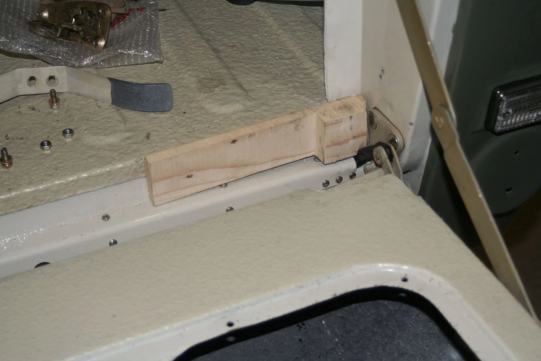

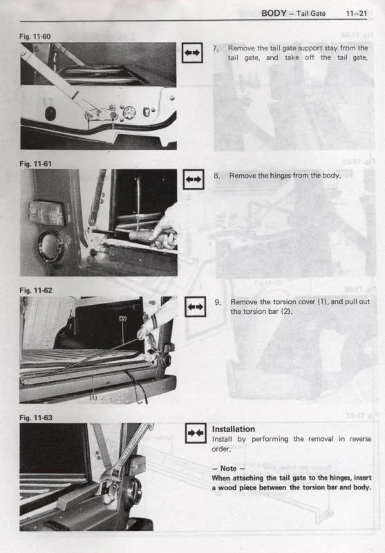

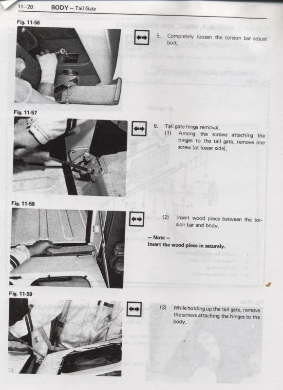

I recall reading how to do it in here somewhere. Has something to do with a block of wood. I think it was in @PabloCruise build thread. Sorry I can't be of more precise help.

Ah yiss...

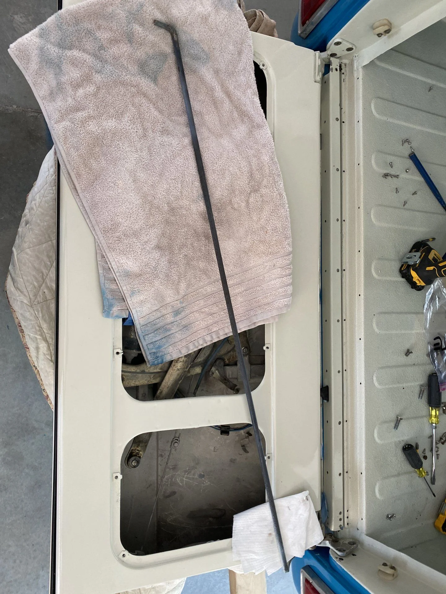

@jmack load bolt is not out. Being the kind of man that i am, i didn't think to look at any kind of diagrams before trying to assemble, ha ha. I figured it was a few bolts so can't be that hard. Channel the bar rides in is clear as I just dismantled to paint. I'll retract the bolt tonight and see if I can't get it in.
