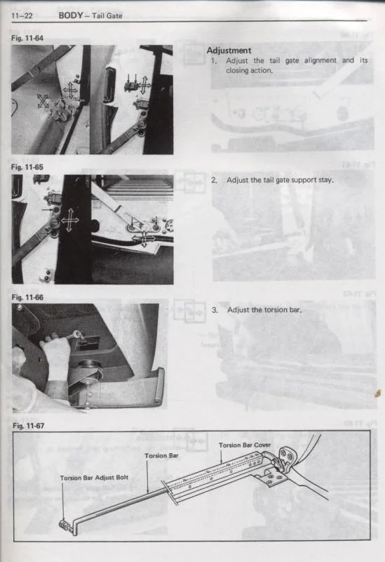

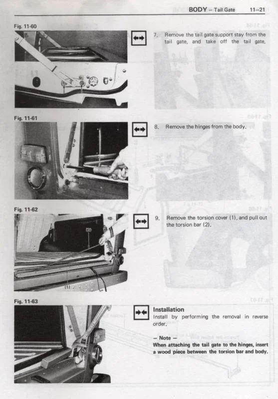

I did find my scans from the FSM on the lift mechanism. Note the part where they use the block of wood to get things in place, this is a good idea...

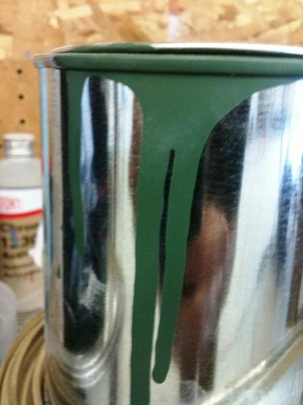

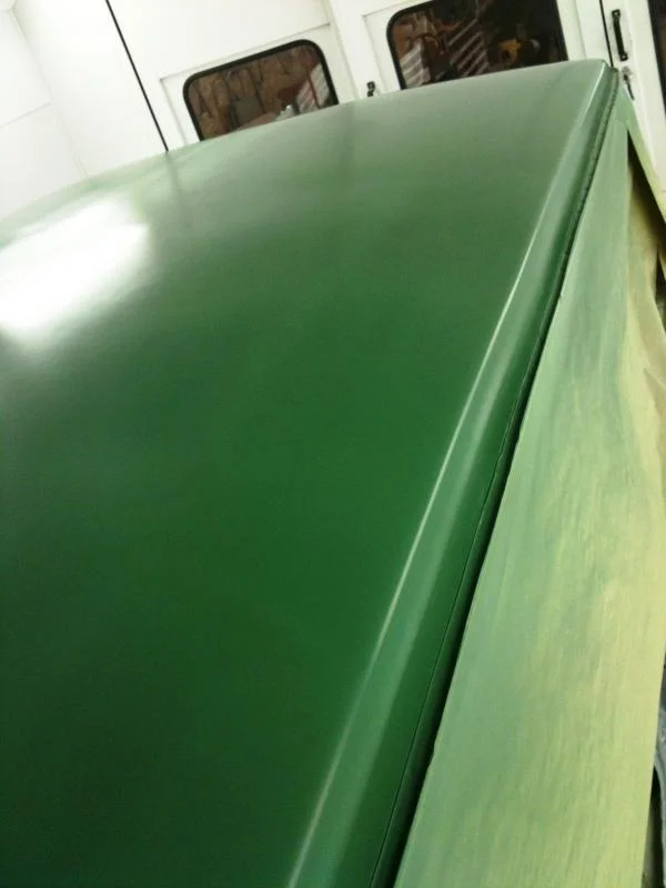

Paint
After degreasing, wiping down and masking, into the booth she goes!
I watched, amazed, as color shot out of the gun onto my Pig. I could finally see some tangible results of all the sweat I had poured into the project. First came the base coat of color, then the clear coat.
Wow!
