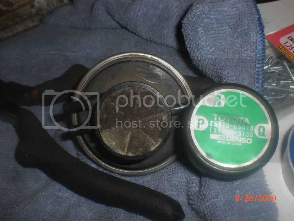

Here is my EGR air filter. How can I clean it?
Should I even try to clean it or just replace it?
Anybody know part number for it?

EDIT Also did you spray anything inside modulator to clean carbon out of that thing?
There are no user serviceable parts in the EGR modulator.

ToothDr - Modulator looks like it is working I can feel membrane moving inside I will clean it and put back there, just filter is nasty dirty.
I rinsed mine out with some degreaser soap-but mine didn't look as bad as yours. i think the only thing I had on hand at the time I was simple green or alike. IIRC you have to wait until it's completely dry before you reinstall. Modulator probably needs to blown out too.
While you're in there you should probably blow out all your vacum hoses if the filter looks that bad. Take off the EGR valve and clean it out too.

Mine is dirty probably due to lots of dust and oil leaks I had. I can see carbon in modulator so lets see if throttle cleaner takes care of that or I am gonna borrow wifes steam clean er :)
Do not use cotton. It is exposed to relatively high heat, so that's a good way to start your truck on fire (not likely, but...).
You can clean it by spraying it out with an air compressor. That's about all you can really do.

Ditto with using the compressed air. As dirty as yours is it's going to be tough getting all dirt out of the filter and carbon out of the modulator. On a high mileage rig I'd replace it as well as all the EGR vacuum tubing.
