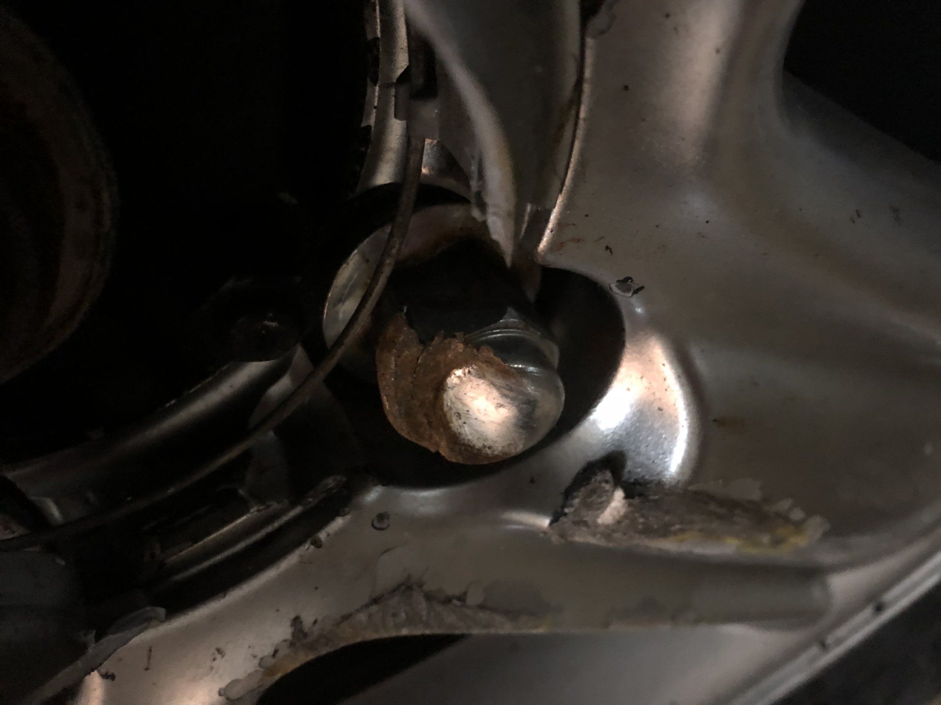

Slid off the road sideways into a snowbank apparently buried within the 4 foot high snowbanks was a fire hydrant.
Insurance says all the shops are about a month out. So they say the adjuster will come out and cut me a check and I can go get it fixed wherever . Never been down this road before with this process that’s not me just dropping off at a shop and then taking care of it, a little hesitant because how am I/he supposed to know besides the visually obvious what could be wrong.

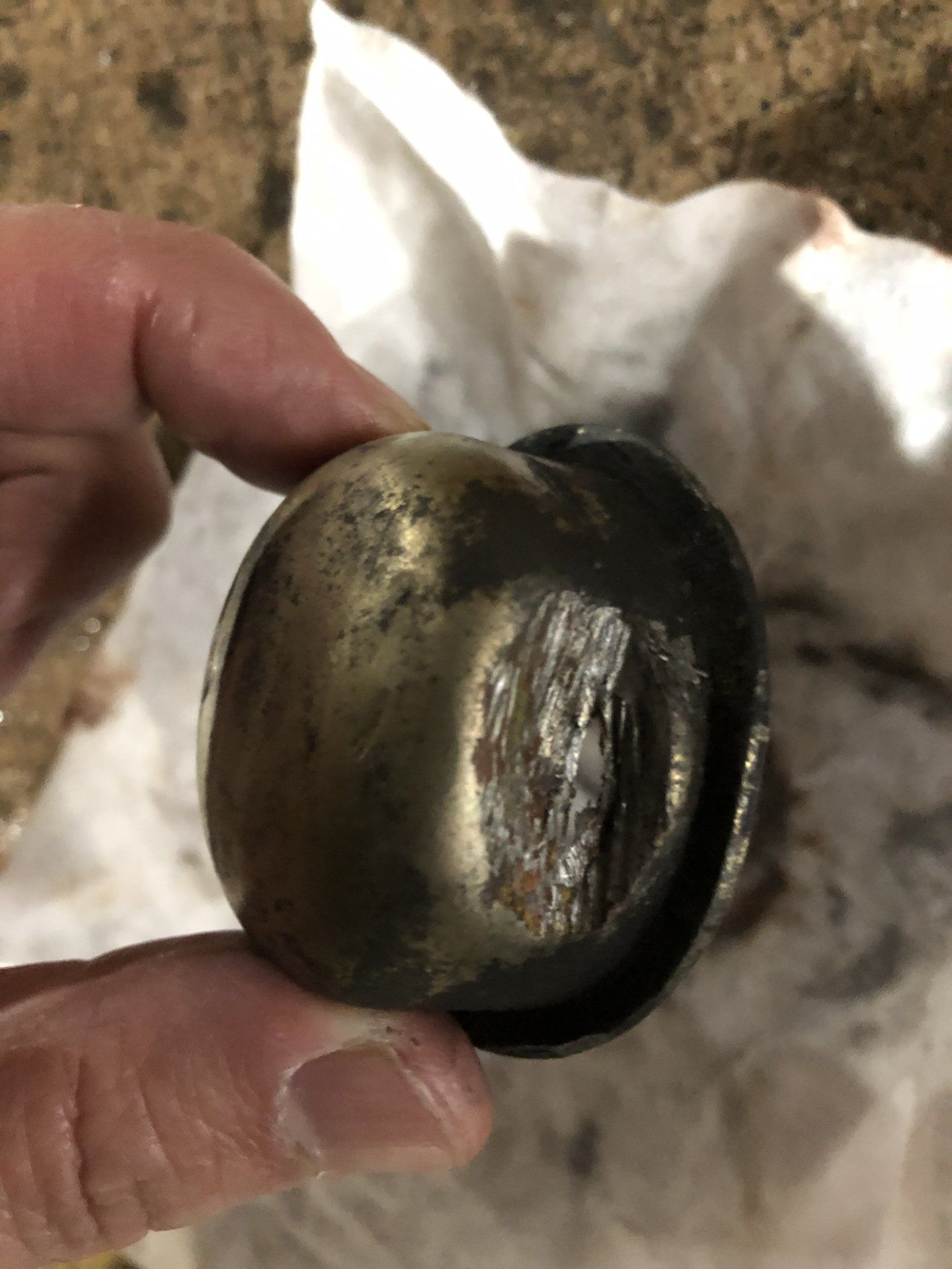

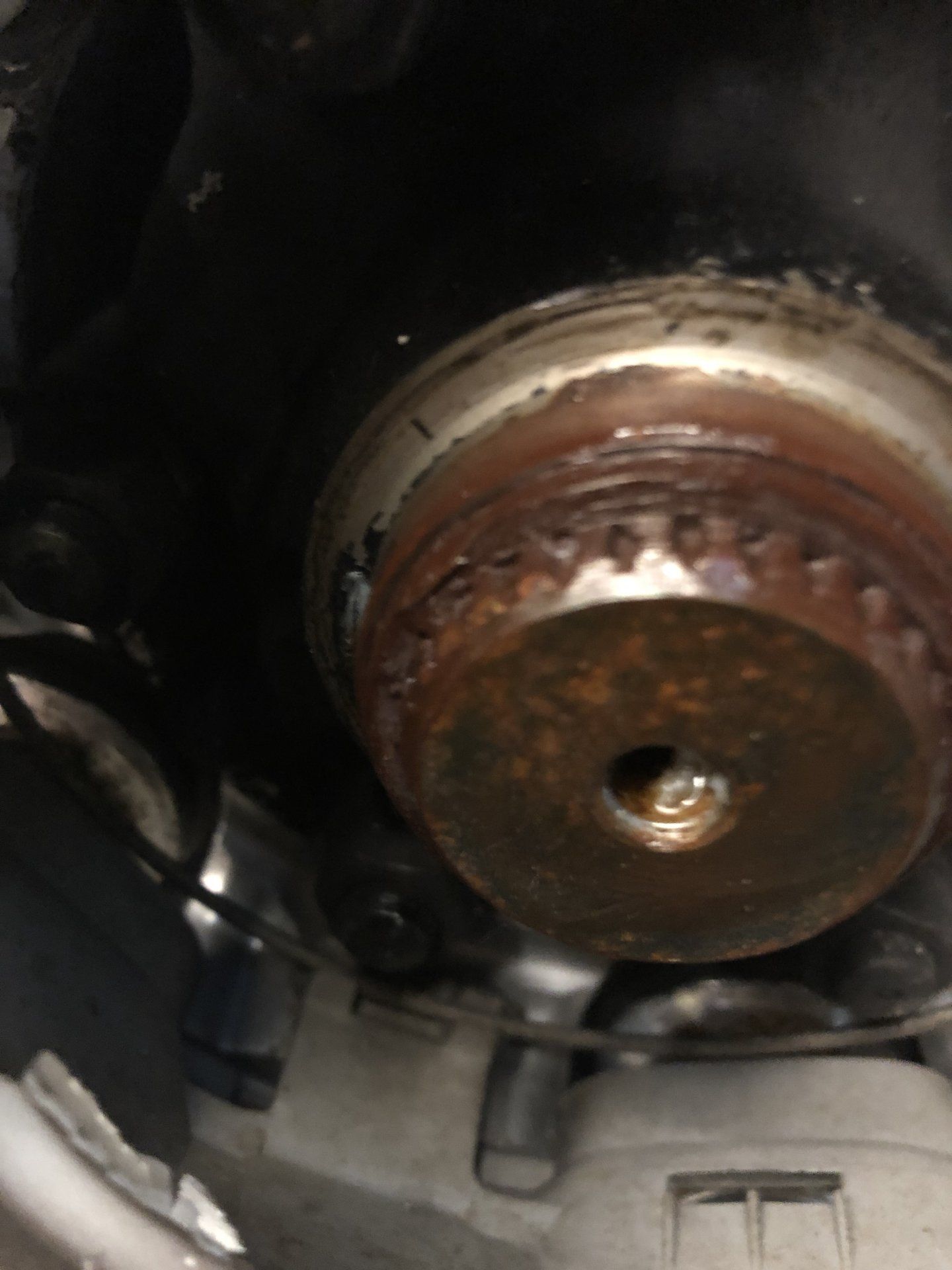

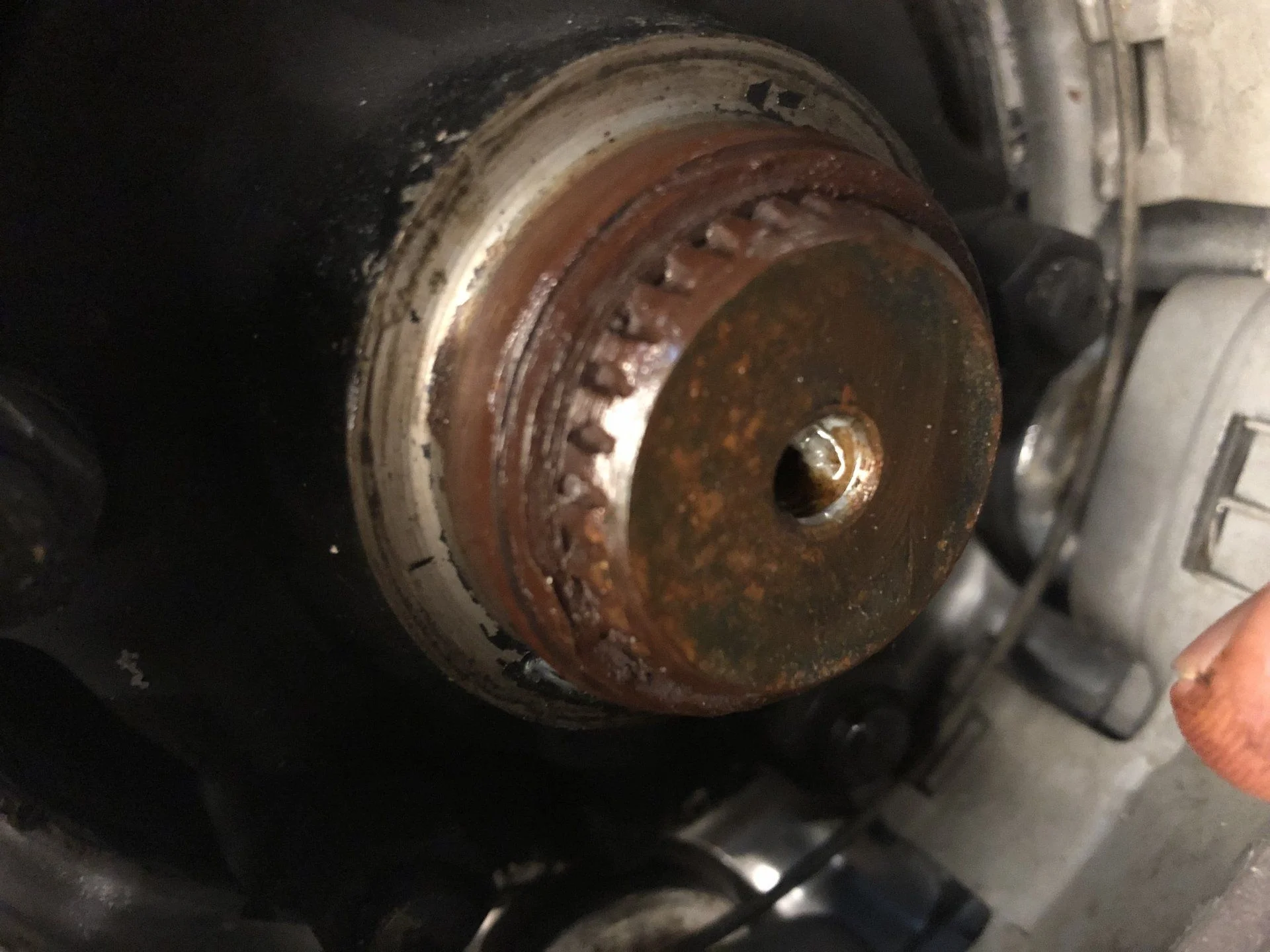

Anyway, front driver wheel took the brunt of the hydrant (wheel, lug, etc). See pic. Dust cap damaged and looks like the hub assembly (don’t know my parts that well). Running board, little bit of bumper and quarter panel.
My questions are:
- what is damaged on the hub assembly in the pic and what could indeed to replace? Not easily visible in the pic but the area around the splines was damaged (if you see the dust cap you can guesstimate where) Estimated costs?
- for now the dust cap won’t stay on. How do the dust caps attach, anyway?

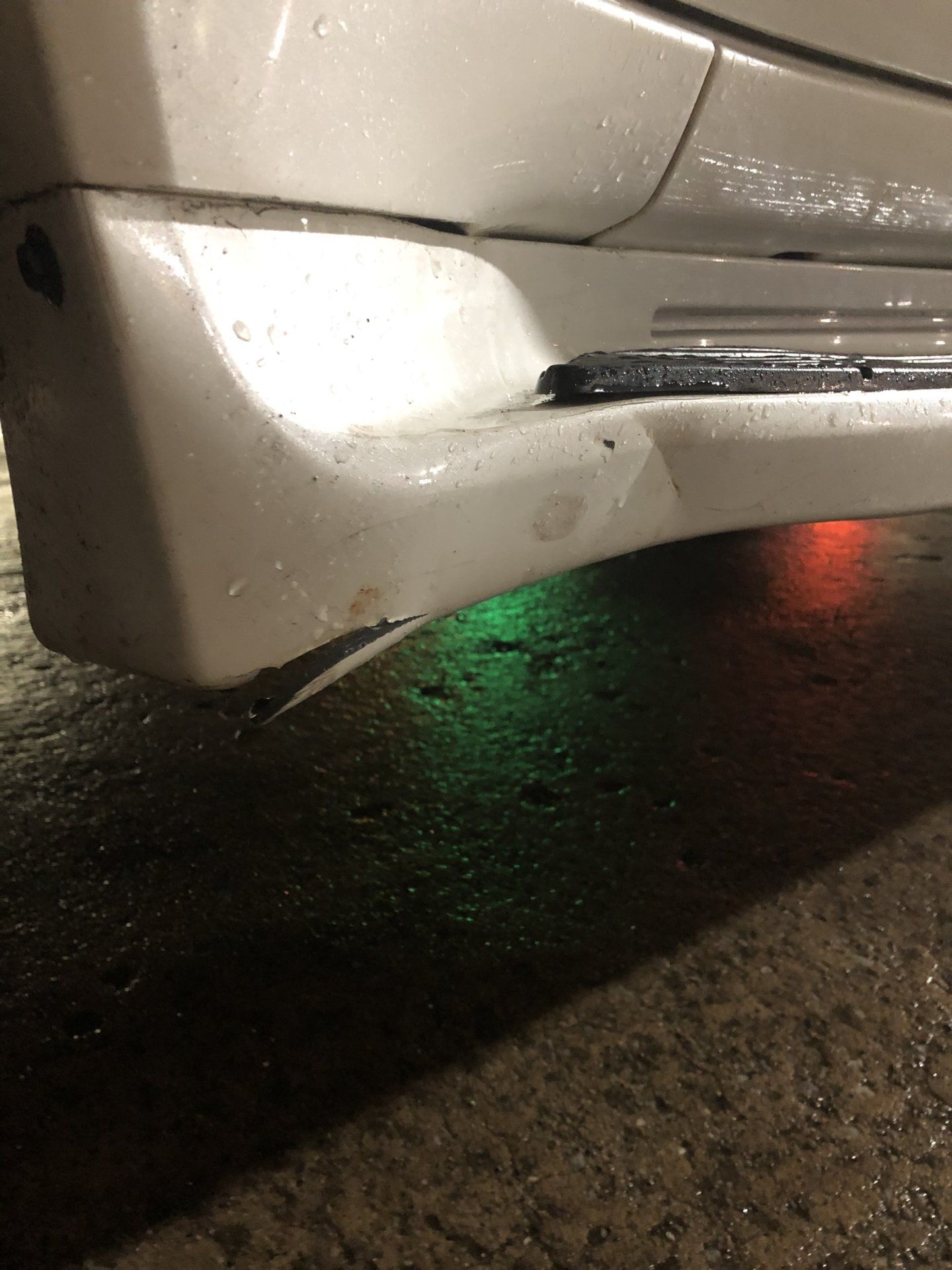

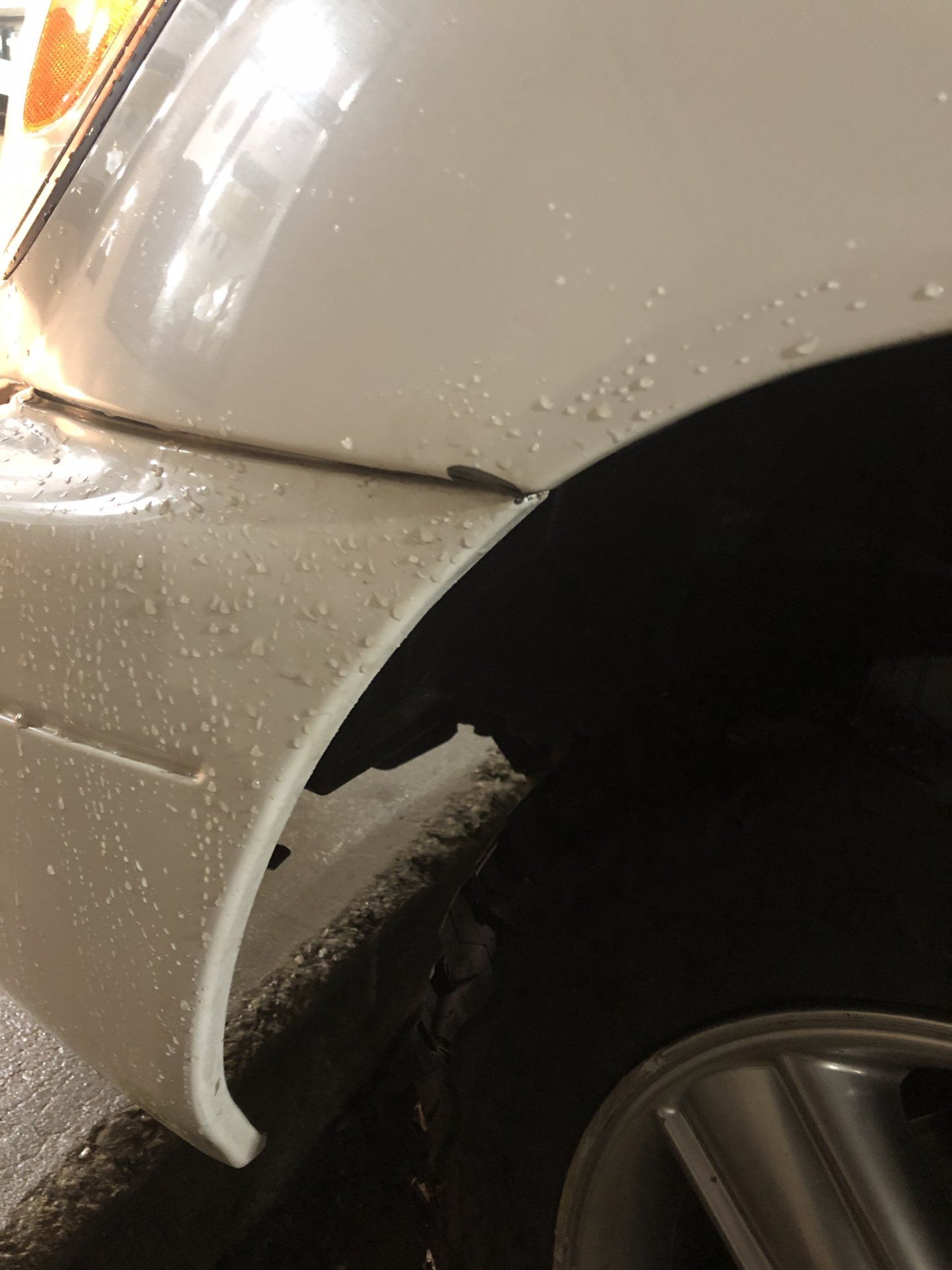

Pic of bumper/quarter damage. Bumper a little loose. There was a ton of snow.
I guess it all doesn’t look too bad but you know how these things with shops just add up to crazy amounts. No idea what the ballpark should be.

I do see that your splines are very rusted. There is no fresh grease. It looks like your cap has been leaking for a long time. That could also mean that the wheel bearing grease is contaminated. Just wanted to let you know that it is probably time to inspect and repack the front wheel bearings and spindle bearings.

(Re the splines: I think they appear more rusted than they are - surface rust happened over the course of 48 hours pretty quickly and more than I thought - didn’t look like that right after the accident. Even the lugs rusted over the course of those 48 hours)
