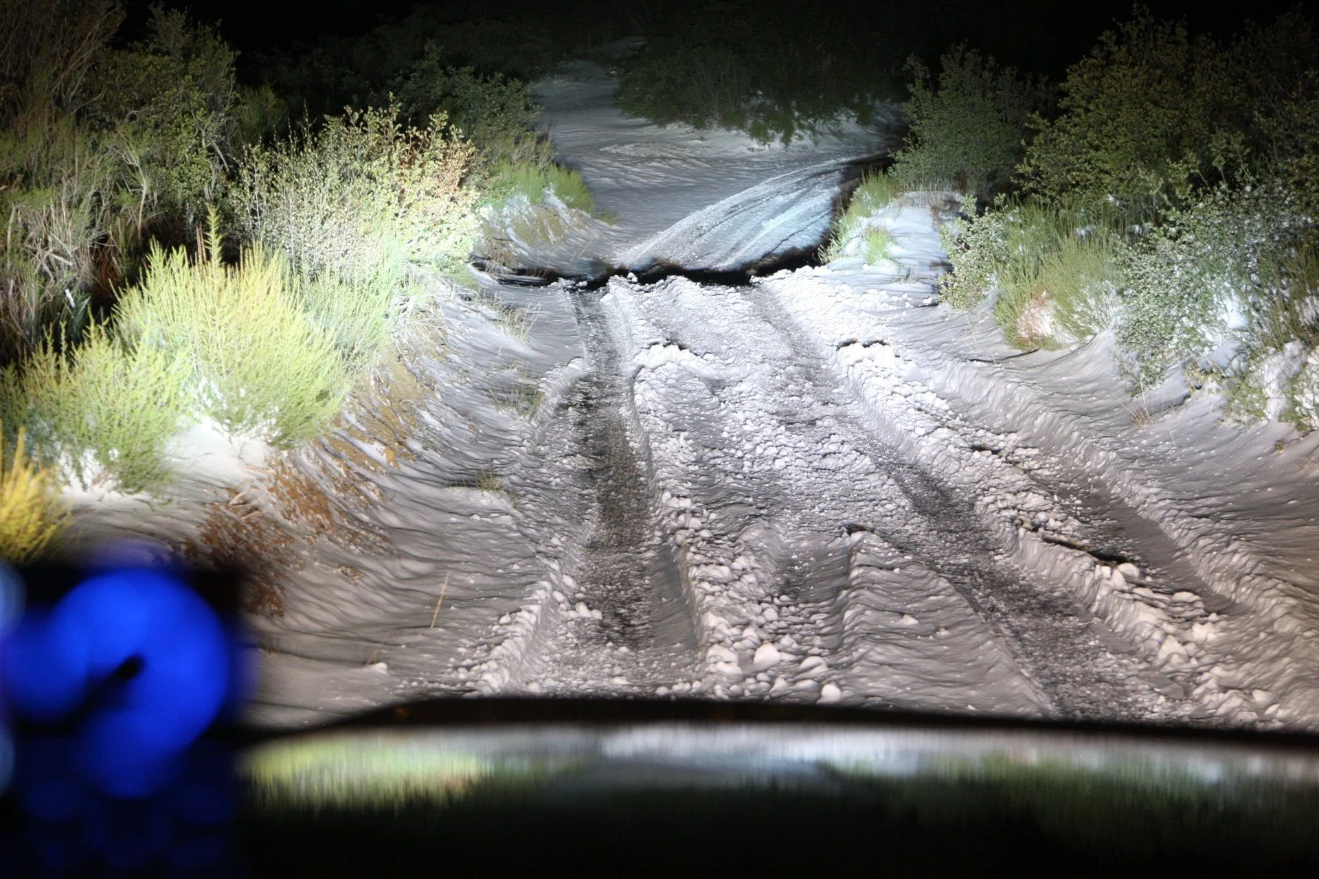

Here’s a example of a time where I didn’t want to float on wet snow bc I could cut through to pretty solid dirt.
This is a shot as I followed my own tire tracks back out. It varied between wet powder and slush on top of pretty solid dirt. See how my tracks cut through to more solid, darker mix of gravel/dirt?
1900641
So I didn’t want tread spread here. If it got super thick, and just riding on top, I’d have aired down because the grippy lower stuff might not be reachable.

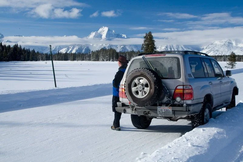

This next shot is thick snow, but super hard packed and nearly perfectly flat from a plow some time before. Traction was a piece of cake but if it had started snowing heavily again, I’d air down. This was about 14 below zero plus wind, btw. Brrr...
1900640

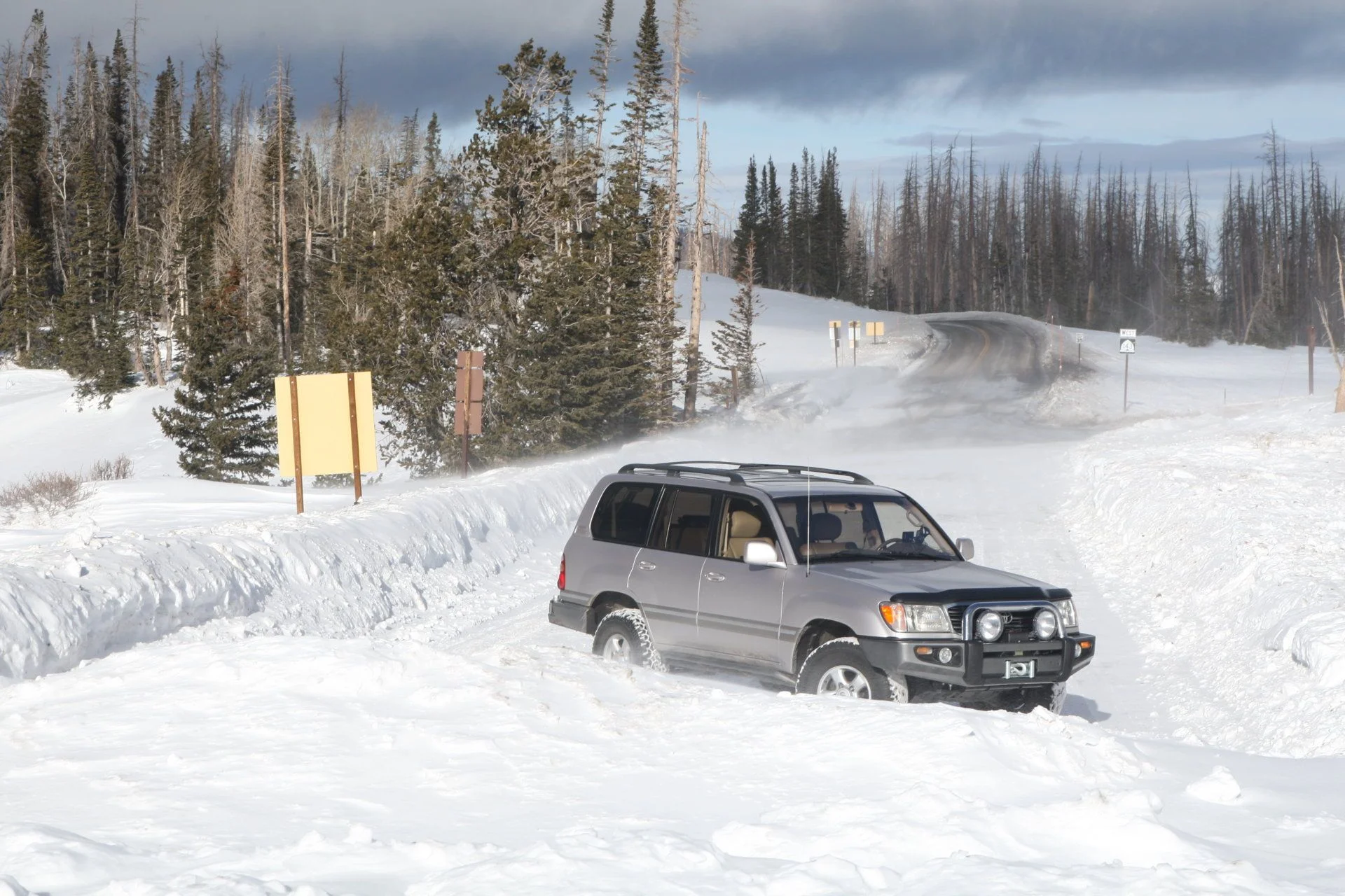

Next shot is where I stopped to air down before hitting a portion that looked deep & fluffy (I look buried in this shot, but I’m actually right next to where it was gonna get fluffy)...where no plow had run & airing down made sense again:
1900642

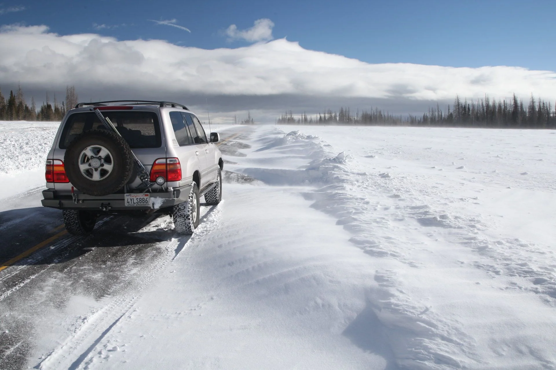

-A while after leaving this snow-drifted rest stop (photo below) heading toward Wyoming late one night...
1900645
...I found two terrified college girls stopped on the mountain highway in their Corolla (no chains)... at about 2 in the morning in hard-blowing snow. They were terrified and almost out of gas!!
Really dumb... but it happens. :)
-Gave them fuel, and then followed them to the town 90 minutes ahead. Road looked scary but was grippy snow on top of rough-top pavement. So not icy. They were scared to death, but made it fine after about 90 minutes following them in my 100.
