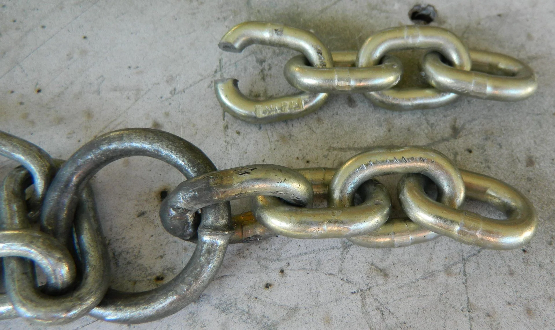

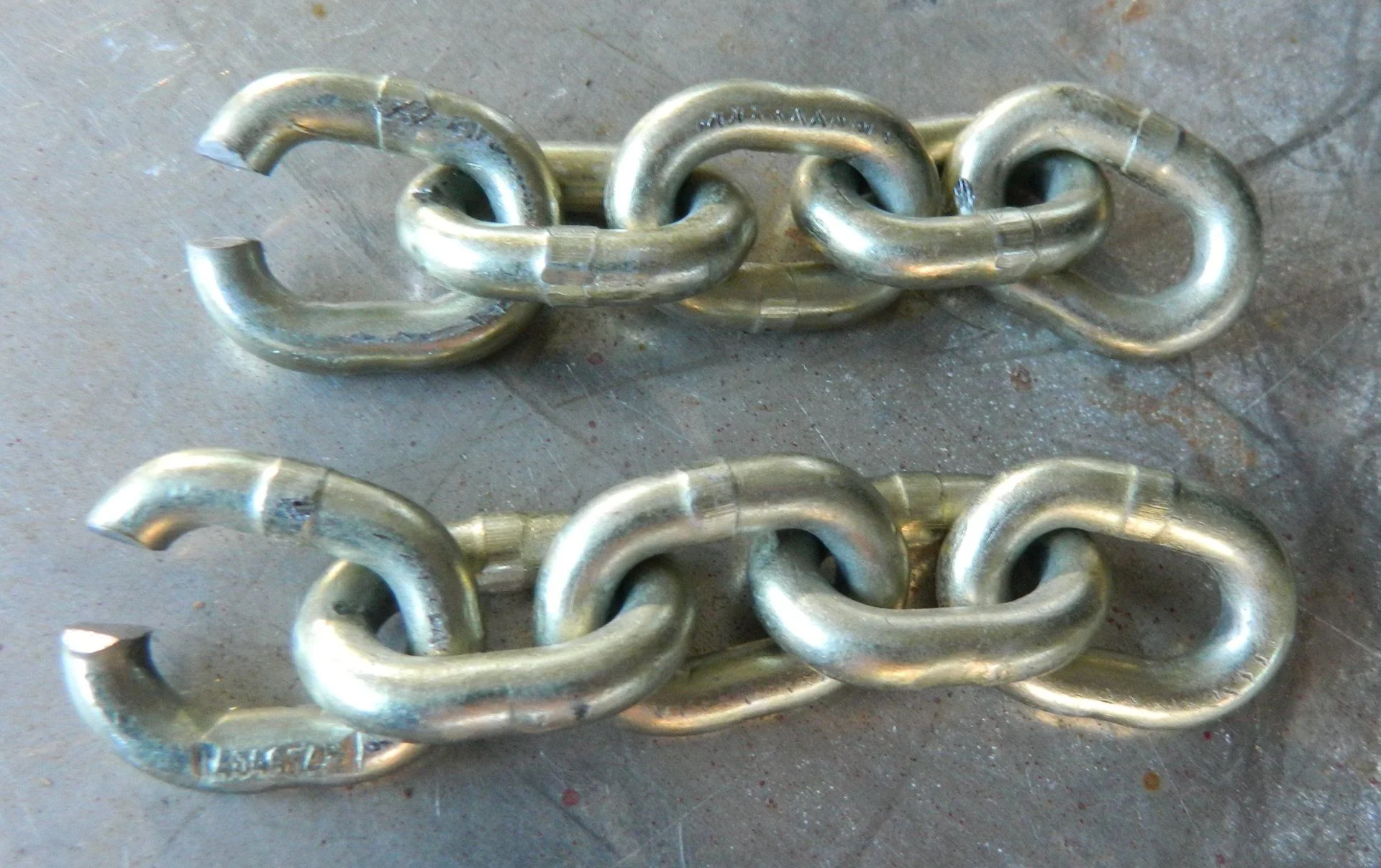

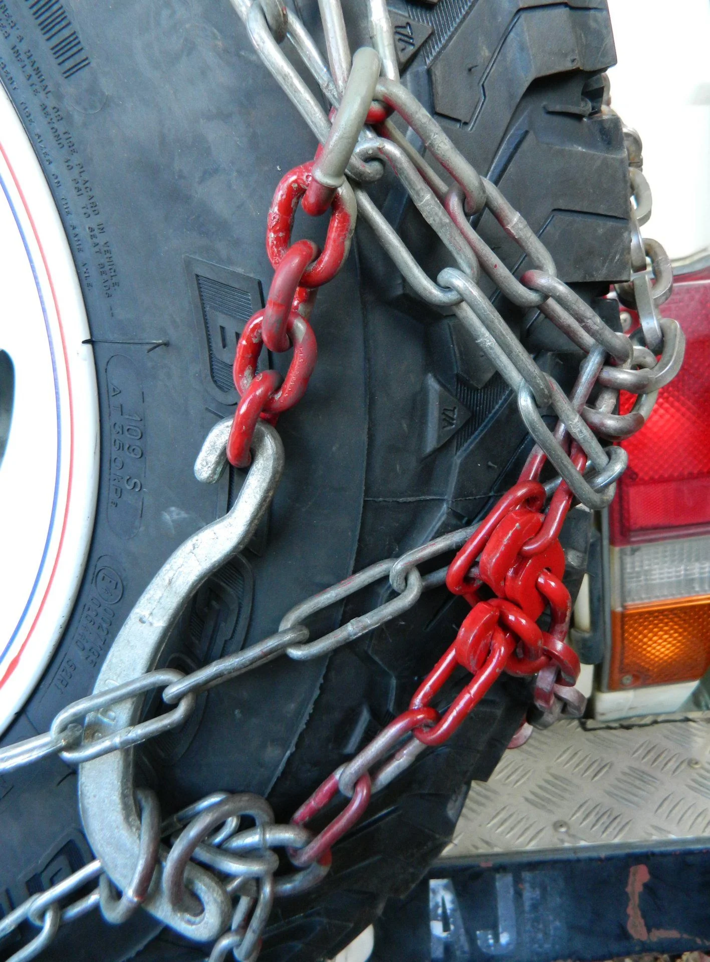

G'Day Fella's,
Since I posted this original thread, I've had a bit of a shop around and because of this, a bit of a re-think.
Getting a new set of the appropriate size Konig #255 Polars locally, was not as easy as I thought it would be.
So after a bit of time and a think, I decided to modify the set I already have, by adding some additional chain links to them.
I had some off cuts of 1/4", "Herc-Alloy" chain laying about, so I cut off two short lengths, cut one of the links, spread them at the cut, closed them up in place, and Hot Glued them back together again.
Here's some images the additional links, cut and spread.
One extension in place and Hot Glued back together again.
And in place on my spare wheel, with a bit of red paint, on the bits I need to find.

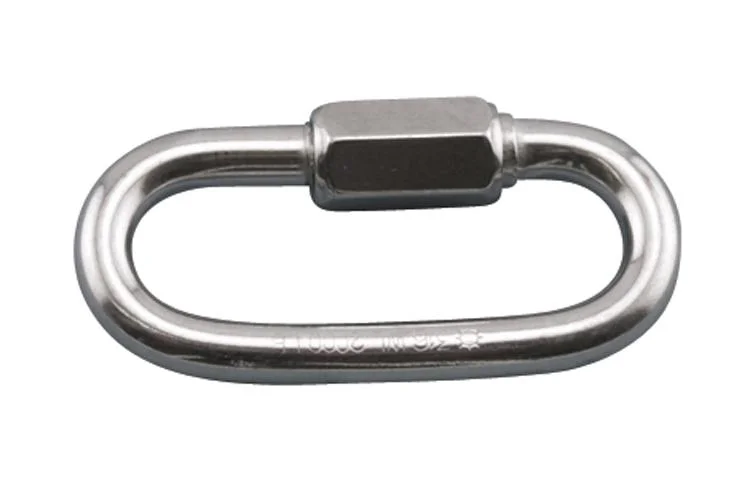

I do not think your hot glue is going to hold.
I'd use one of these.
G'Day Fella's,
Yes, I was being cheeky, by refering to Welding as Hot Glue.
I do refer to my various welders, as Hot Glue Guns............ which in a round-about-way, they are LOL!
Thank You Spike555, for your advice on this, and yes, these products would have worked well, as a solution.
