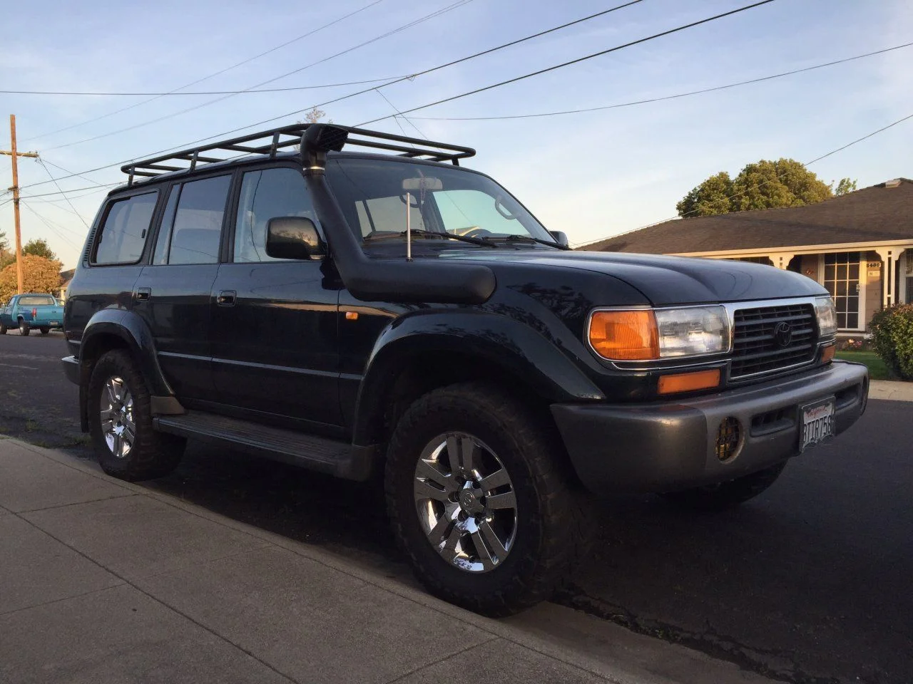

As a result of this thread I bit the bullet and bought an eBay dorkel. I purchased it for a whopping $80 total, and to my surprise i was able to pick it up will call a whopping 4.5 miles away. I am not sure when I will be able to install it, but it looks hella solid and well put together. I'll post up pictures when it is done. Cheers!
Adding my experience on installing an ebay/amazon snorkel. After evaluating the cost of a new hole saw ($40-60), then hitting up my neighbor who had one but it was extremely dull. I decided to use my jigsaw. This is the way to go, Im telling you!. After much research, I determined the included template was not to be trusted, so I proceeded cautiously. Locating where you think the hole should be, tape off the area with blue tape and draw the minimum size hole to be cut out. If anything, plan the first opening further back than forward then you expect, If its off, the body of the snorkel will cover it. If you go to far forward you will run the risk of exposed hole (That is what I did, but was able to hide with some black silicone sealant). Drill a 3/8 starter hole and proceed slowly with jigsaw and metal cutting blade. Check your fit, if it needs to be fudged in any direction, make small adjustments checking fit periodically. The Jigsaw makes a finer finished cut than the hole saw, and you have more flexibility.
Just finished my install. Fairly easy but you need skinny arms to get all the nuts started. I used a conduit hole punch to cut the 3" hole much easier than holesaw or jigsaw.
Take away from the install is that the screw holes are off on the template. I installed the srews on the dorkle and used them to mark where to drill the holes.
