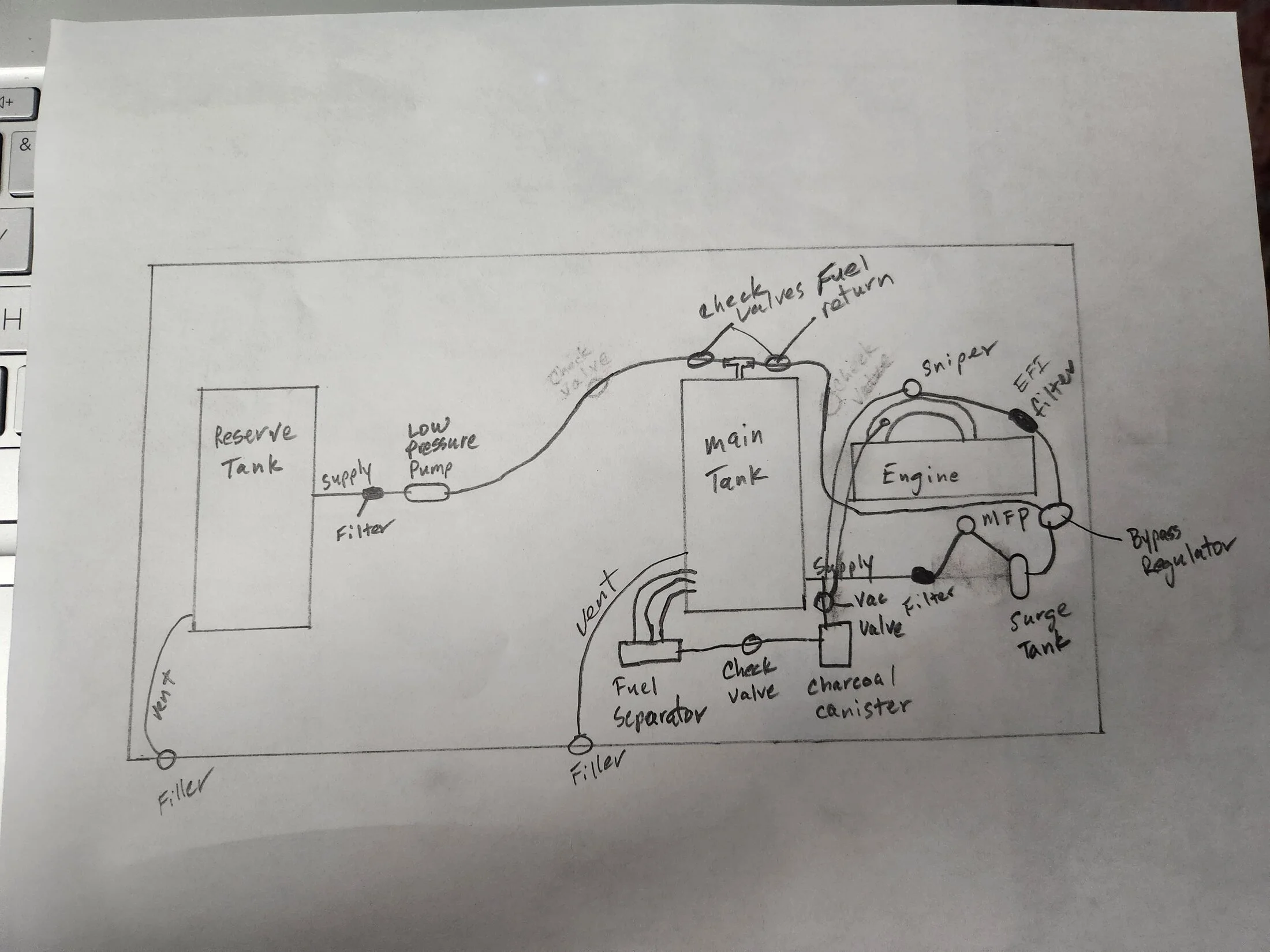

My rig has dual tanks with a Pollack switch over valve that is capable of handling the tank return. However, the rear aftermarket tank currently has no provision for a return. I'm also thinking for now I will simplify some of the plumbing and just fill the main tank from the reserve.
One of my questions is how to do that. Should I run a T at the main tank return so the fuel return from the surge tank bypass regulator I'll run and the fill from the reserve both go to the return port with check valves OR fill the main from the reserve with a T into the vent pipe?

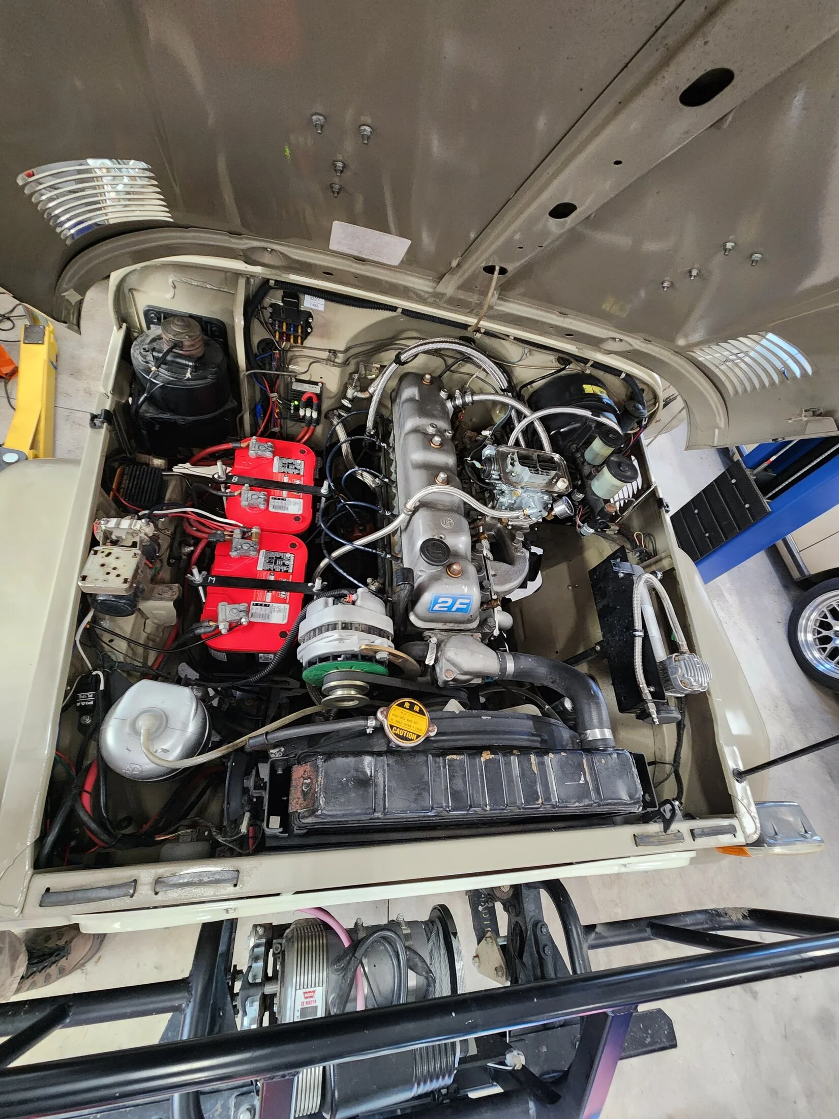

My engine bay is a bit stuffed due to the dual battery setup. I think I'll move the radiator overflow to the driver side and locate the surge tank in that spot. I then need to find room for the charcoal canister.

No expert, but in the design stages as well. Your drawing looks functional. Goes without saying (maybe) I would not fill from rear tank and run the engine (surge tank pump) at the same time, as the two streams of fuel (new fuel from auxiliary, and return fuel from regulator) will “dead head” into each other in the “tee”; and likely mess with your regulated pressure to throttle body. I say run it!

Thanks. That was the plan. Only fill from the reserve when the engine is off.
I would probably just run the return back to the surge tank. I’ve never used the surge tank but the setups I’ve seen usually just feed the surge tank and dump return fuel back into the surge as well.

I have been emailing back and forth with Robb who makes the surge tanks. That is not the setup that he advises. He wants the fuel feed to go to a bypass regulator which has a port for the return back to the tank. That can either be at the sniper itself, using the built-in one, or in my case I'm going to have one he makes coming right off the surge tank so I'm not running the return line back from the hot side of the engine.

I would run the return from the sniper. I think Holley recommends this. I’m not sure if there are issues returning before the sniper (I know a lot use the corvette style regulator with return), it just seemed to me the return from the regulator at the end of the line was best. But, again, there’s lots of other rigs out there problem free other ways.

My exhaust is fairly new, from the previous owners work. I smoke tested the exhaust and the vacuum lines and carb setup yesterday. All looked good with the exception of a small leak at the PCV. I won't add a cat, but will need to add back a charcoal canister. The fuel separator on mine is plugged at that port.

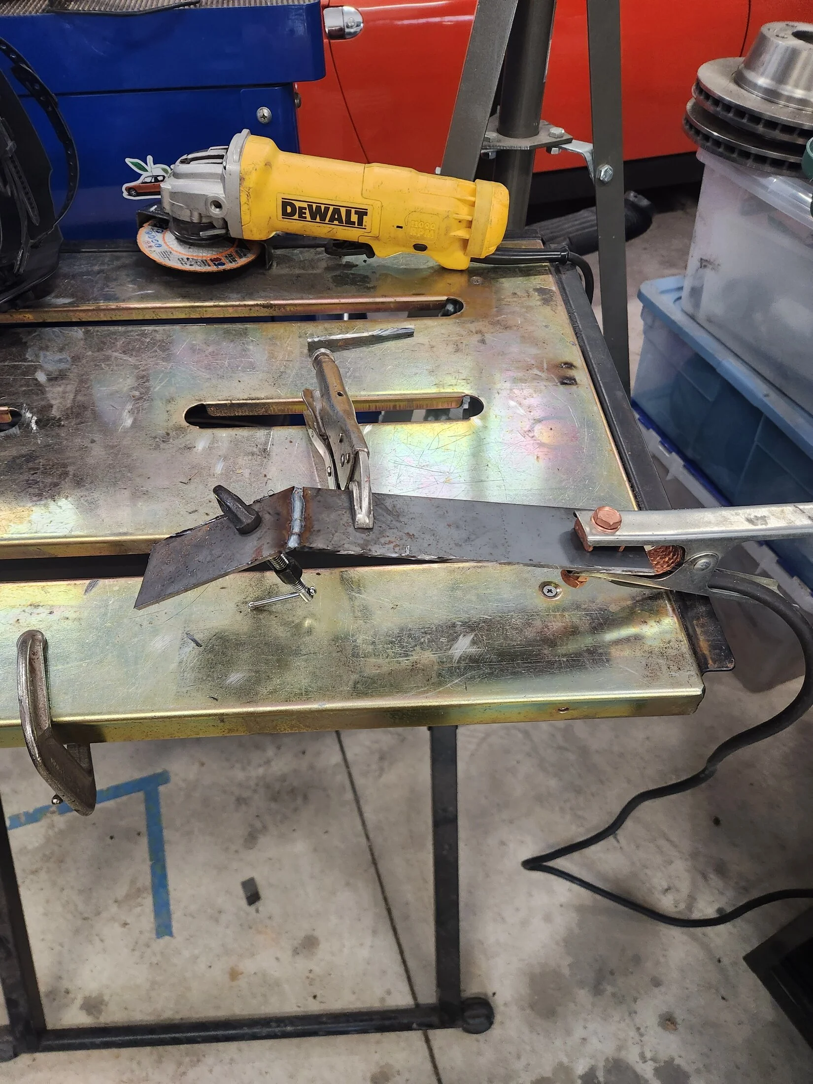

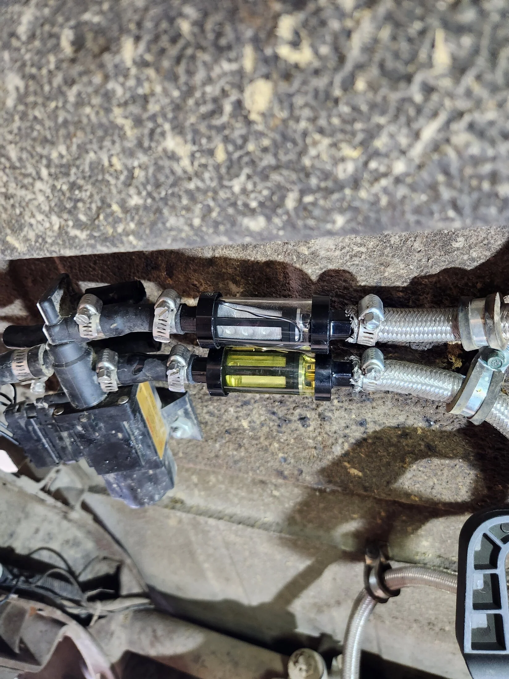

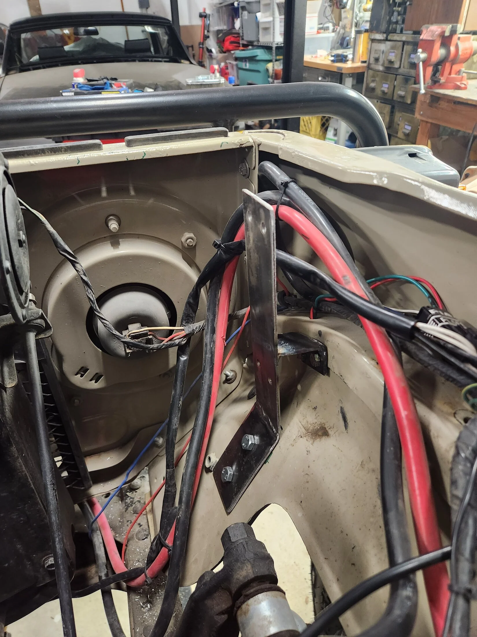

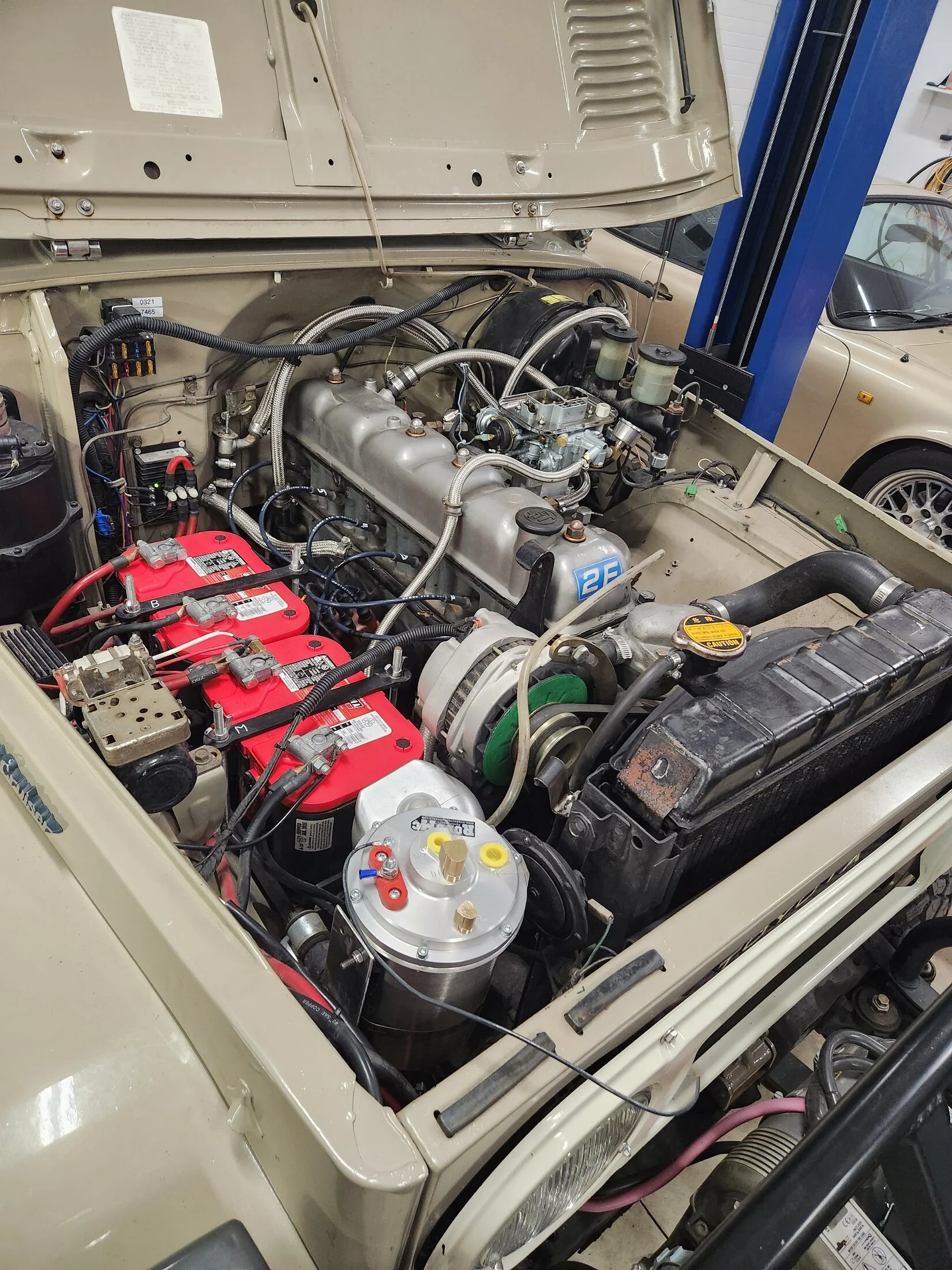

Parts are arriving for this project and I've made a bit of progress with getting the surge tank mounted. I fabbed up a mount from some scraps I had lying around. Once again, hoarding pays off! I've decided to pull the aux tank to simplify things. The fuel coming from that tank has a color that suggest rust in there. These two fuel filters were installed at the same time. The yellow colored one is the aux tank fuel. I'll set up the fuel lines so I can add it back later but may just go with a couple of Jerry cans for extra fuel.
