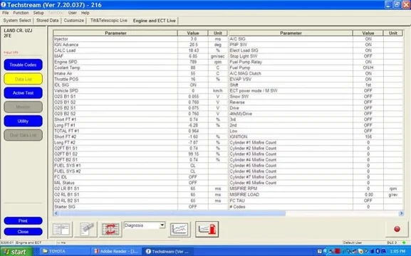

Today I acquired the following readings. Are they of any help to. Diagnose the problem?
Your LTFT values suggest too much fuel/not enough air. Here is a screen shot I took several months ago. Not saying my results should be considered benchmark, but I'm very happy with my overall performance and fuel consumption. Maybe you have a failing injector? I assume you've done the standard MAF and throttle body clean, good air filter, checked for vacuum leaks, spark plugs are good and burning clean with uniform color across all cylinders - the list goes on

I also note your idle speed seems high at 790rpm, my hot idle in park, no ac, is closer to 700rpm, ignition advance at 20 degrees, mine ranges from 11 to 14 at idle and with throttle position of 14 degrees and yours it at 16. The negative LTFT numbers say that your ECM is reducing the injector duration to reduce fuel delivery to get back closer to the optimal designed fuel/air ratio or on the flip side there isn't enough air for the fuel being delivered. The ratios are all close so whatever is going is probably common to both banks and their sensors, so I'd look at MAF, throttle body crud build up and air filter to start with. It wouldn't hurt to run a can of brand name fuel system cleaner through too. I like BG44k. About the bluish smoke on start, not exactly normal for a healthy 2UZ, is it using oil? Is this a new problem coincidental with the aftermarket exhaust or something that has developed over time?

Today I acquired new readings through techsream. I havent done anything to the car howver the these readings are with AC turned off.
