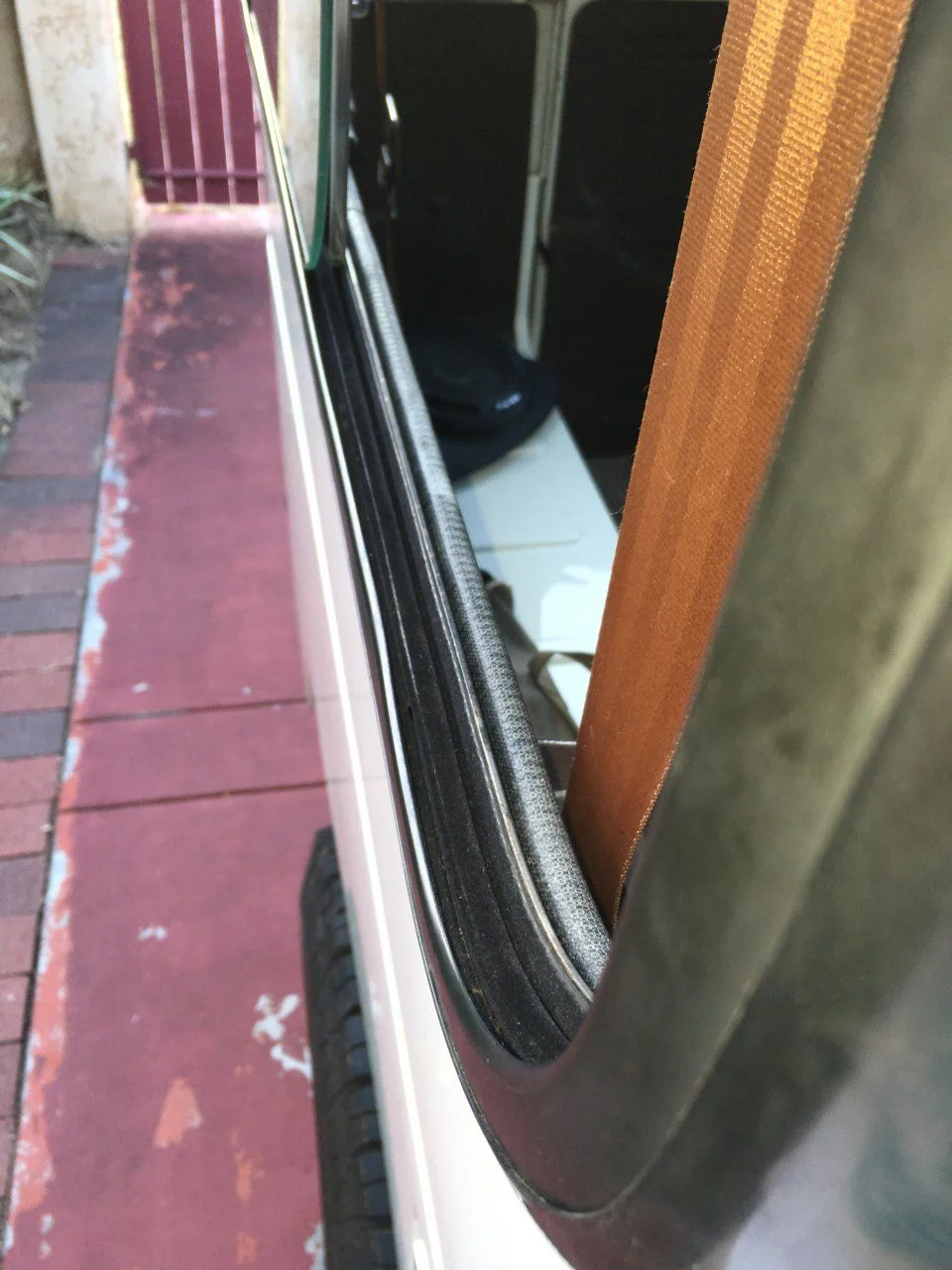

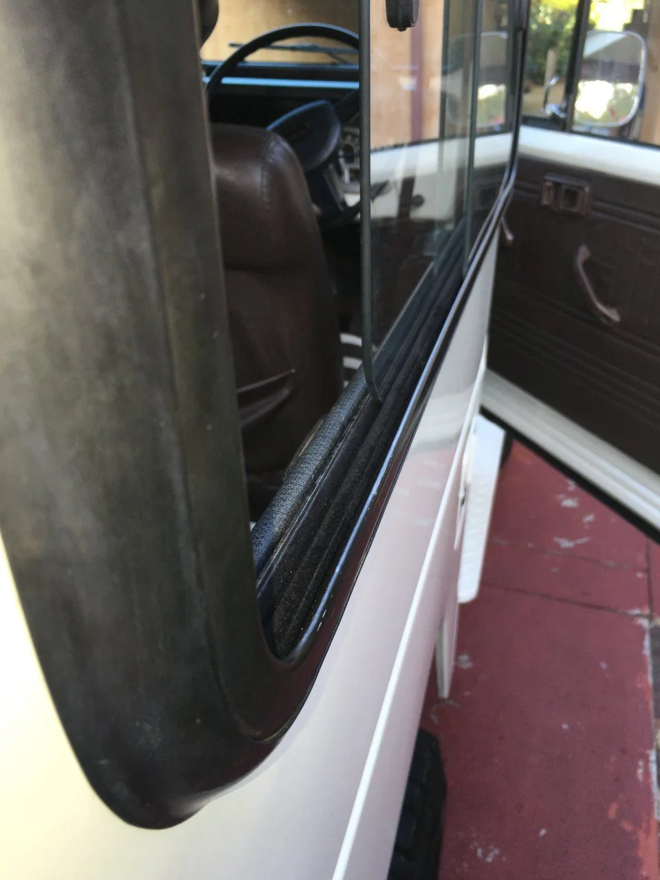

All you do is take off the window handles from the way and remove the old channels by flat screwdriver. Once this is done the glass will lift out easy.

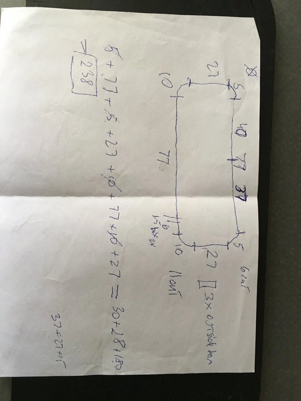

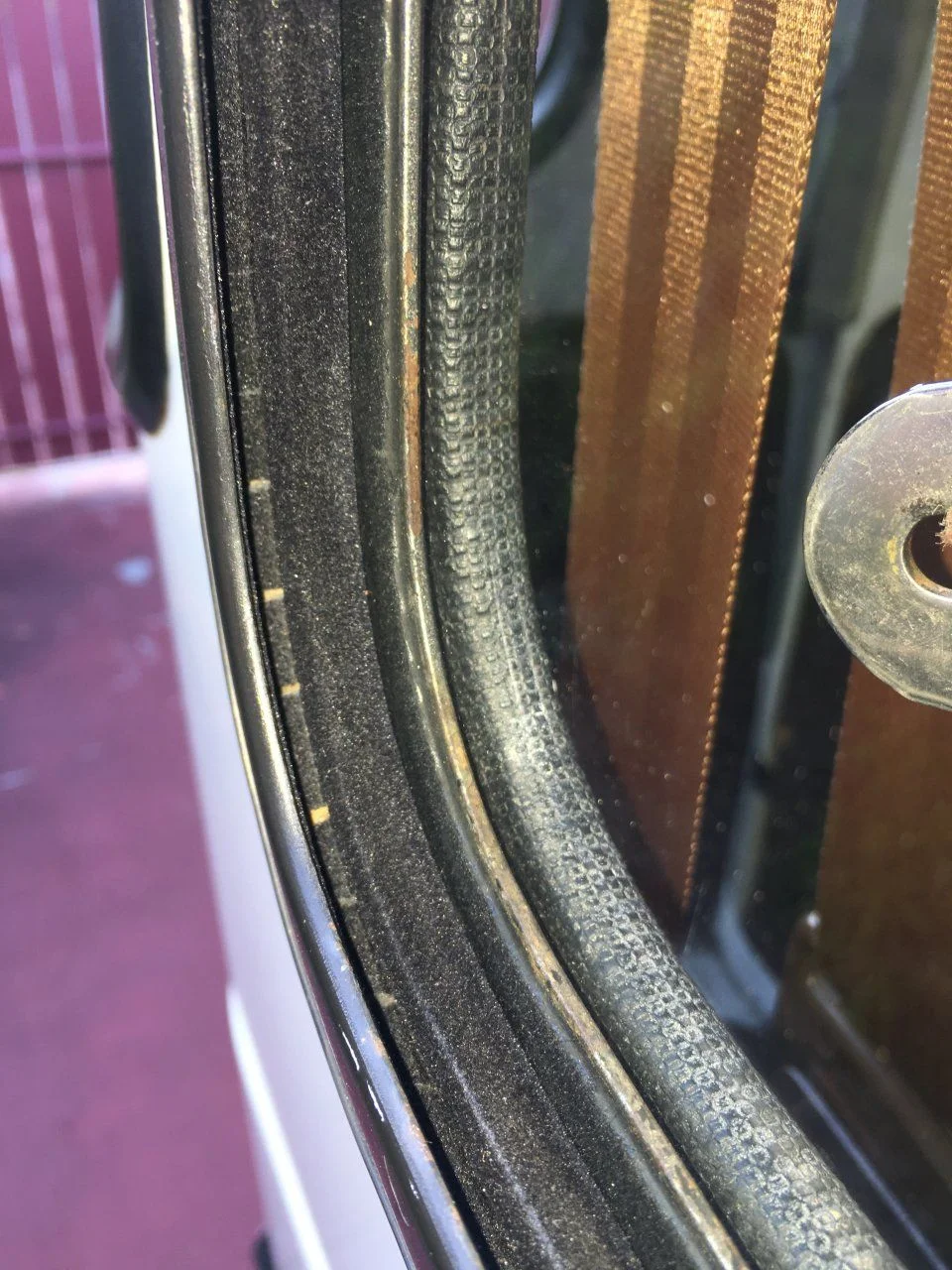

You need thorougly clean both the frame and the channel. I have attached my measurements so cut the baley accordingly and make 10 incisions at the back of the channel for the curves to sit flush.
Start from 9'o clock counter clockwise and when the bottom is in put in the glasses. Use soapy water to get the new baley slide easy and slide over the glasses into the frame on top.
The joining point is at 12'o clock. By sliding the window you gain inch by inch to jam the baley to position.
Once all in place slide the glass panels to centre and use rubber glue in corners only so the channel will fix and stay in place. Reinstall the handles and have a beer!
