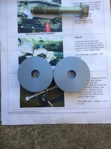

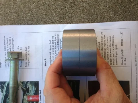

In the middle of the diff drop install and the instructions call for a 65x20 mm spacer for the front diff mount and a 45x20 mm spacer for the rear diff mount. Looks like my kit came with 2 65x20 mm spacers. Anyone know if the 65 mm work on the rear mount or do I need to wait on the smaller spacer?

Looks like 11/2010 instructions call for (2) 65x20mm
Your instructions (3/2013) are the newer ones and call for two different sizes.
Let us know what Slee says.

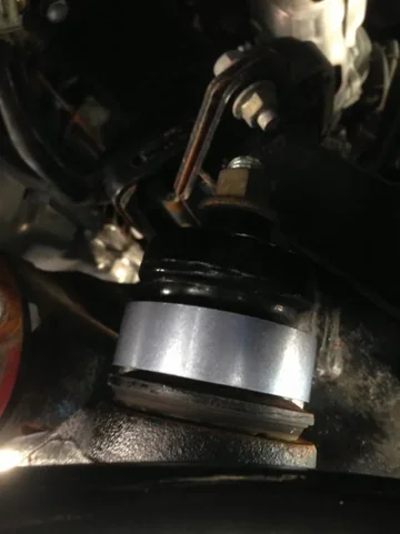

My guess is the diameter was increased to 65 mm. It looks like it fits ok, but would like confirmation it's ok to use the larger spacer, if anyone knows for sure.
There used too be a small and late spacer but we changed it to be the same size. I have to check why the update instructions are not on the site-
