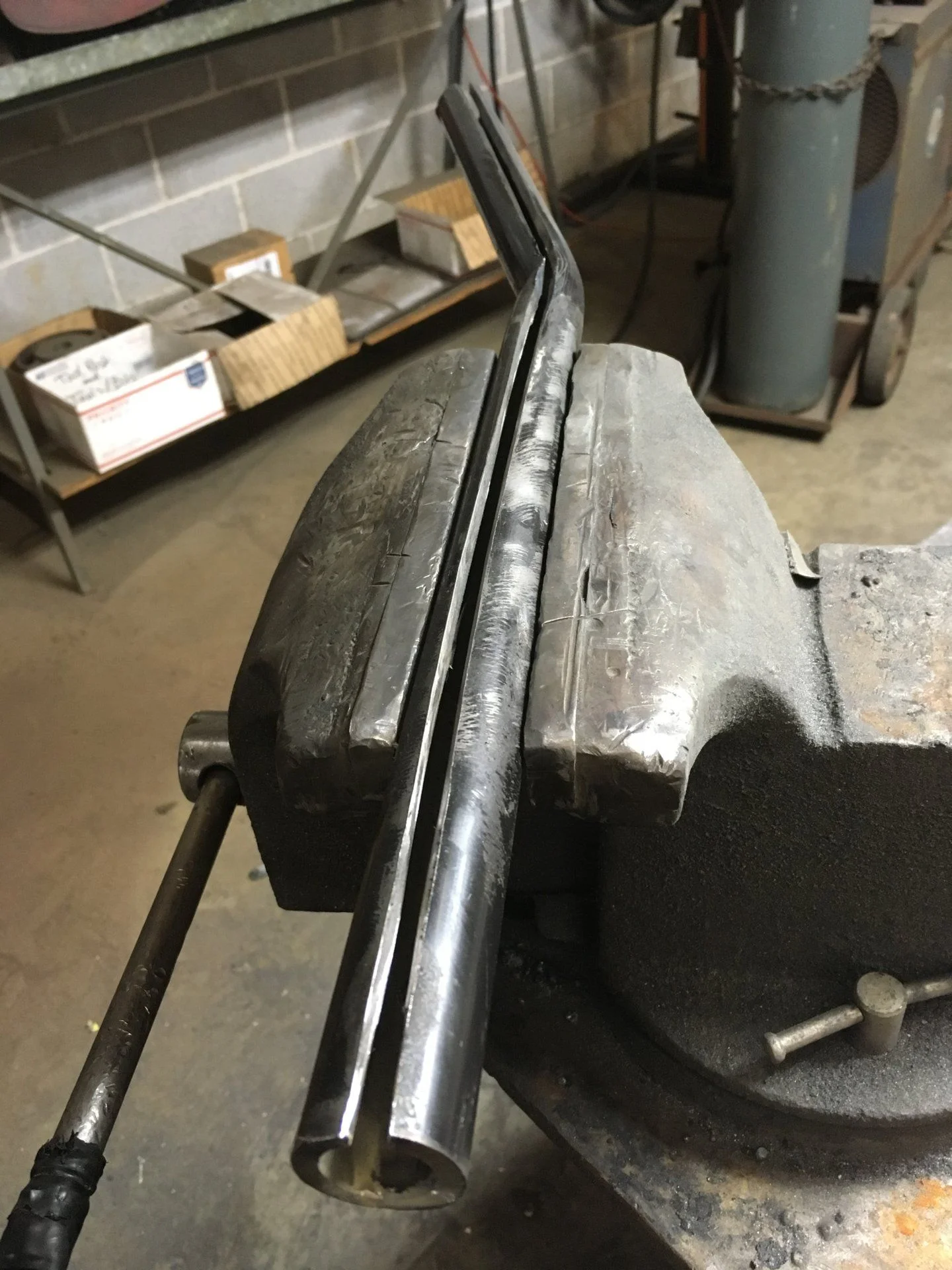

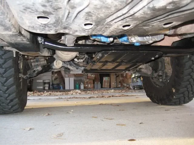

Made my own, incorporating a new cross member, after doing the "tummy tuck".
I did use a Demello steel front piece, from the bottom of the bumper to under the front diff. My new bits attach to the rear of that.
