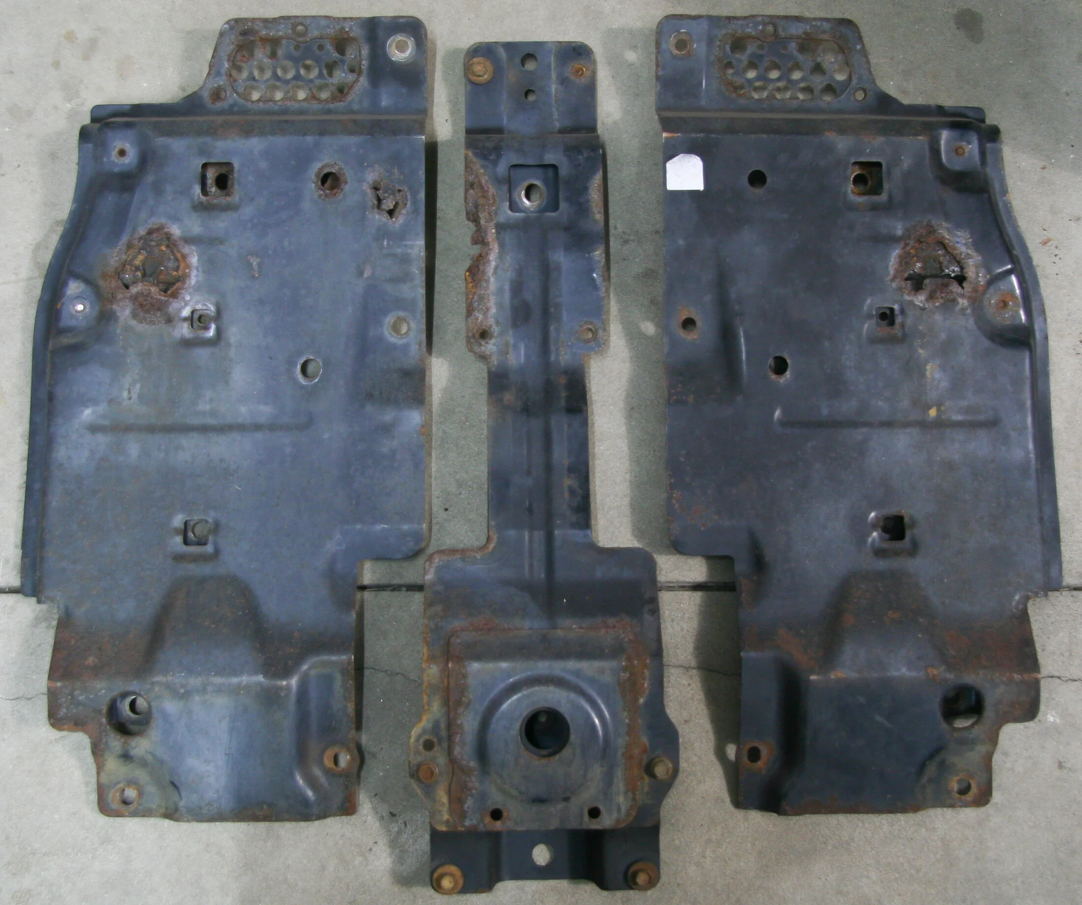

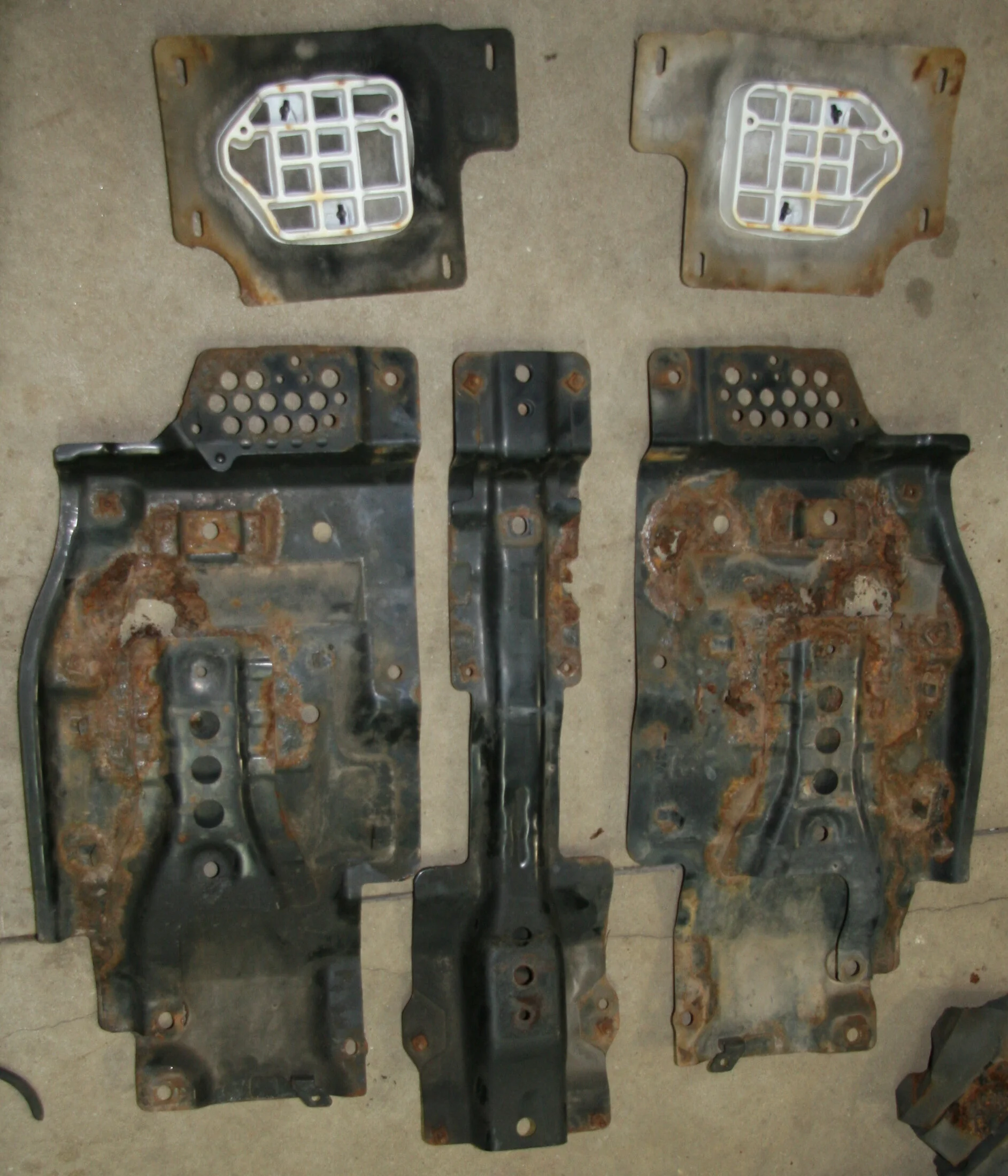

Front skid plate. Bottom view. So much cancer. But the visible bit is just the tip of the iceberg.

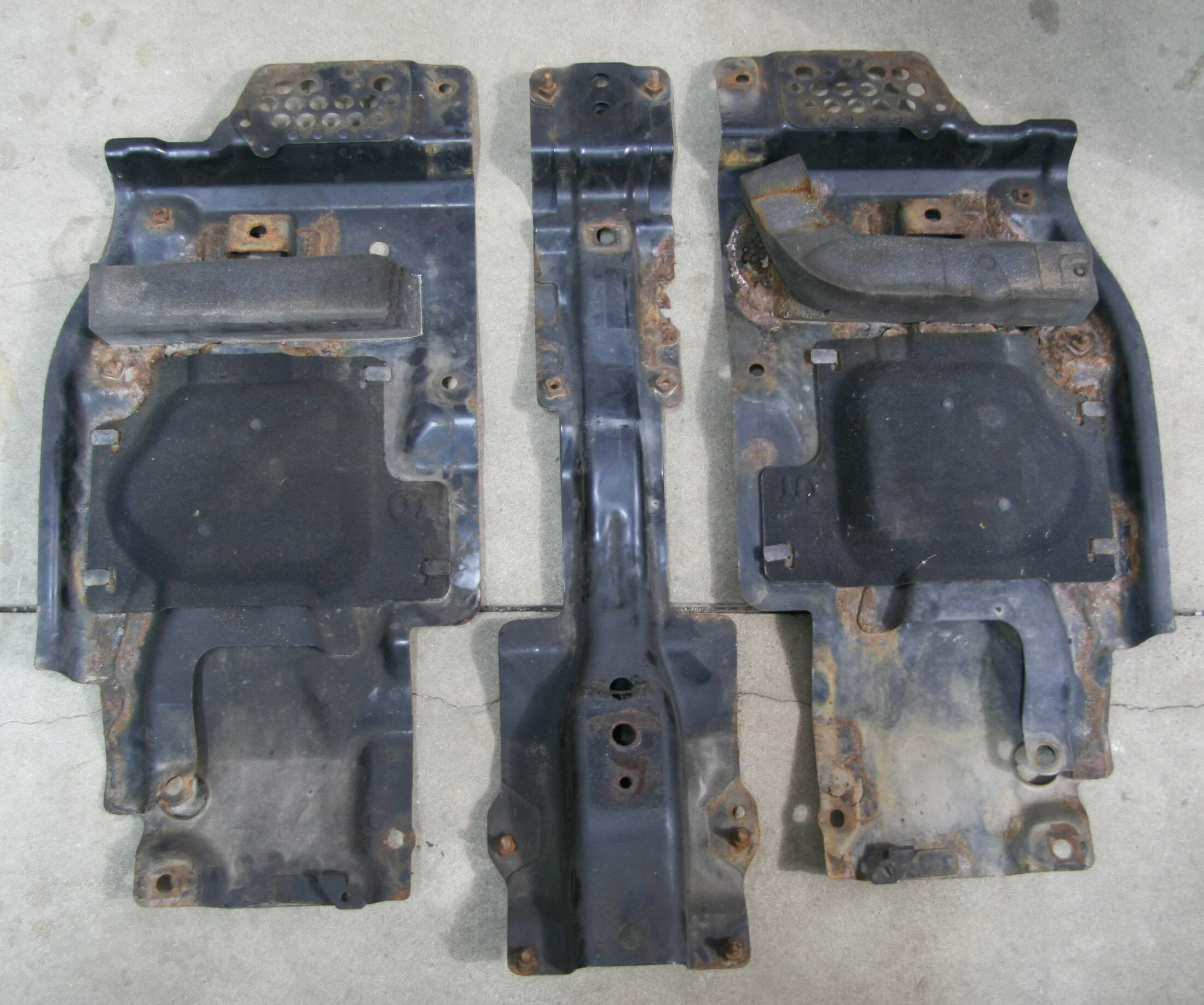

Front skid plate, top view. notice foam and felt on top. Ridiculous. Typically material like that serves to isolate or reduce noise. Why would there be foam on the bottom of the engine? What else does foam do? It collects/absorbs water. What does water do to steel? Makes it rust. It gets better...
...removing the foam and felt pieces reveals the crispy beauty underneath.

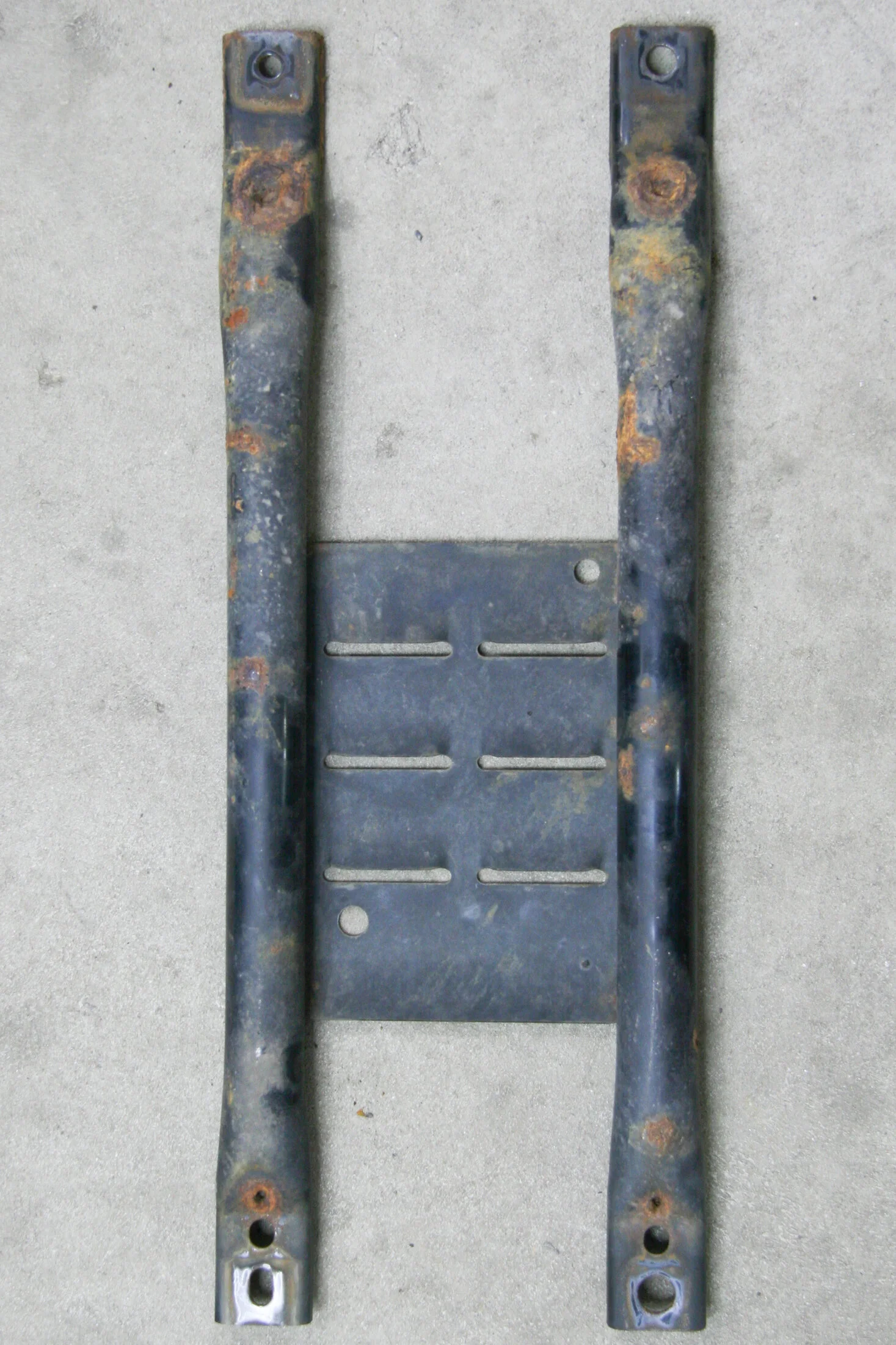

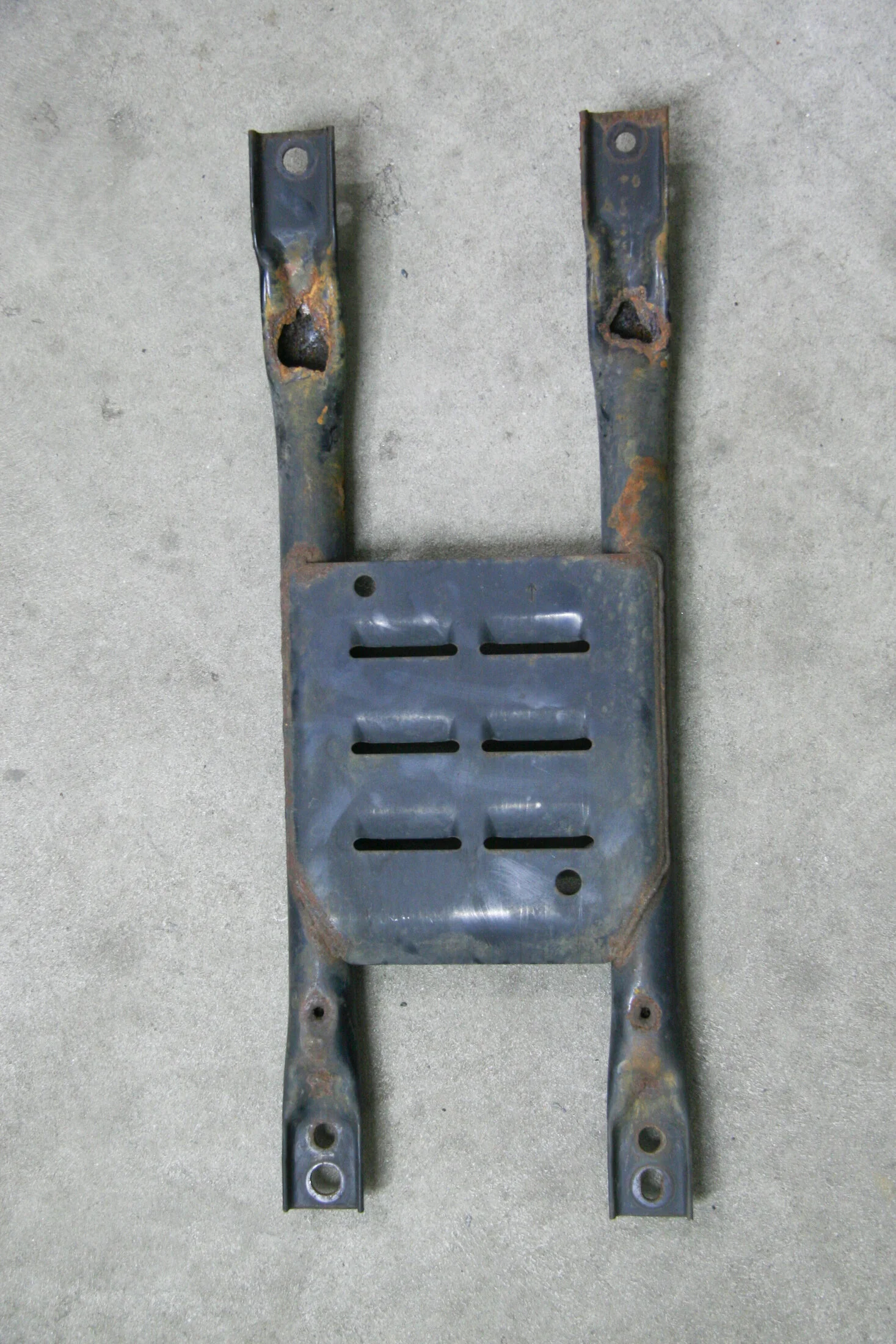

Transmission skid plate, bottom view.
Transmission skid plate, top view.

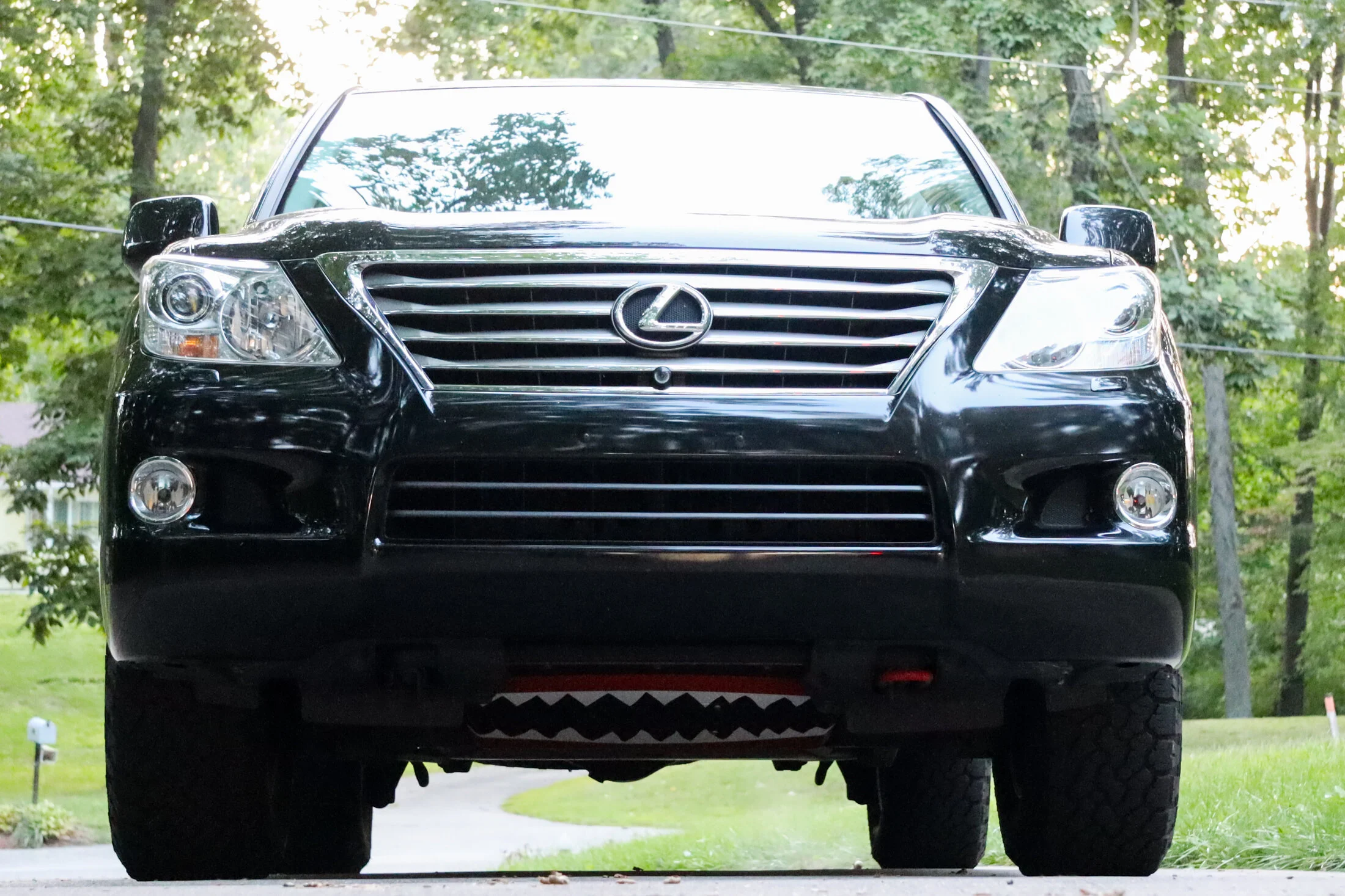

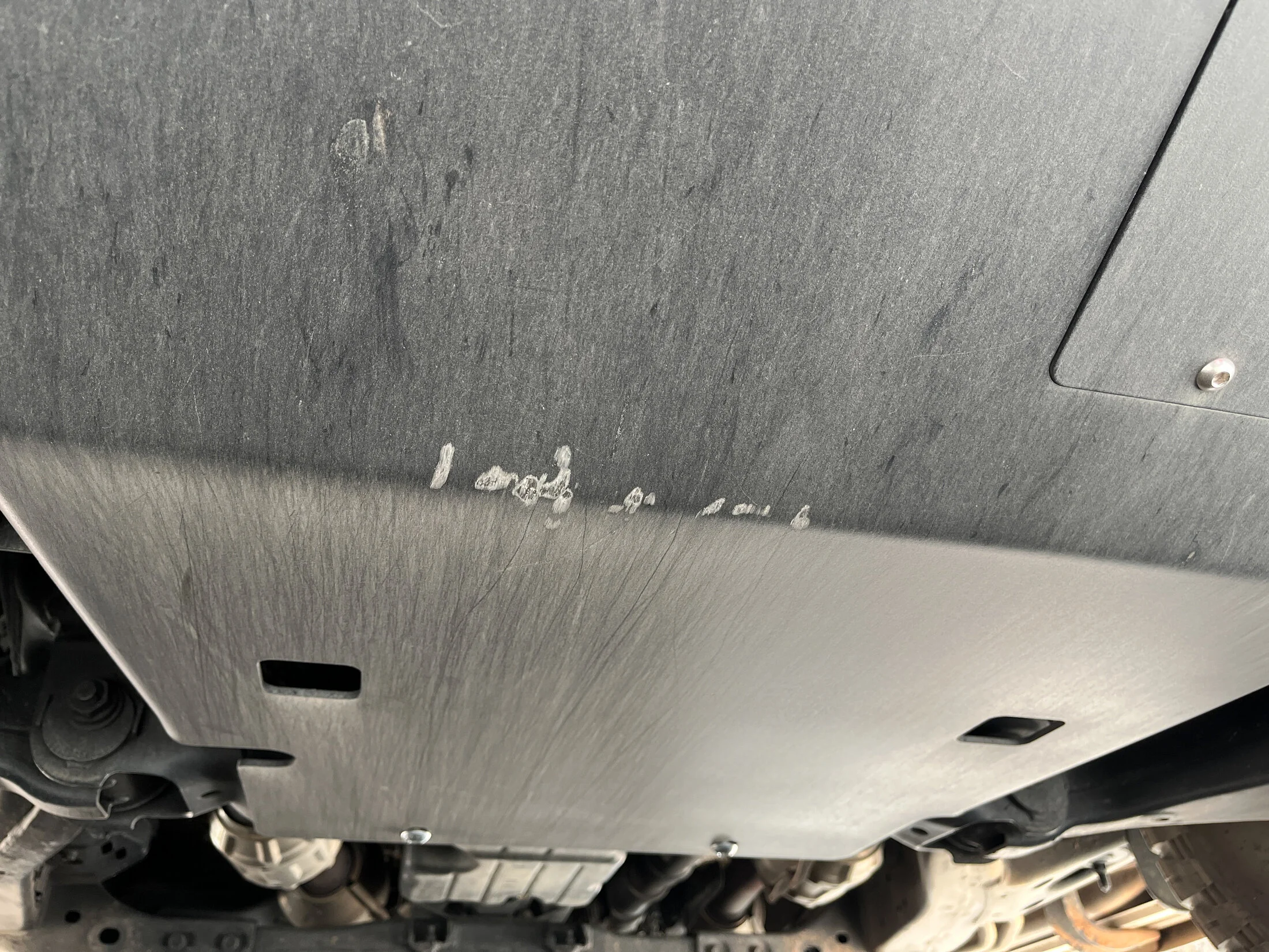

And the appearance from a low, front point of view. Rawr.

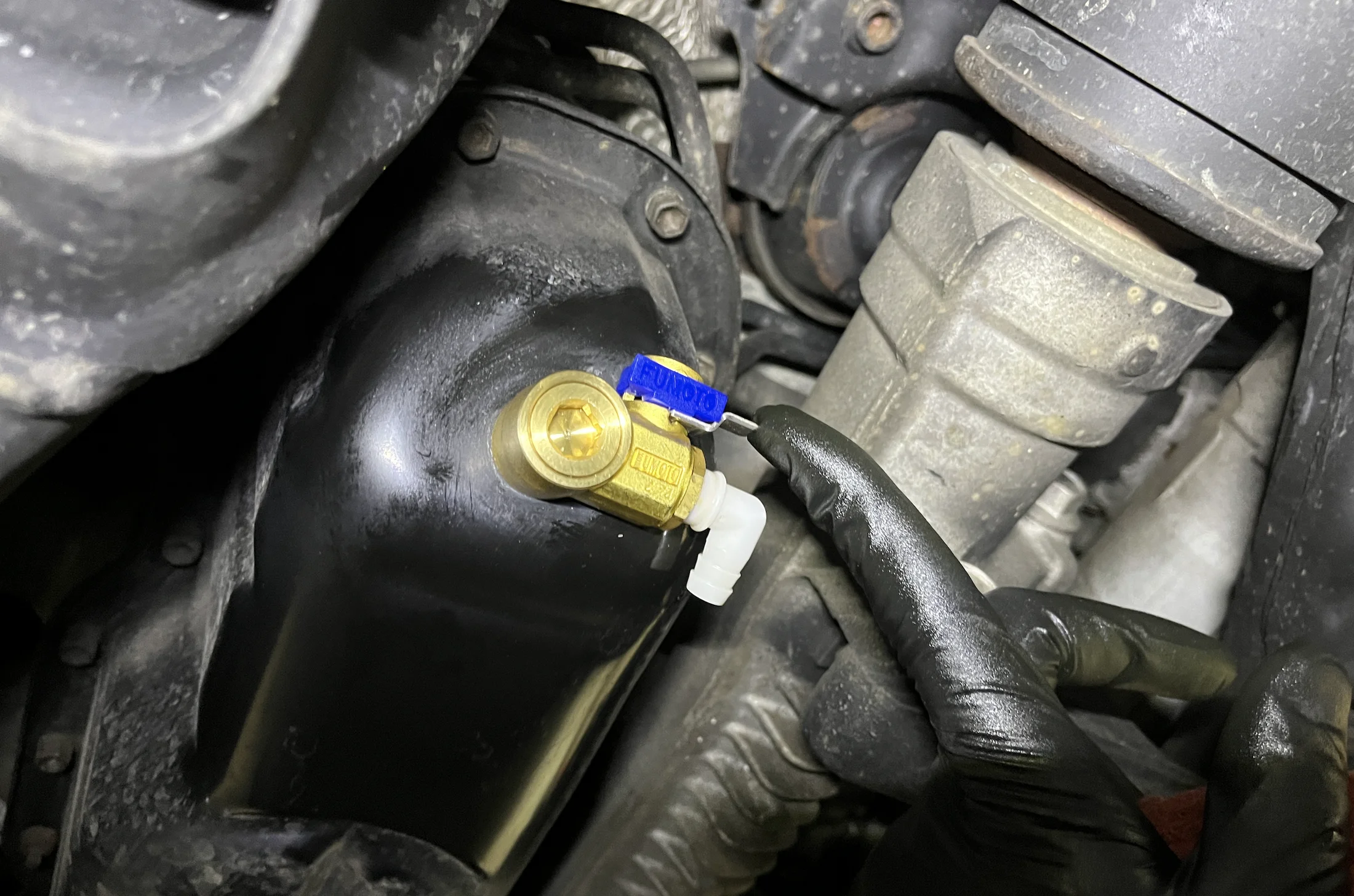

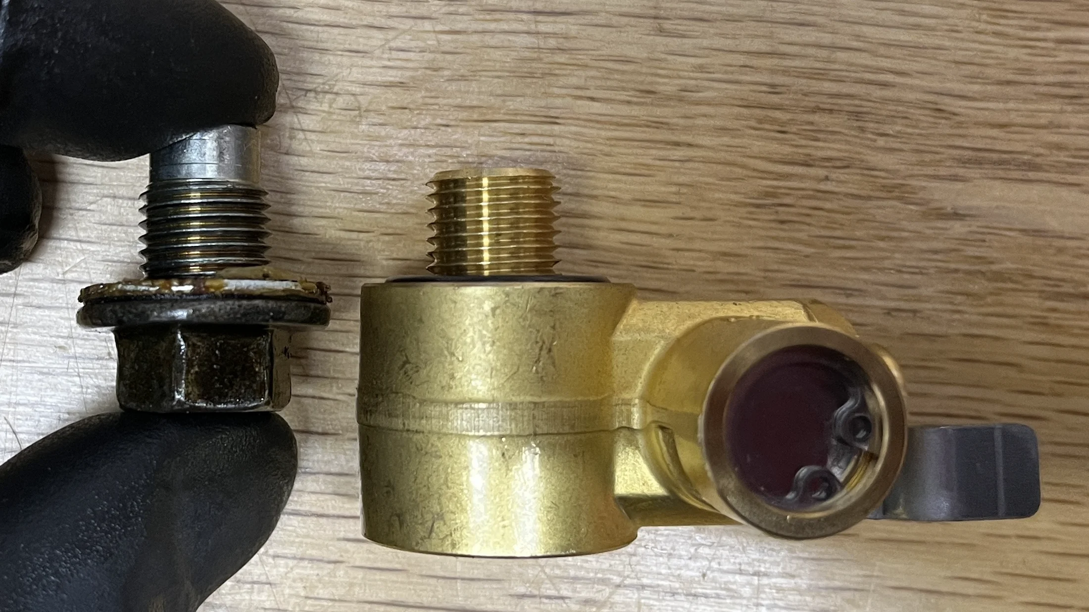

Great question. I haven't changed the oil yet with the skid plates and Fumoto valve in place yet. However, I bought the Fumoto B103SX Position Adjustable Oil Drain Valve. Notice the white hose nipple it rotates 360 degrees to optimal angle. I connect a short pic/vinyl/rubber hose to it.
Here are pics of the two drain plugs next to each other for comparison.
Disassembled.
Assembled.
Here's a video of the valve in action before installing the skid plate. I'll report back on full oil change experience in a few thousand miles.

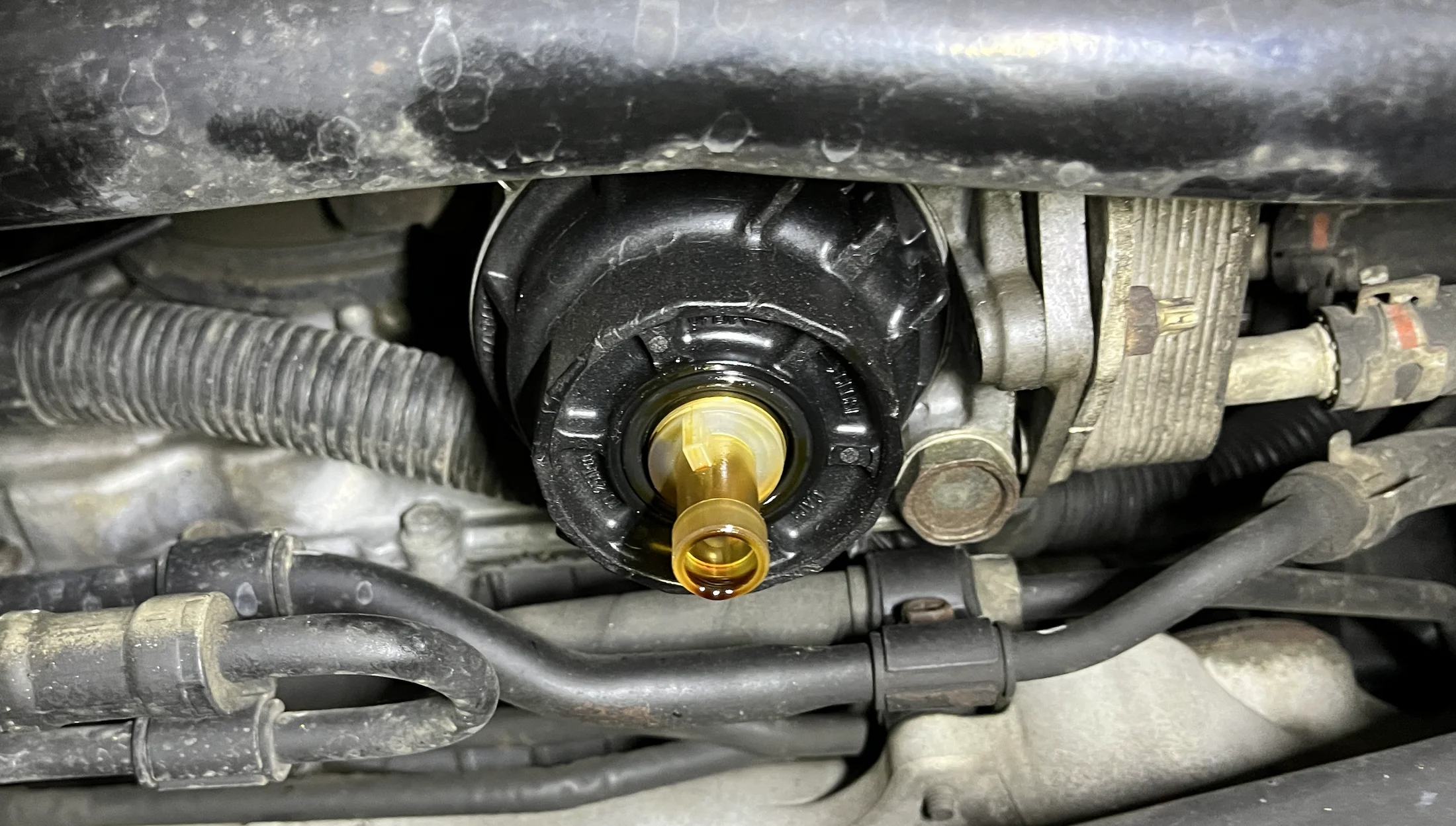

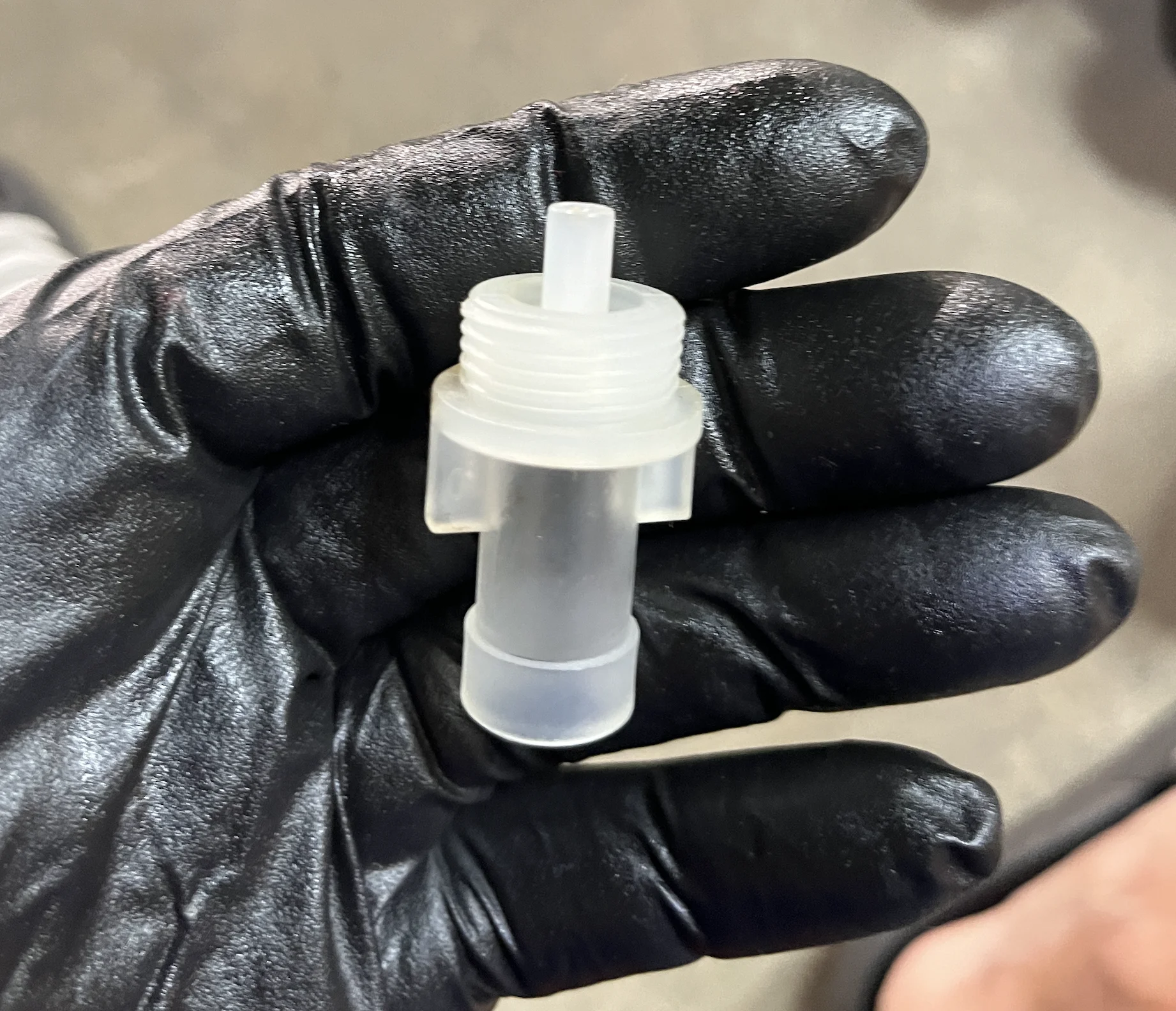

As for draining oil from the oil filter cap, I also found this handy insert that comes with STP oil filters.
It threads into the oil filter cap.
