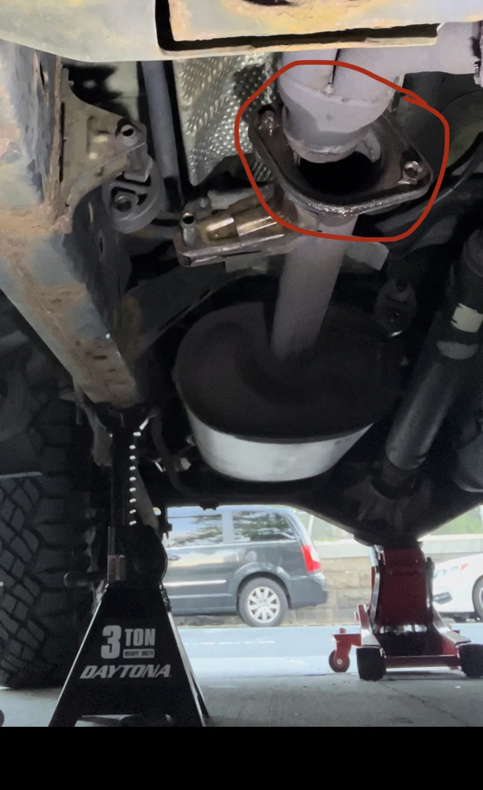

I’ve run into a pickle with my 06 gx470. Whilst replacing the exhaust, I realized that the exhaust flange on the cat side rusted out along with the bolts and broke off the pipe itself.
I’ve got a new catback exhaust going on, with new bolts, but I’m confused on how to best tackle this issue. Based off YouTube videos, I suppose I can buy a new split flange, tighten it with bolts, and then attach it to the new exhaust with my new bolt/springs.
Do I need anything else? A gasket?
Also is the stock front cat pipe 2 or 2.5? I’d like to buy the correct size flange once.
Here’s a picture for reference.
*p.s. the truck is on jackstands, the floor Jack is just extra*
I would suggest taking the GX to a muffler shop and having them re-weld the flange to the Y-pipe, or weld on a new flange It will provide the best repair overall. That area receives a lot of bending/movement between the Y pipe and the cataback exhaust system, so a less-robust repair may fail again. Then bolt your new exhaust to the repaired Y-pipe and flange.

Sadly, I’m back here again asking for your help. I went to several muffler shops but they don’t have that size flange in stock. They recommended hacking it and making me a custom exhaust. I don’t know how I feel about that because if something fails in the future, I can’t just bolt on a new part.. everything must be made to adapt.
Anyways, one of the shops told me to bring them the new flange, and they would take care of the rest.
Does anyone know the diameter of the y pipe where it connects to the catback exhaust? I know my catback is 2.5”, and it’s slightly larger than the y pipe. I’m guessing 2” or 2.25”. I can’t find it online.

You should be able to get the O.D. of the hole through the flange by measuring the I.D. of the donut gasket. It also looks like you have enough of a nub still remaining of the pipe that you could also measure that (and confirm it based on the donut gasket size). You'd then need to find a flange with a hole equal to that OD, and hopefully a bolt spacing similar to the OEM flange and your catback exhaust.
When I got my mid-mounted muffler replaced it was 2.25” piping. Not sure if that helps but there you go.
Thank you! I think you’re right..
Previous owner frankensteined the hell outta the stock exhaust with crappy welds & different pipes so I can’t prove it, but based on what I’ve seen online, the catback is 2.25”
The actual pipe size is 60 mm. Not many place would have metric pipe flange. Maybe got to find it online somewhere.

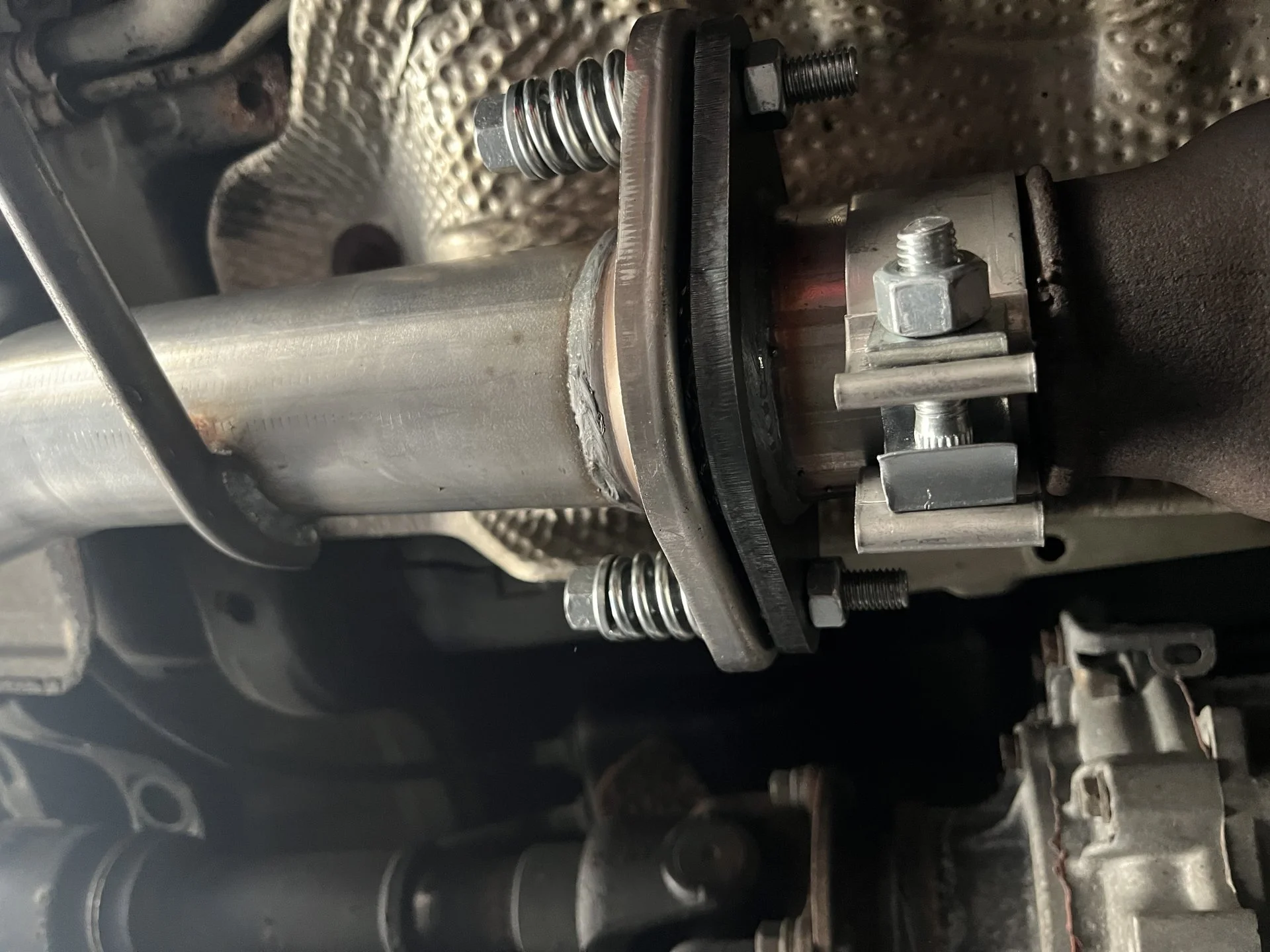

I successfully installed the new exhaust flange yesterday! The nub on the cat pipe was really rusty, but it was still solid so I was able to clamp the new flange.
It IS 60mm like Jstawgn said, but the 2.375” fit just fine. I used the included bolts. As for the catback, I should’ve named it earlier..
It’s the MBRP catback for 5th gen 4Runners.. but don’t let that fool you! It does FIT, but with the new clamp extension, I had to cut a part off the connecting 2.5” pipe. It looks GREAT! Thanks!!
