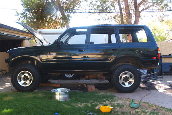

that's the plan exactly! it's obviously a novelty run for an 80 in the
stock full class, the plan is to finish, not try to race $100k rigs. i ran
the 500 coarse three weeks ago in my trail rig full of gear and
averaged 26mph ( that would be 3 hours under the limit ) now i know
there is a huge difference between pre-running and the actual race i
just mention it to illustrate that the rig at least is capable of making
the time limit...

the diet is coming along well, about 400lbs so far. stock full rules say
no lighter than delivered so the plan is to try and remove enough
weight to make up for 90 feet of 2" dom going in. as far as suspension
as long as those lottery tickets i picked up come thru i'll be running
2.5" three tube bypass shocks on each wheel...

i'm with you here as well. i going to run a 33" tires (so the bump stops
can stay were they are) and a modest downey lift that will hopefully net
me 6"up travel 4"drop up front. also i'm trying to get as much weight off
the front as i can by removing the the ac system and relocating the
batteries to the back
me 6"up travel 4"drop up front. ...
May want to think about this a bit more? Normally I would agree with a slightly smaller tire for fast stuff, but this isn't a normal racer. In this case, by going with the 315's you gain some unsprung weight, but the rig already has a ton of it? The advantages are; the larger tire will drop into less holes and make bumps, steps less harsh. More sidewall will work as "rubber suspension" on a rig with less than ideal travel I would bet that the bigger tires would make for a faster, more comfortable rig. 315's are very close to clearing on a stocker, with some "sledge hammer to the fender wells" mods I bet they would clear.
Why downey springs? I have no experance with them on an 80, but have put some on runners and wasn't impressed? They were relativly short travel (iirc shorter free leingth than the stockers) and unseated easly, even with only slightly longer than stock shocks.
How do they determine "no lighter than delivered"?
285/75/16 is the size the Araco Dakar 80's ran and the same size tire Ivan Stewart ran on his 80 pre-runner so i was using that as my starting point. i got my 33" rubbing when i bottom out so i was a little hesitant to go much bigger, although like you say a little persuasion could probably make room.
i decided to try the downey springs after talking to a Allen Russell (who has run them on his pre-runner 80 for years) and John Ray (who built Ivan Stewarts pre-runner) i've got them in and i'm getting an 1.5" more drop than stock and about the same as on the OME heavies. most of the guys that i have talked to feel they're softer than the OMEs but the rig will hopefully weigh about 700 lbs less than my trail rig so i'm hoping they fit the bill.
as far as weight i think the only time you would only be put on a scale if you were protested, but i don't know for sure.
i took your advice and had my new Nitto's mounted up on my stock rims.
only seventy four pounds mounted, me likey...
the jenny craig racer...

ok weight loss program complete, total of 812lbs have
come out of the beast. biggest surprizes so far...
a single middle seat ways as much as both swaybars
pulling the ac, heaters and blowers netted 70lbs

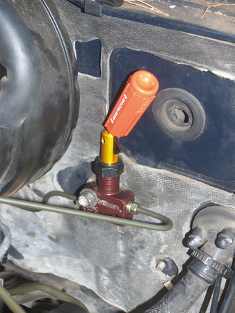

ran new brake lines today eliminating the ABS and the LSPV
valve in back. I put a brake proportioning valve inline up front...
...i also installed a longer braided brake line in back but still
need to do the front lines.
