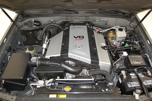

Here's a picture of what the timing belt sticker looks like (not on our vehicle but you get the idea):
(Picture copied from here:
http://www.google.com/imgres?imgurl...ge=2&ndsp=35&ved=1t:429,r:19,s:36&tx=81&ty=42)
in this picture it's on the v bank cover but iirc the sticker says to put it on the timing belt cover (can't remember whether it said to put it on the no1 or no2). I guess people put 'em in different places.

I have the same sticker located nearly in the same spot. Has date, mileage at the time, and "timing belt" written on it.
Same here.
Mine is in a little different spot, and my engine is a little more :hhmm: "seasoned" looking too but figured the pic would be better than my description:
[/IMG]
Mine is on the engine cover. It's the little rectangle about dead center of the photo.
