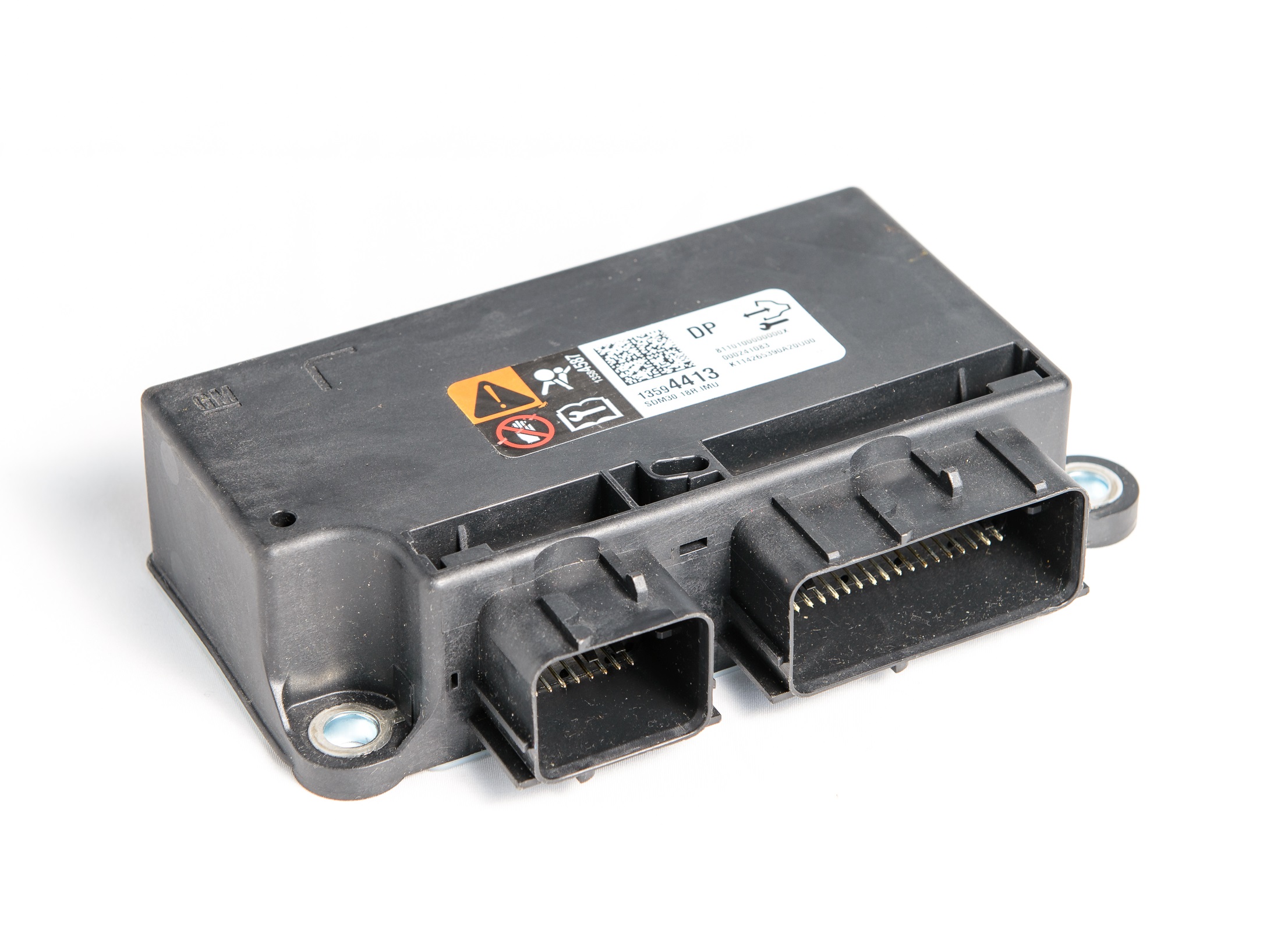

There are places in the US that will reprogram/reset airbag modules inexpensively, I'd imagine there is something similar there.

These guys are local to me and a friend uses them, albeit not lc/lx specific. $49

Your Airbag ECU only ever makes one decision. Once decision is made it must be replaced. However it needs to see a signal from all airbags. So unfortunately in the event of a frontal collision your airbags will not deploy.
I recently saw a video where a Lexus GX driver was slowly wheeling off camber and one of the side airbags deployed. Then a few seconds later, when the vehicle pitched to the other side the other side airbag deployed. This implies the ECU continues to monitor after the first deployment. I will link to the video if I can find it again.
