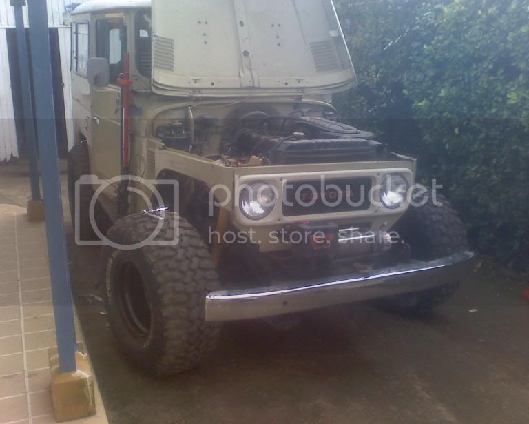

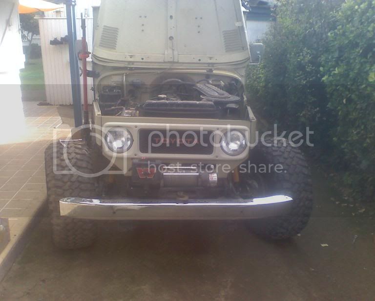

Lots of nice ones posted. Here's the one I am working on. Still needs the tubing bent and installed. Will have a Warn 8274 mounted to it. I did press a square tube into the top above the bumper mounts for more strength.

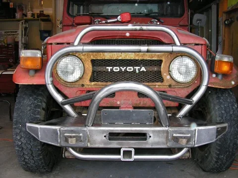

here is mine... nose guard and stinger from metal tech... rest i add in is the winch plate and bumper... all removeable from the frame ...
Metal-Tech tube work, 5/16ths 2x4, welded up by Poor Wally in VT.

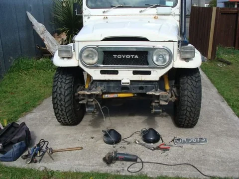

Here's mine just taken off the farm gate that was welded(badly) to the bumper, and took an old warn patrol bumber and the most beat origanal bumper i've seen straigtened it cut the top out and welded the two together, next step is to put some of those T slots in for the hi-lift to fit. It was all nice, shiny, and pretty for around two hours then I trashed it:bounce:

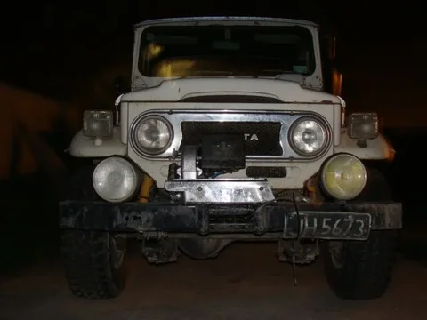

Note left of pic... he came out from the scrub completely invisible until it was to late. A serious bull bar is an absolute must for outback travel in Australia.
The bar cost me $100AUD on ebay. Needed a good clean up, 400/600/800/1000 wet and dry; now she looks new again.
Its taken 2 hits this year, still doesnt have a single dint in her. Fair to say its well and truly paid for itself.
