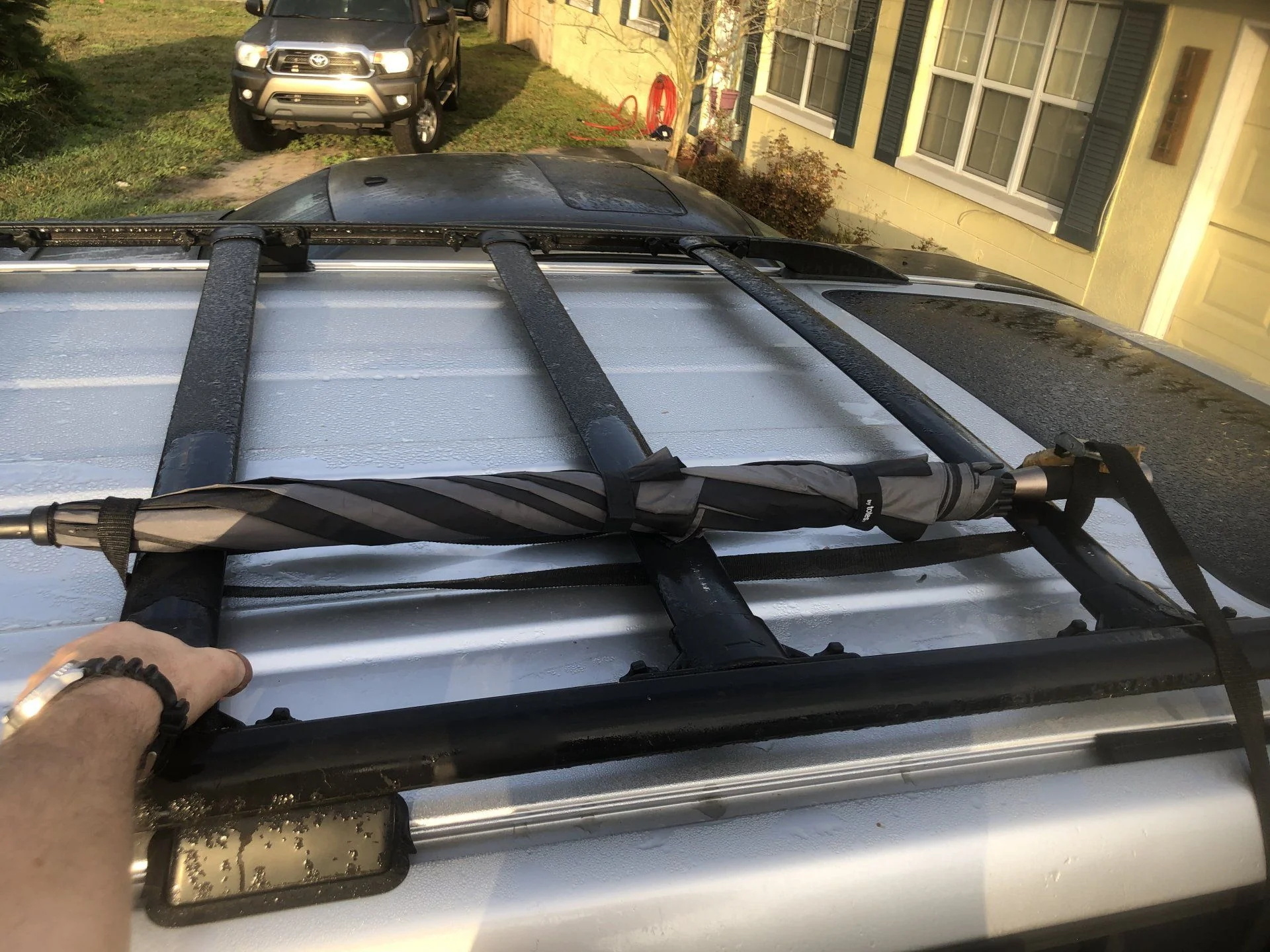

You can mount it with a basic cam buckle strap if you’re just looking to store it there on a trip. I don’t like the idea or complexity of permanently storing anything on the outside of the vehicle. I’ve used the attached method to secure kayaks. It’s solid. Easy cheap and quick too. Works w max trax, shovels, etc.
@highfructose I'm not gonna lie to you...seeing an umbrella strapped to your roof genuinely just made my day...solid idea on the straps though
