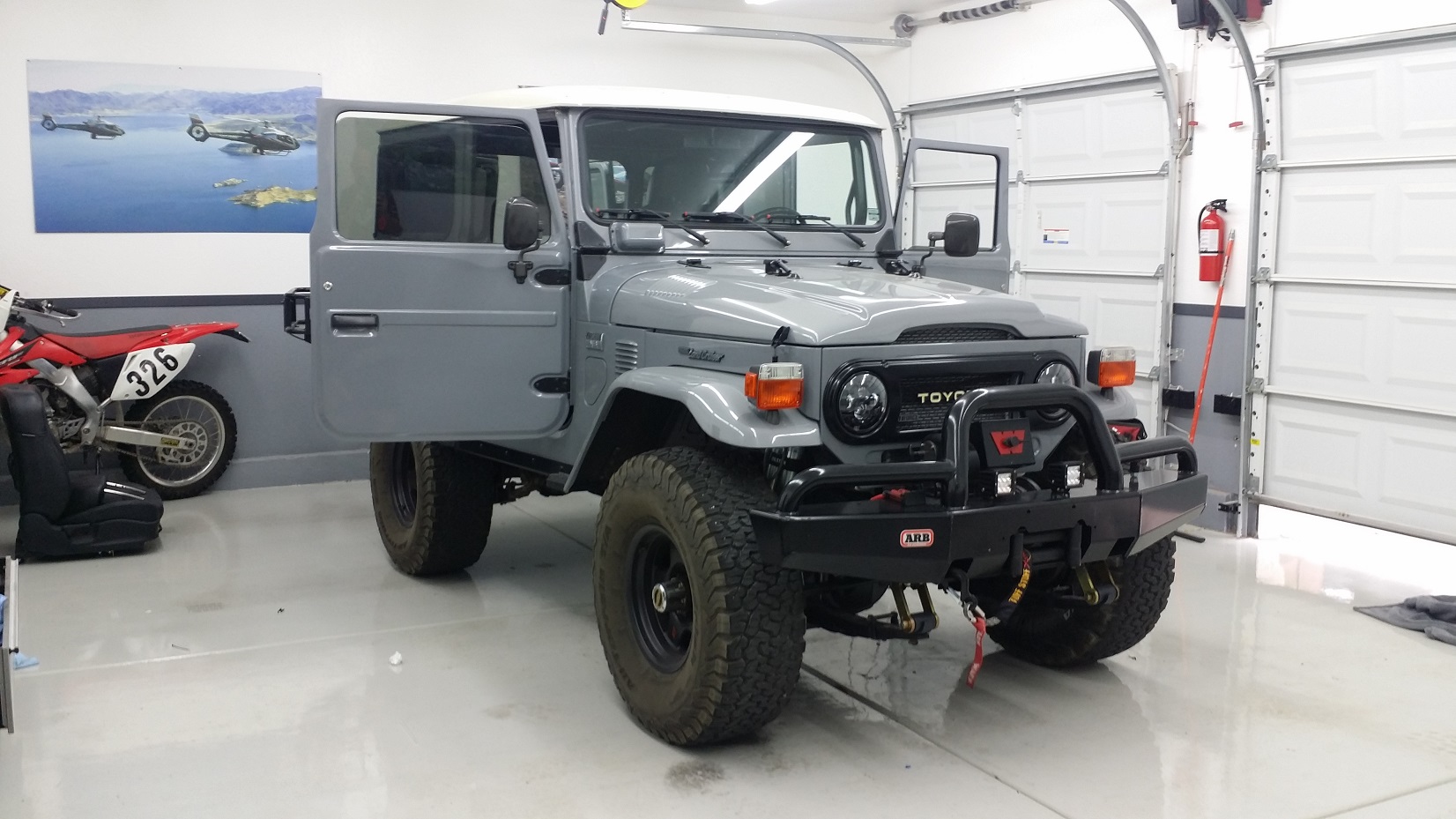

Went from 2 builder grade lights to 36 4' T8 bulbs, housed in 9 8' fixtures for over 100,000 lumens. Gloss light gray epoxy floor and semi gloss walls reflect the light around! 3 car garage, around 600 sq ft.

Jetranger: 100,000 lumens in 600 sq feet! That is super BRIGHT!

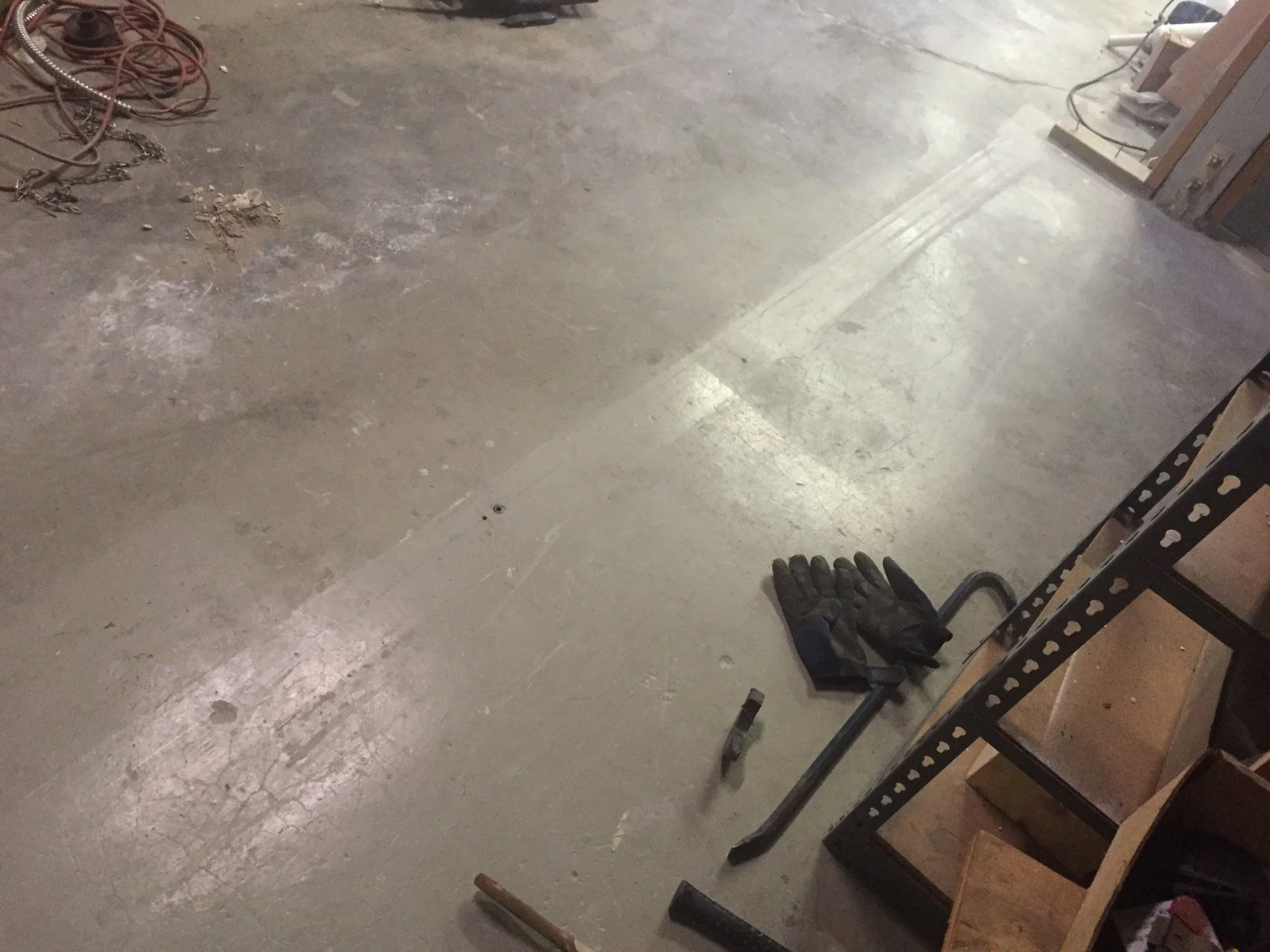

I spent three months scrubbing machine shop oil from the PO off my shop floor before painting it in light gray epoxy. It WAS nice. I posted a pic in my warehouse fire thread that shows the one intact part that was preserved under the front counter.

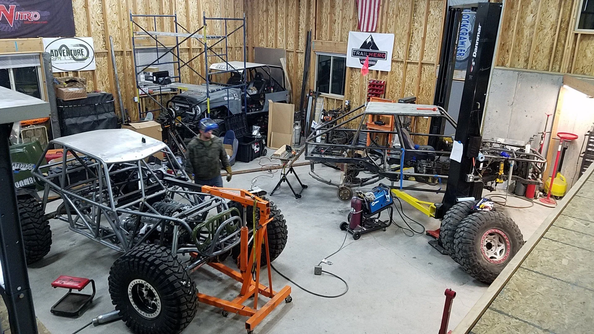

Night shot from a couple weeks ago - E and W walls have 5 fluorescent 2-bulb fixtures....center has 3 fluorescent 4 bulb fixtures...all have ballasts removed and are running bulbs from Lifetime LED.
Walkway also has 5 2-bulb LED pullchain fixtures from Costco....will be adding one or two more in the sink area too.
Light coverage is excellent, and once the ceiling gets finished off (insulation is done, metalwork next) it will be even brighter.

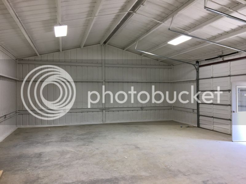

In my new shop, I was going to put in LED's from the get-go, but the electrician was adamant that these fluorescent banks (four tubes per bank) would give better lighting, so I went with his recommendation. They seem fairly bright, but I have lots of outlets for task lighting too, and the 2-post lift I'm installing will have daisy-chain task lights that can plug straight into the lift. When the fluorescent tubes fail, I'll likely replace them with LED. Also have epoxy coating for the floor scheduled, which should reflect some light too.
