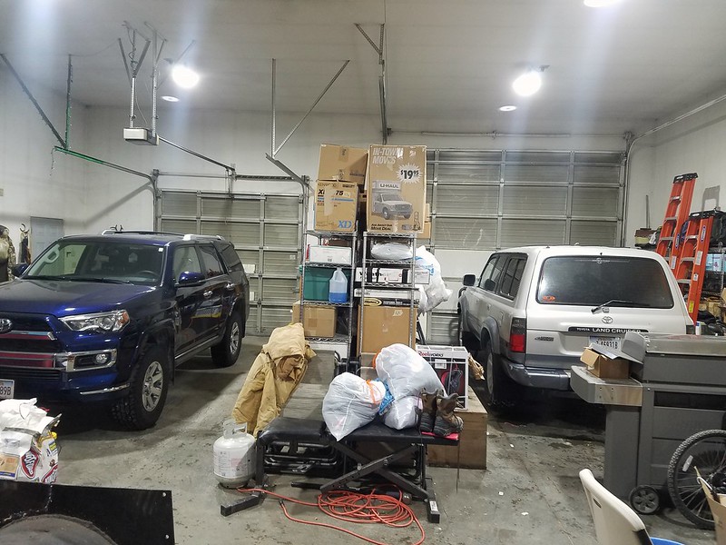

So these may not be the best choice for some of those larger high-ceiling shops, but these 4' LED shop/task lights are working really well for me in my three car garage. My ceilings are 9'. They are flexible enough so you can add up to six lights on one string and put them in nearly any orientation. If you need you can unsnap them from their mount rearrange them as needed. A six pack of the from Amazon run about $55. https://www.amazon.com/gp/product/B01MUAX40D/?tag=ihco-20
It's actually brighter in the garage than the pictures show.
