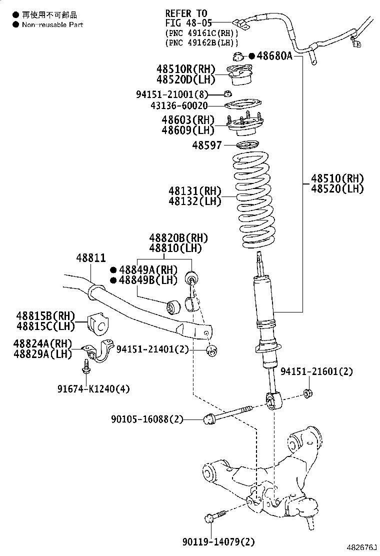

I have searched and searched but cannot find a "how to" thread on changing LX shocks. Can someone please point me to one if it exists?
TIA
Also my mechanic says that the struts, mounts and brushings need replacement. So all these parts above the spring? Are these typical wear parts?
It’s no different than LC, except for depressurization of the hydraulics (bleeders near the accumulators) and disconnecting the lines at the top of the shocks.
