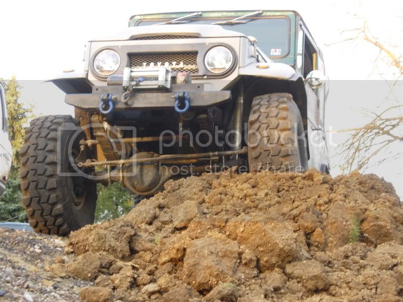

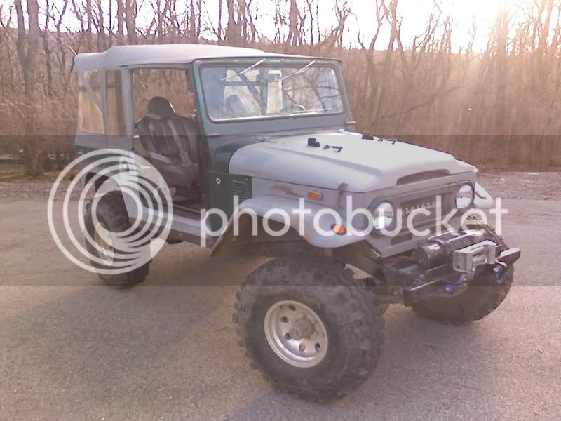

An old pic already...
Will be so good to get 'er painted one color, then it'll be more photogenic: will do, soon as it warms up a little more.

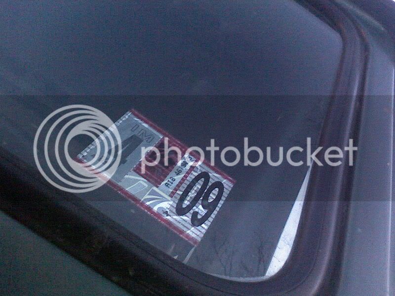

where is the other sticker?
I thought that penn hills was still in allegheny county therefore needs emissions sticker.
If its exept it still needs one right?
Anyway now you dont have to trailer it:bounce:
I thought that penn hills was still in allegheny county therefore needs emissions sticker. If its exept it still needs one right?
Penn Hills hasn't moved: still in in Allegheny County. :flipoff2: (though i wish it could move!)
It is exempt, but I don't know if it needs an "exempt" sticker?? My inspection guy said "it's a 70 so you don't need emissions," but now that you mention it... I'd rather be sure so I don't get ball-busted.
Guess I'll check into it further.
The "IM" above the month number will usually tip a cop off if the vehicle needs an emission sticker.
If the sticker has nothing above the month nuber you would not need a sticker but that would meen that you moved to a different county.
I am exempt due to not putting enofe miles on a year but I still have to have a sticker.
Year of the vehicle does not matter only if its got a classic or antique plate on it.
It has the "IM." I talked to the guy and he said it was the wrong insert, but that it happens all the time so NBD. He said that pre-76 it's all good.
My only remaining concern is it being PC to pull me over & pick at other things on the vehicle... oh well... happy to have what i got.
Gratuitous shot from the meeting last night (but hey it shows the sticker, so it's relevant to the thread, right?!)...
