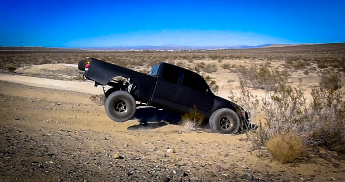

Why not? Been trying to break the 1.5" spacers in the rear for years but no luck.
Spacers and 2 piece wheel adapters are very different.
Let's talk apples to apples. His is looking to use 6x5.5 wheels on a 5x150. You are using 1.5 single block alum spacers. Totally different.
I don't even know if 5x150 to 6x139 is even possible because of the hub size, but now we are talking in general about adapters vs. spacers.
Spacers bolt to the hub and the wheels bolts to the spacers, just as how one-piece adapters work. Please explain to me how these are functionally "very different."
