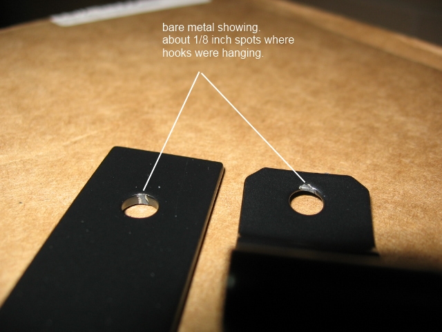

The other thing that's really bothering me is that every piece has a bare metal spot where it was hanging from a hook when it was coated and cooked... I realize that the pieces have to be hung up to do this but it just seems like something would be done to make sure that everything was completely coated even if it meant having to do it once then move the hook so you could get that spot coated and cook it again.. I know that would be more work for them but it seems to me that the whole point of paying a premium for powder coating would mean that they would make absolutely sure that the whole part was completely coated with no bare metal spots left for rust to begin again.

thanks for the reply. I talked to the guy that did my stuff a little while ago and voiced my concerns about the spots of exposed metal where the parts where hung on hooks. He is trying to tell me that is just how it works because the powder can't get where the hook is touching the metal. It just seems to me that they would use a really thin hook on parts that are smaller and light weight because most of the spots on my stuff is 1/8 inch or so wide. To me, this just seems like an opportunity for moisture in the air to start causing it to rust again. His reply to that is that it shouldn't be a problem and that if that one little spot does rust, then it will not go any further because the powder coat is 'bonded' to the metal so it will not 'spider-rust' underneath the metal like can happen when paint is chipped or scratched.. I don't know if I believe this is true or not? I just want to make sure I'm not getting screwed with a bad job. It just seems like if this really is 'just how it is' with powder coating, then after it is baked, then you would move the hook to another spot that is already coated and then put powder on the spot still exposed and bake it again.. obviously this is more work, but if you are paying a premium for powder coating, I would thing the whole point is that the entire part is COMPLETELY coated. Did your parts have any exposed/bare metal showing where the hooks were?

Parts had exposure. Very small tho. Anything that accepts a bolt is a different story. The coater should install a bolt and hang the part from the bolt. Plug any holes with a cork like substance too. At least that is what my guy did.
I am curious what he is charging you and what parts. IIRC the hook was moved when coating. Then baking:hhmm:
Remember, choosing your powder coater is just like choosing any other service provider. You usually get what you pay for.
When a coater doesnt even care enough to attempt to find ways to hang things so they dont leave hook marks, it's time to find a new coater.

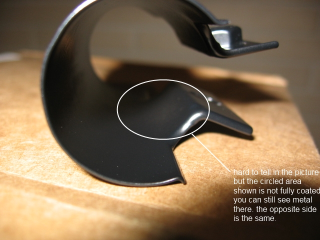

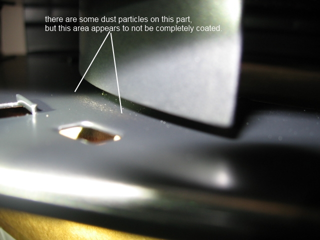

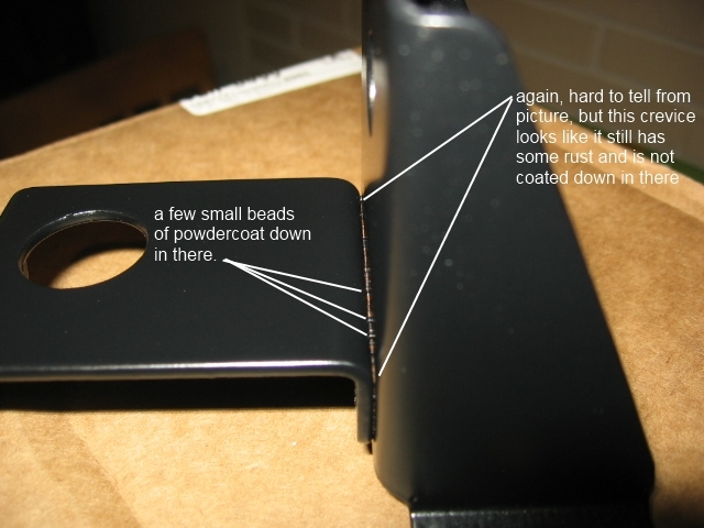

As far as the two pieces of sheet metal that come together and powder not being in there- it depends on how good the applicator is at 'faraday cage' effect, where powder will magnetically bounce back off because of all of the positive and currents shifting about... It could be lack of professionalism, technique, or just a crappy coating job.

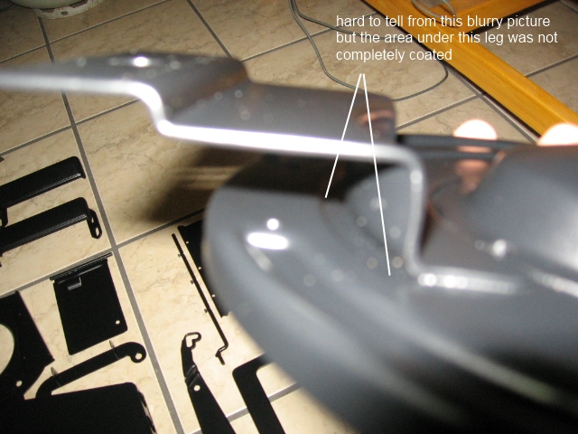

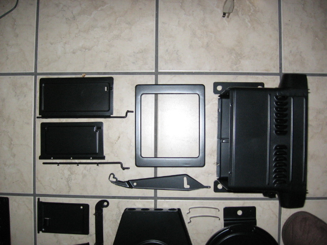

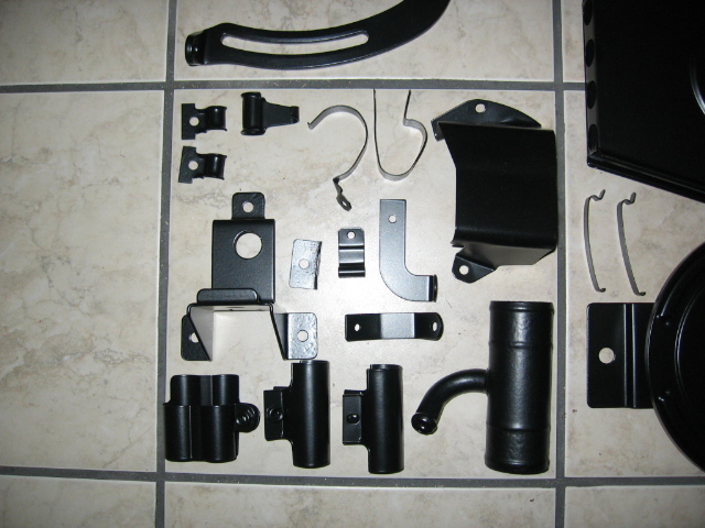

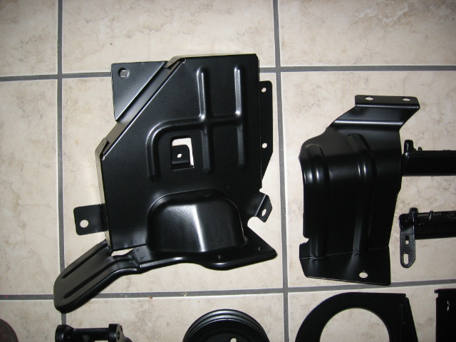

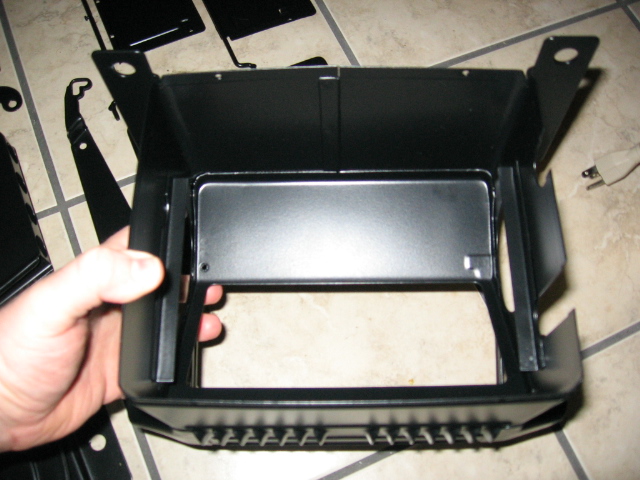

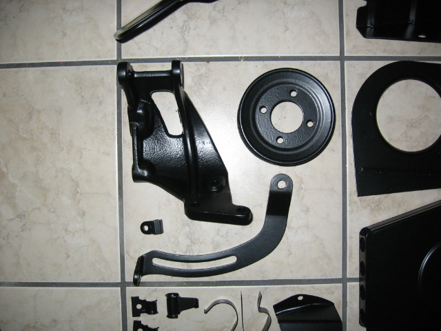

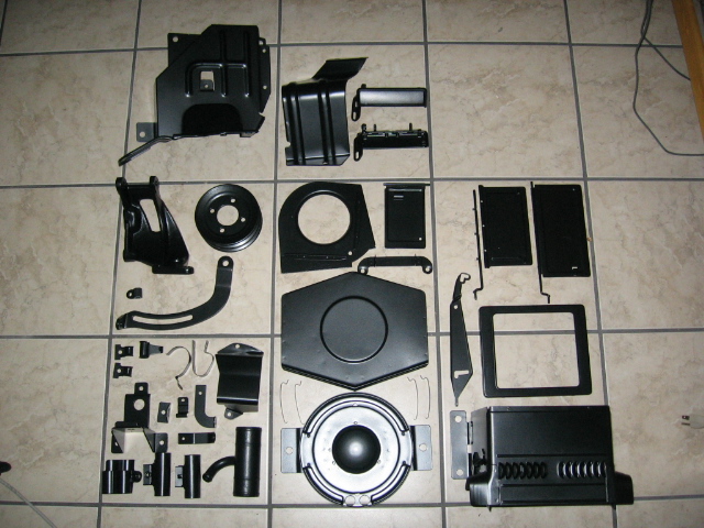

ok, so I got all my stuff back from the powder coater and finally got some pictures taken of the stuff. It was really hard to get good pictures of the parts up close but I did the best I could. You can see the bare spots where the parts where hung on hooks and every single part has these bare spots where they were hung... there are also a few spots where parts just didn't get completely coated... usually inside a tighter place like the inside of the heater hose pipe covers or inside the rear heater housing top piece and on the bottom piece between the underside of the plate and the legs where it bolts to the floor.
when I asked the guy about all these things, he told me that was just how it was and it was impossible to get the powder into tight spaces sometimes and that you will always have spots where the parts are hung... told me that he was insulted that I was questioning the quality of his work and that he had never had anyone bring anything back.
I called 2 other powder coaters in other cities about an hour away and told them that I was looking for information about the process and what I should expect. Told them I had some parts coated by someone and that there were these 1/8 inch bare spots where the parts were hung and there were other spots where they were not completely coated. Both told me that it sounded like my guy used hooks that were too big for the parts and that he should've been using small gauge wire hooks so that they would have the minimum contact with the part... and that it was not good if the parts where not completely coated either and if they weren't, then the guy doesn't really know what he's doing. They also told me that they put 2 coats on stuff they do.. meaning.. coat it - bake it, then coat it and bake it again.. when I asked my coater about this, he basically tried to skirt the issue and say that he gets enough powder on there the first time... so basically I think I got a little screwed over on this deal... I don't think he liked being questioned about the quality of his work .. and who does really?.. but if the parts had been completely coated we wouldn't have been having the conversation ... from what I could see in his shop, it looks like he normally deals with large items like fence railings, trailer frames, and other larger pieces with a lot of flat surface area and not much tight places to get between.. I think my parts were small potatoes compared to what they normally do and he just saw it as an opportunity to make some easy money and then didn't want to deal with me when I pointed out the problems.
Another issue I had with this guys work is that I had asked him if he needed me to bring old bolts to put in the threaded holes so they wouldn't get the stuff down in the threads and he said no, that they had stuff to plug threaded holes .. and then they didn't plug them and the threaded holes have the powder coat down in them to some extent and I will probably have to use a tap to clean them out now.
I'm happy with the finish on the parts, the way it looks overall, I like the matte black that I chose, I just don't like that there are bare spots where the hooks were and areas that did not get completely coated. I think they should have had two coats like the other people I talked to said. Now, the parts that they knocked off the cart and scratched up and then recoated, they look best, I guess because they got a second coat, those parts where the front heater housing, the lower radiator pipe, the door handles, and the alternator bracket... all those parts look like they have a nice thick coating on them compared to the other parts.

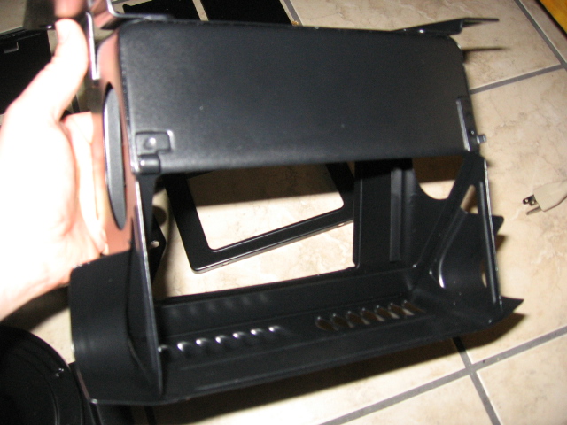

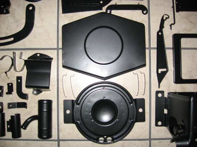

All the parts I had done - 37 pieces - if you're not familiar with these FJ40 parts, the floor tiles are 12x12 to give you perspective on size of parts.

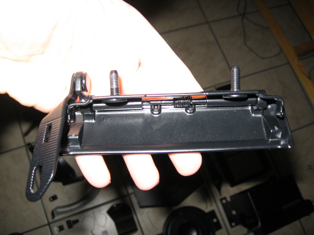

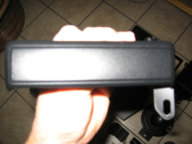

door handles
this is the bottom part of the rear heater.. couldn't get a clear picture unfortunately, but the marked area is where I can still see the metal.
top of the rear heater.. you can see what I mean better in this shot
heater hose cover where inside is not completely coated
this bracket shows where they didn't get it down inside this crevice where the two pieces of metal are joined
this is just an example of the hook marks that are on every part. I just think they could've used a smaller hook and gotten the parts covered better.
Those parts look like ones I've done myself with my Eastwood kit. But I'm no professional and I bake them in an oven in my garage. As Sandee mentioned above, it takes good equipment and technique to get the powder to 'cover' seams. I normally preheat my parts with seams to help the powder stick as I don't have that technique.
I get hanger marks too, but it's normally bolt holes that will be covered by hardware and I touch it up with paint before assembly.
door handles

$212 is cheap for 37 parts. My guy used plugs where there were no threads. However he had a giant bucket of bolts he re used for all of his projects.
I do powder work on the side.... im not a pro but you got a pretty fair price, it looks like he doesnt preheat the parts prior to coating which helps in the corners and what have you. What happens is the part is being sprayed with a charged particle and in a corner it can cause a (excuse the description i cant find the right word) static shield that doesnt allow the powder to settle there, it repels the powder, usually poor ground at that point.
what your guy needs to do is use any threaded hole to hang it from and you wont be left with the hanger marks. if that isnt possible i use really really thin copper wire (solid not strand) through a bolt hole and just hit it with paint to seal it.
if the parts were knocked over while warm it can scratch really really easily just like paint but if they were cooled it may just be a really thin coat of paint, flat is a little less durable as gloss but not a whole lot
