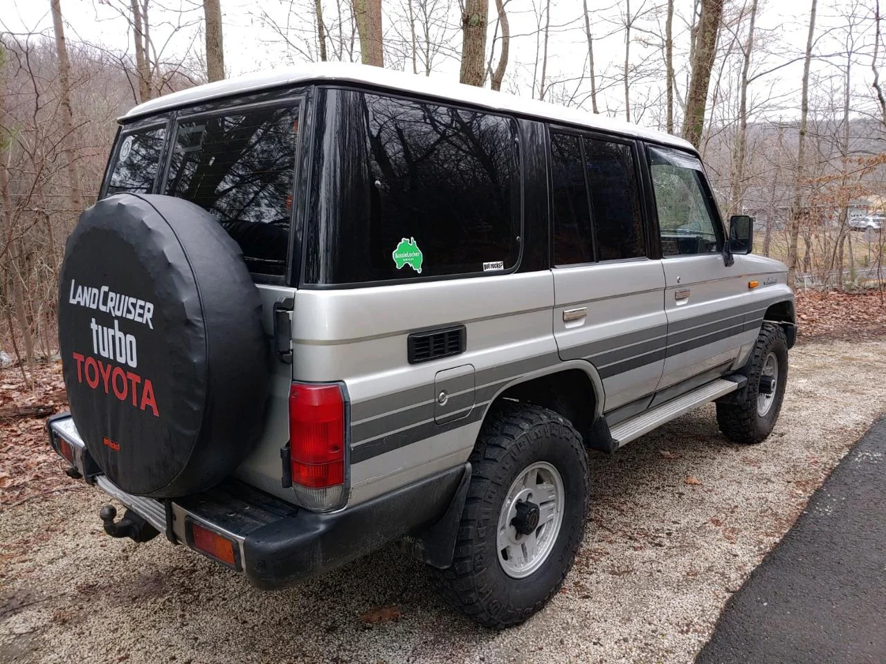

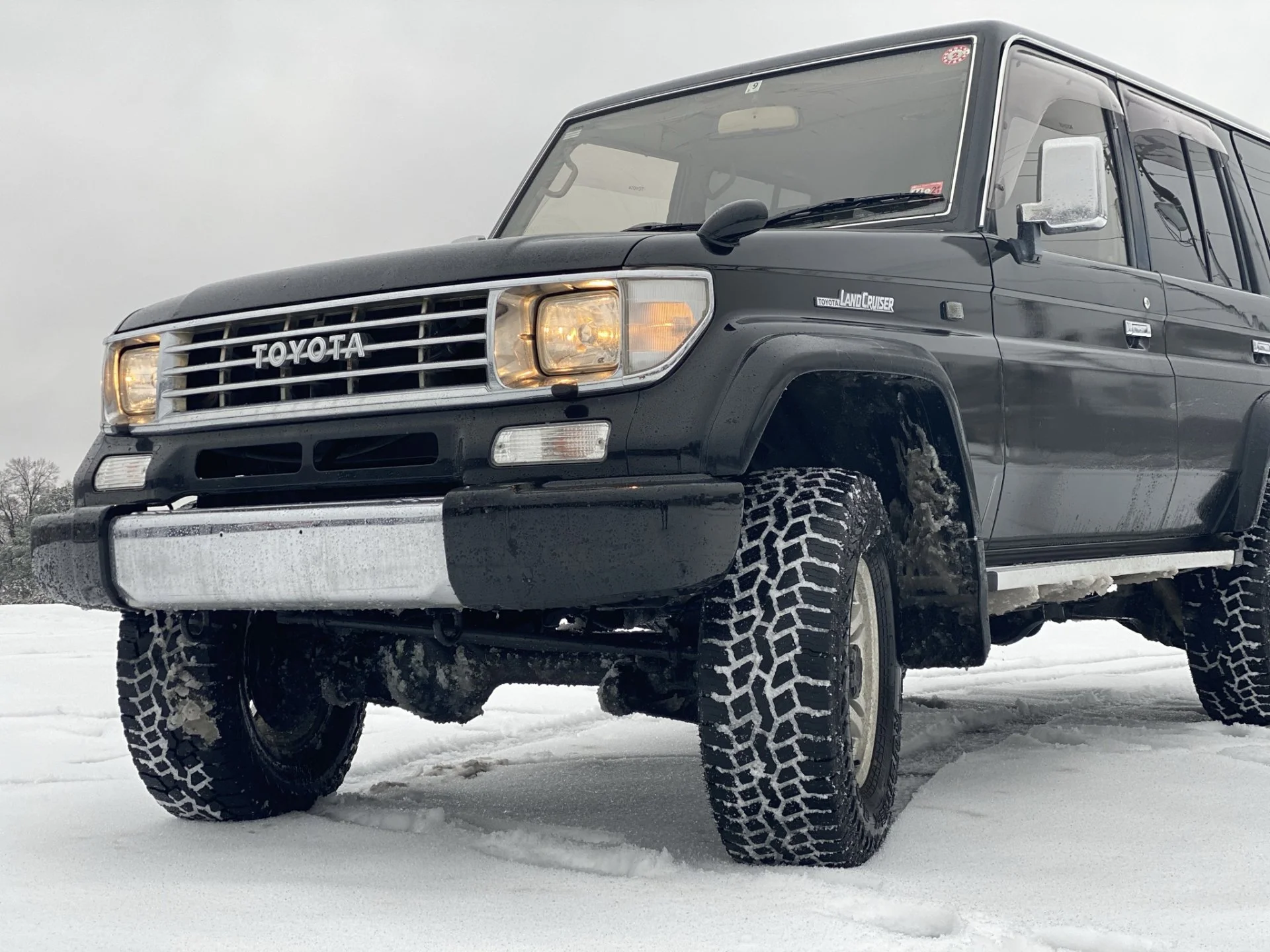

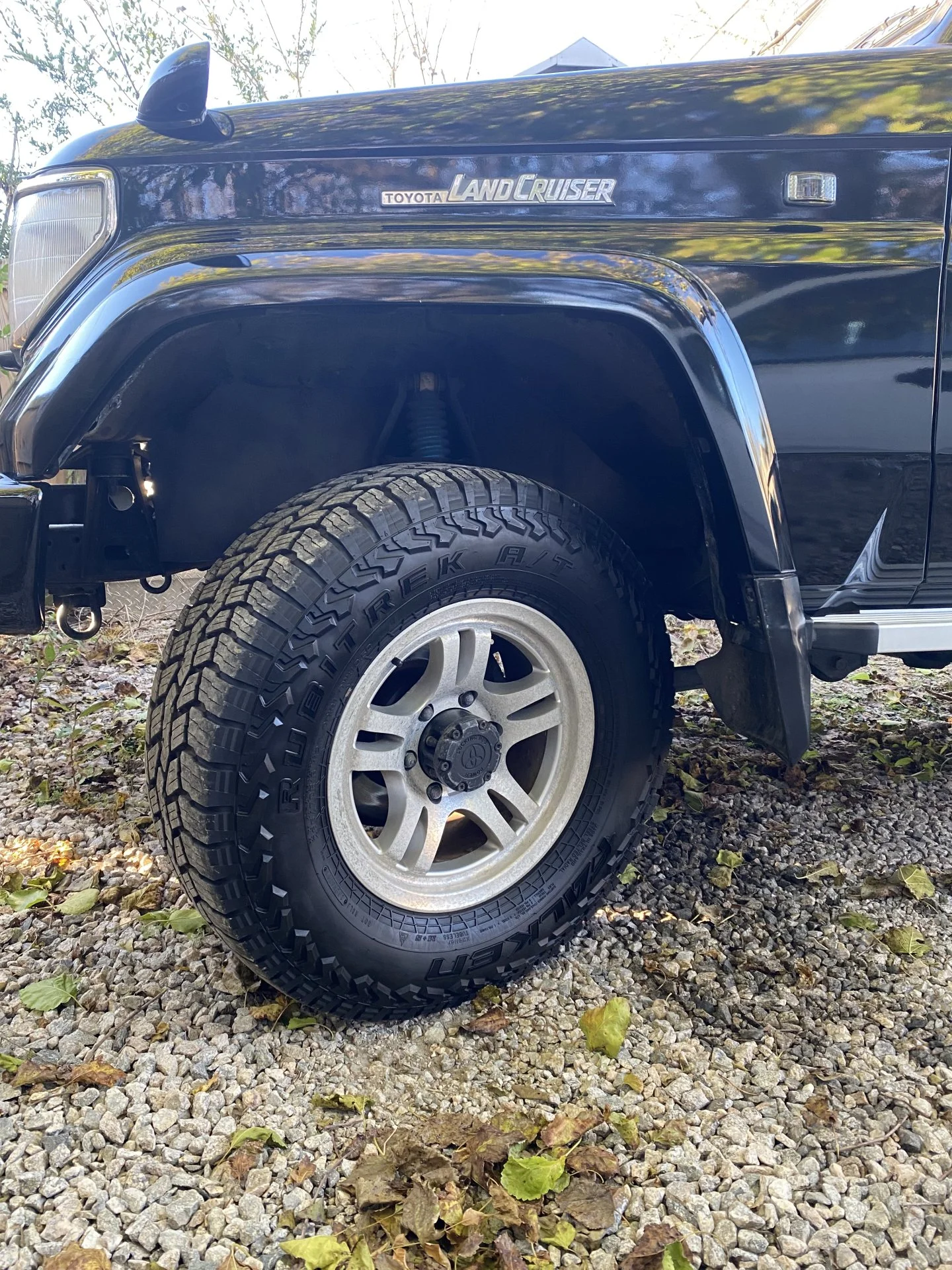

Attached is a picture of my rig. Currently sits on 265 70r16 tires. From what I can tell it’s already with some sort of aftermarket kit because it does sit up a little higher than a fully stock model but I am not really sure, it could just be tire size. I have attached pictures of the wheel area to show there does seem to be some room to stuff larger tires in there but I don’t know if it’s enough to put 33’s like I want.
That's definitely aftermarket - mine had the original TEMS/Tokico shocks that were all black, but the size of the tire is probably effecting the height as well. On your options, I've had the newer 2" Ironman Foamcell kit for a little over a year now and am really happy with them. The ride is night and day over OEM (not surprising) and handles everything from smoothing out rutted backroads at speed to maintaining stiffness and responsiveness on highway and surface street driving.
My impression is that Ironman did not have particularly good product or quality control in the past, so developed a reputation with folks who have had LC's for a while, but that they've changed ownership and practices more recently that seem to have turned things around. I would just keep an eye out for sales as they not-infrequently do 25% off deals. All that said, it sounds like most folks really like their Dobinsons and OME set ups, I just can't compare.
Yep, I just put an Ironman kit on mine and it sits about the same height as yours. 33's will fit. Seems 285 70 17 or similar size is the way to go. I have heard the same thing, Ironman was known as the budget brand in Aus in the past but has come a long way since then. I have purchased 2 sets of foam cell suspension kits from them now among other products and have been very happy with their customer service and products. The Dobinsons kit does come with sway bar extensions for their larger lift. The Ironman kit does not. Dobinsons was almost $1000 more when I compared even with Ironmans foam cell shocks but I did find you can purchase the sway bar extensions seperately on ebay or from Dobinsons direct. IMO, you can't go wrong either way. Hard to say how they compare with each other and hard not to think the technology is similar if not the same on the foam cell with both brands. All that said, looks like you are good to go as is unless something is not right?
