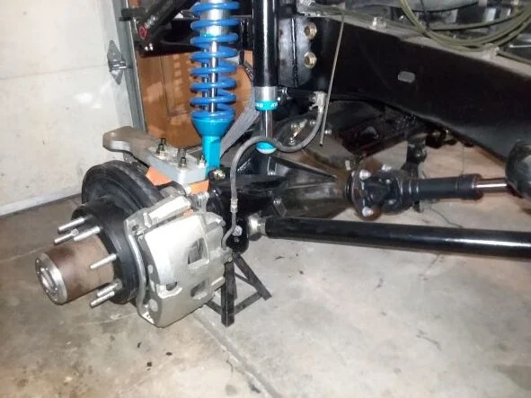

Based on reviews I found and the lack of communication from FR I went with a RoughStuff housing and built what I need to fit my application, set ur caster, pinion angle, link placement, etc., as every build has its on unique variables at aren't allow clear until u have it sitting under ur rig. Prefer the 3rd member drop out over a Dana so one can set gears on the bench. Has Ford Dana 60 outers, larger Dodge brakes, 8 lug. Why would i buy from a company that doesn't have time to answer the phone or emails, when there's an issue they aren't going to suddenly start answering the phone and emails. The people at RS allow answer the phone and help explain things when I had noob questions.Ended up have an issue with my housing and they fixed the issue quickly and on their dime, had to make a new housing and mod the other (have 10.5 front and rear), they paid all the shipping etc.
