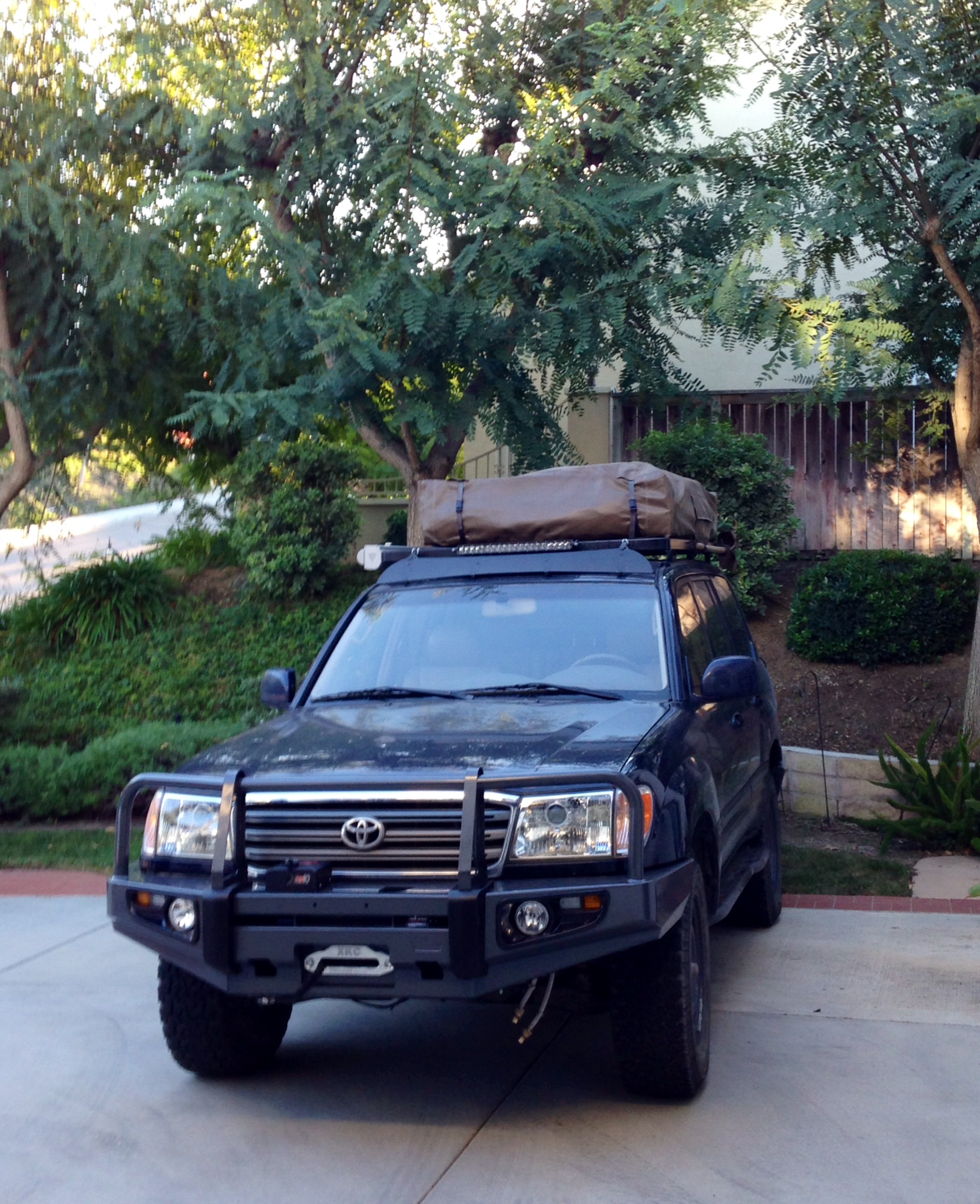

Finished product
Another, this one with one of @2000UZJ 's light bars mounted.

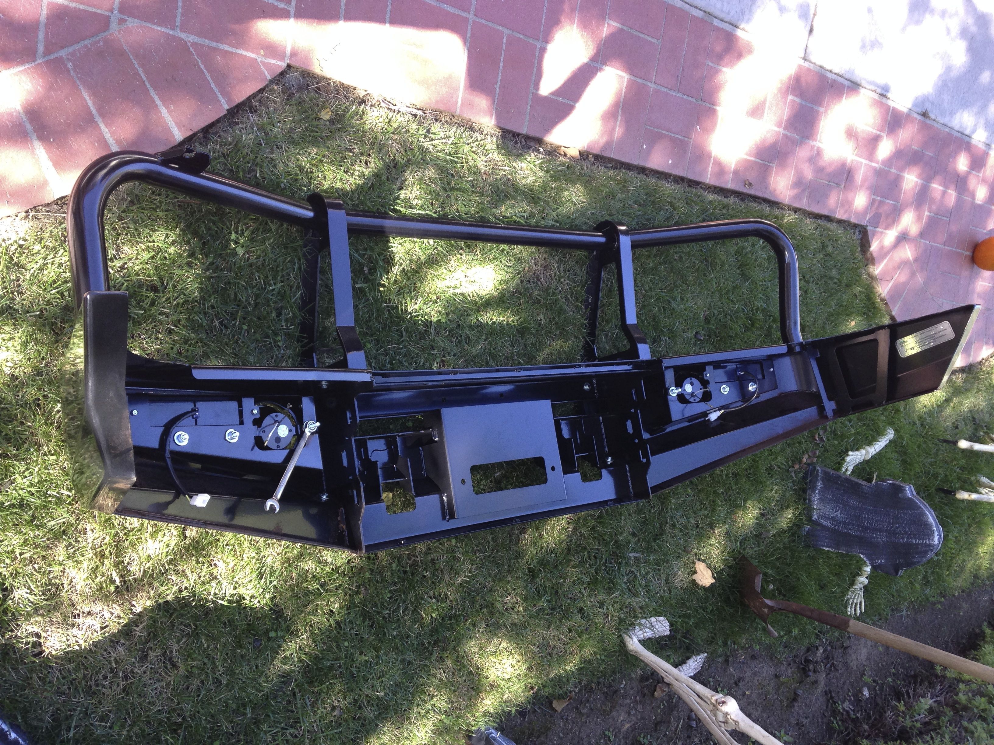

As I received it, powder coated black (before installation, had it powder coated to match my wheels and Slee rear bumper).

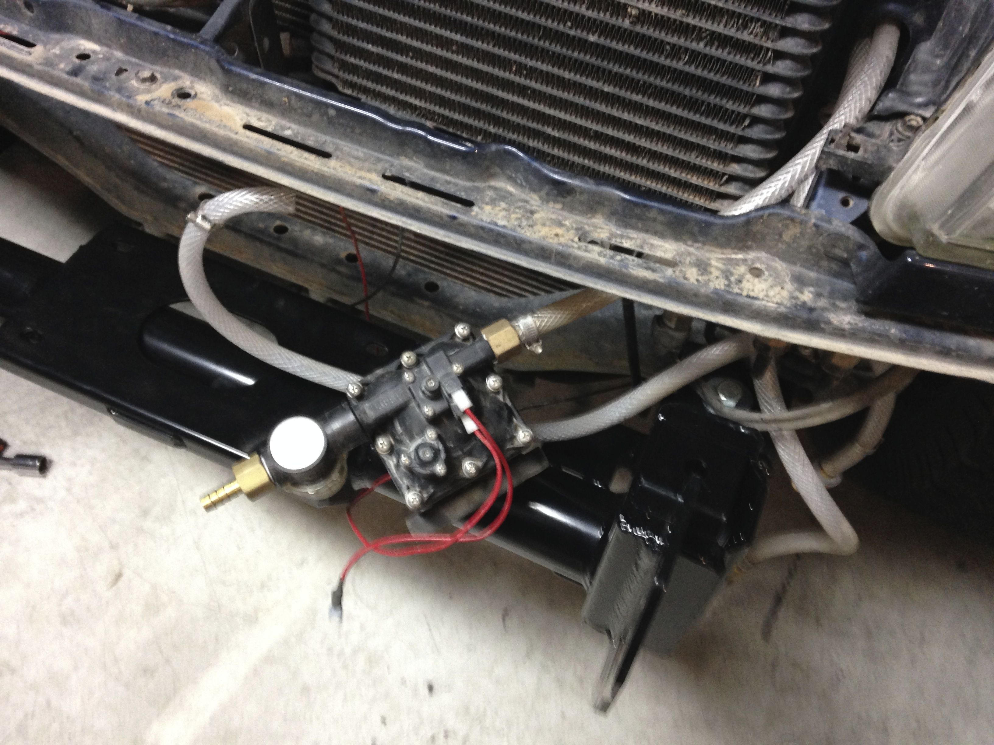

Had to relocate the pump for my Helton shower, but below that in this pic you can see the winch mount, installed over the frame horns.

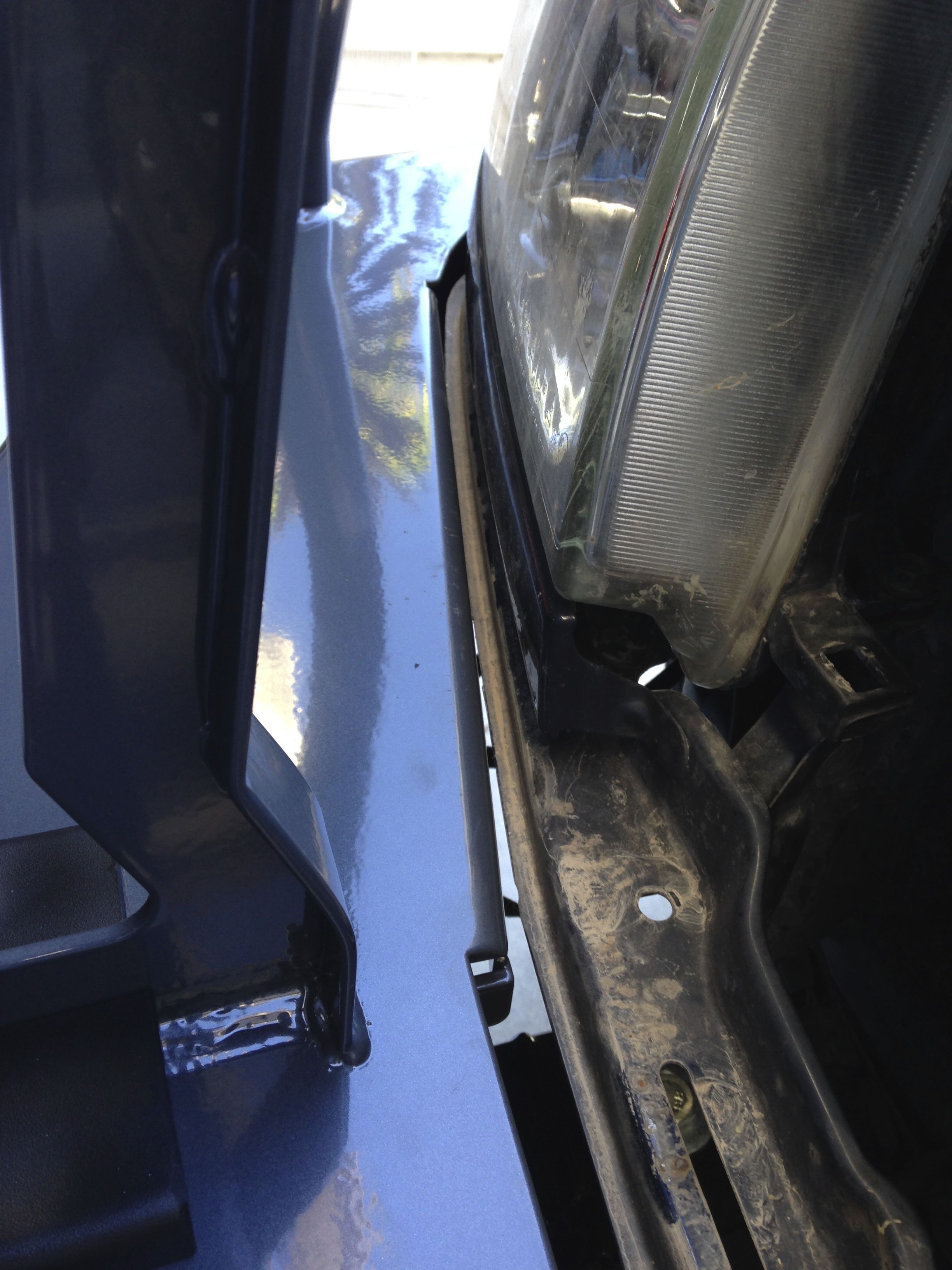

The hardest part of the install was getting the bumper aligned. I ended up bending/rolling back the lip below the headlights (seen here touching the bumper).

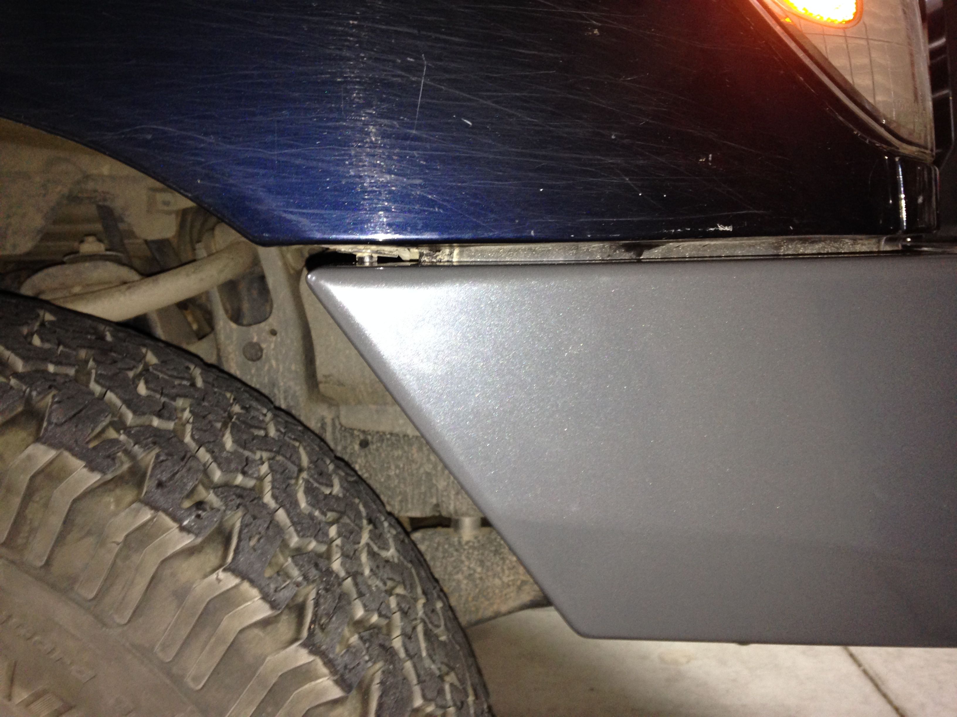

All to get this nice, even gap along the sides.
