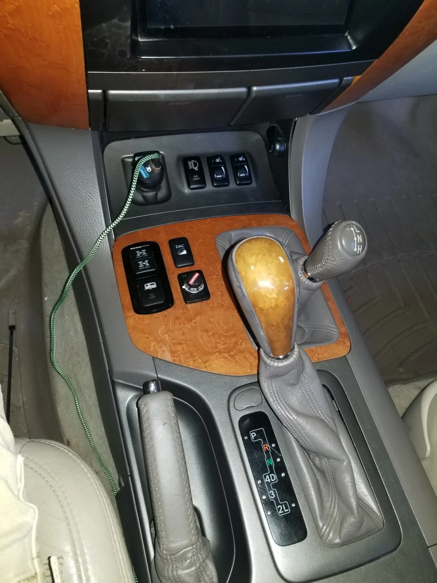

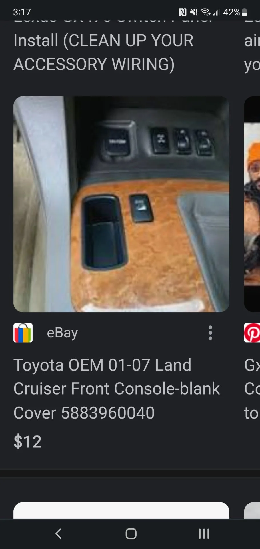

I share your OCD in regards to the switchgear problem, hence the pocket replacement on eBay. This one is LC but I found one for a GX...I'm 99% certain it's the same bit for both.

That pocket looks like it would fit but...dang...that might hold a pack of gum!

I also removed the airbag controls, and replaced them with switches for my torque converter lockup switch and e-lockers (the latter of which are not installed yet :)). I used a $30 eBay bezel that has worked really well. GX's are kind of short on space for switches when you start adding off-road toys; removing the airbag controls allows room for up to 4 switches if you use CH4X4 double-switches.

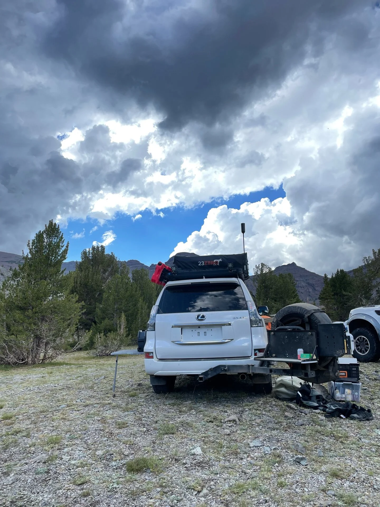

Have a '22 GX Lux, pulled our all the suspension parts including the airbags with ICON's. The ICON 2” lift rear coil springs is sagging the rear when I'm loaded for a trip. Anyone tried fitting either an Airbagman or Airlft in the ICON springs to level the rear? I'm constantly getting highbeamed on the road.
I think the firestone bags that you want a 4108 but perhaps others can chime in on what they used. I know that several people have done this in the 470 but not sure about a 22 460. Its probably the same process and I bet you still need trick the level sensors with washers so that your new lifted height is perceived as the normal height
It's probably easier to either 1) get some higher-rate rear springs (I am surprised you are sagging that much, I load my GX up all the time with cargo and get maybe 1" of sag) or 2) put some helper airbags for a lifted application inside the coils. For the helper airbags you'd just pump them up when you have an actual trip and then deflate them afterwards. I will probably do this mod with my 470 for provide some additional rear stiffness when towing our camper, although I have not found it necessary when carrying a heavy payload of people/cargo inside the GX.
Any difference between the Firestone and Airlift bags? One thing I do miss before removing the rear OEM air suspension is the auto-leveling. Here's a pic of the rear
