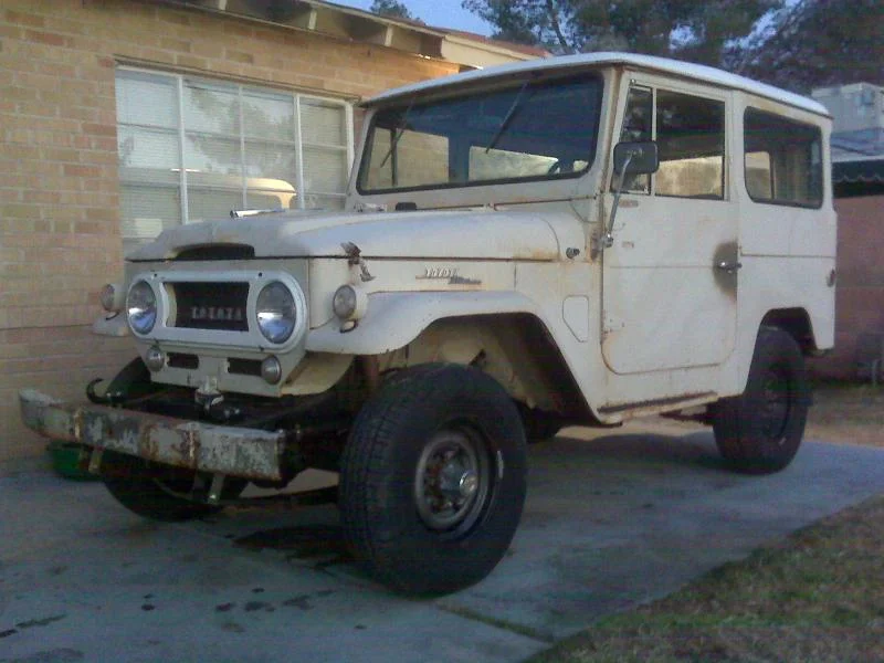

Another pic....
I got the roll bar out of the front door without cutting it. It was a Man-A-Fre bar. I think I found a home for it too. Thanks for the advice. Boy that door lock cylinder was a pain in the bum to put in.......that little wire clip was a task to put in place! :mad:
I spent 4 or 5 hours with cleaner and my pressure washer, taking 40 years of grease off of here and there. I put new greasable shackles, pins, and bushings for the front springs. They are the Aussie parts that are anodized. VERY nice products. The holes in the frame pivot pins were actually not exactly in the right spot and I had to drill them out oversized by just a hair to get the two bolts in per pin. No biggie. I used synthetic grease for the bushings.
I got the 3 speed linkage working with a simple shot of brake cleaner and penetrating lube. I got to drive it for the first time!! Just had to pump the brake pedal real fast every time I wanted to stop, and I stayed in first gear to make sure that I didn't go too fast. I'm lovin it!! Next is the brakes.

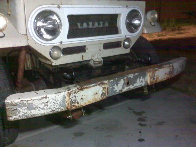

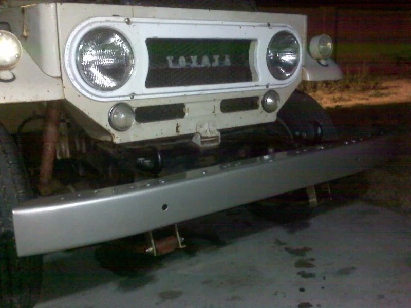

Old bumper ...... new bumper. I know, not exciting, but it looks much better and doesn't have plates welded to the front to cover tow bar holes that were ripped through.

Where did you get the bumper and how much $$$$$
I got it from Specter. Here is the link to the listing and prices, with and without Club membership. I advise to get the membership if you are going to spend over $300.00 or so. The bumper is a Toyota part and is exactly like the original and well painted (powder coated), except there are some additional holes that are not in the original for my '66 nad '67. The "additional" holes must be original for a later model Land Cruiser.

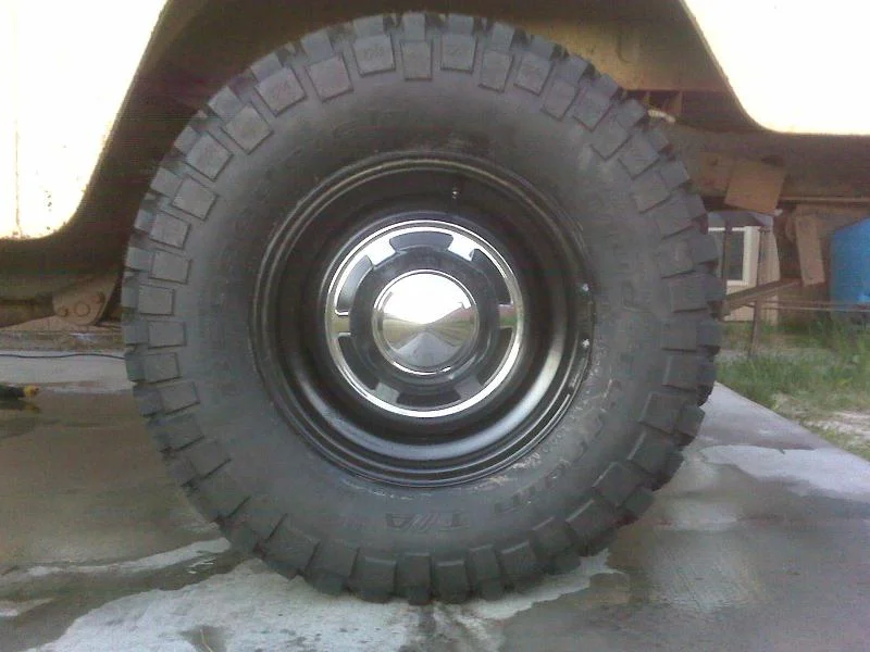

I believe Black rims were correct for 1967 with the "T" moon style hubcaps
I agree that the hubcaps should be the other style to be TRULY correct, but where to get those???? As for the wheel color, it appears that most old pictures have them black, but I have seen some in off-white/cream/grey??? (It is hard to tell in black and white ads) I sure don't prefer black. :meh:

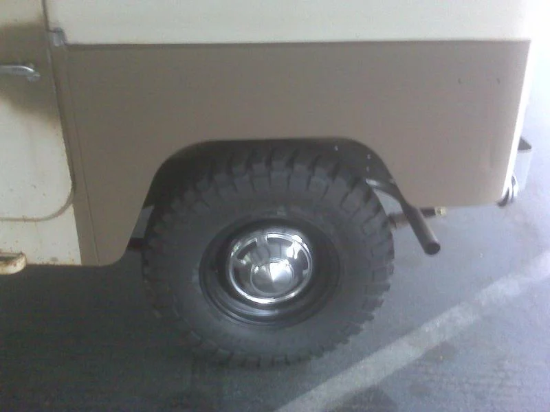

Here are a few pics of the body strip/prime. I have no particular order of attack. :p The very slight dent next to the tail light in the second picture is the ONLY dent/body flaw on the entire truck and is VERY repairable.
