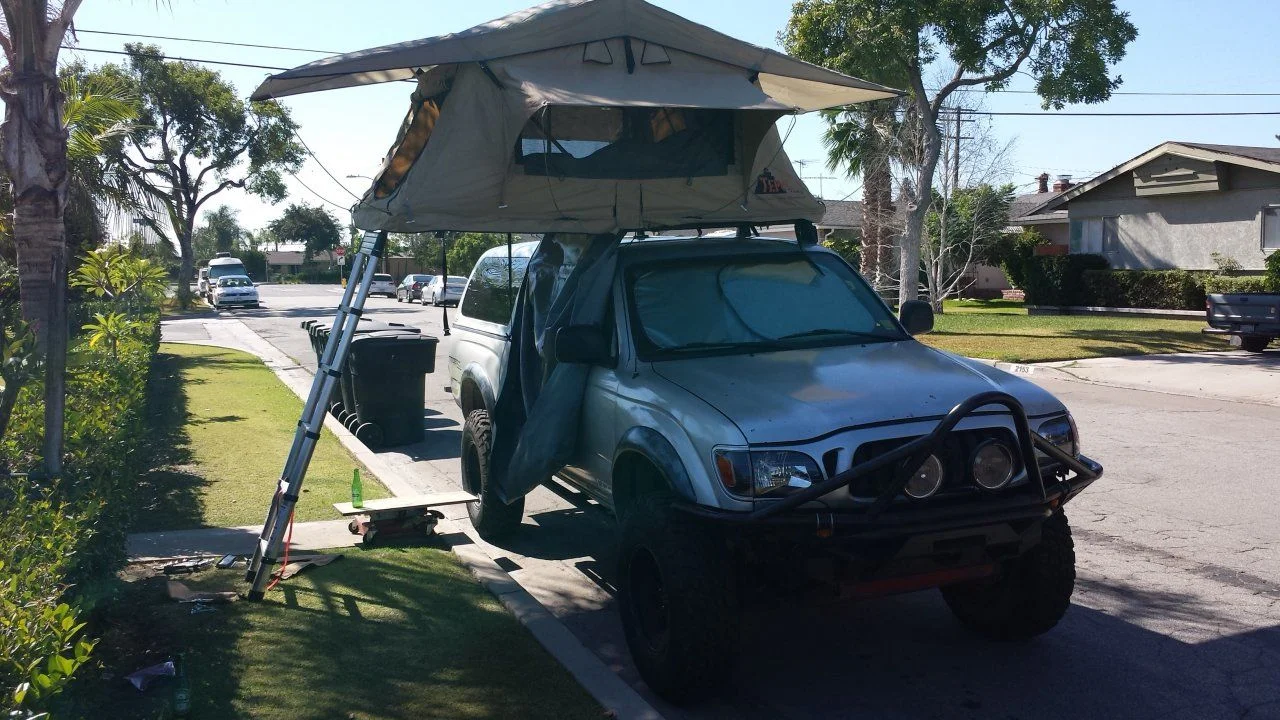

Picked up a used roof top tent from TW. The only damage I have found was the ladder rubbed into the base quite a bit. Contacted Tepui Tents and they gave me some repair ideas. Sheet metal, epoxy and some pop rivets. Here is a picture of me doing an inspection of seems as I air it out.
Also picked up a Yakima Q-Tower System as a cheap temporary mount for the RTT.

I would like to mount the RTT on the camper shell or remove it and get an Allpro pack rack. Anyone have any input?
Personally I like to have my shell just because sometimes I like to have the security to keep stuff in the back.
Nice find on the RTT, I have been drooling over those for years. Maybe the next group buy...

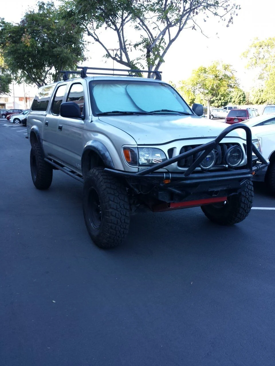

Got the thing mounted. Not liking it over the cab but it'll do till I get a camper shell rack. Don't really notice it up there.
Looks good.
